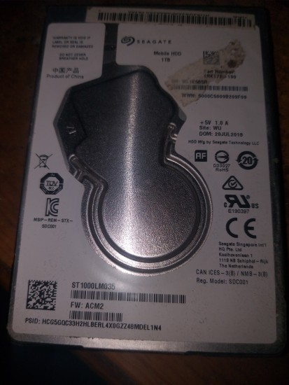

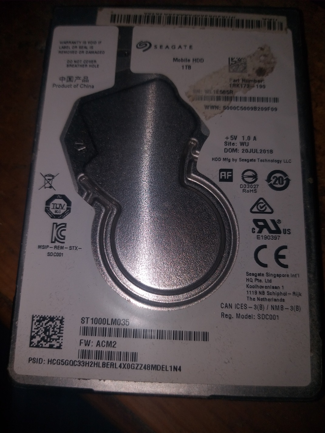

Yes, but to be sure, you can post photos of the disk from both sides.

Lukas wrote:
Dffg wrote:
are you sure romswap work on this model

You can swap ROM.
