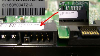

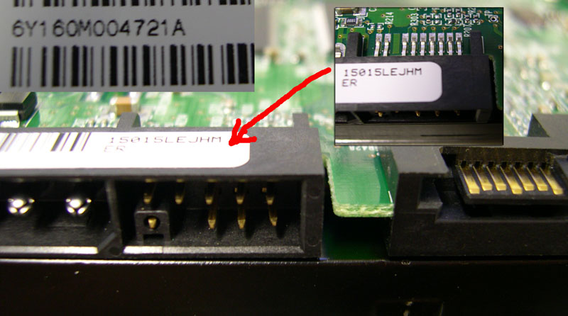

 Post subject: Re: Safe mode
PostPosted: August 7th, 2007, 23:37
Joined: October 1st, 2006, 6:29
Posts: 107
Starling, the safe mode does not work with Diamondmax plus 9 SATA model 6Y160M004721A
PostPosted: August 8th, 2007, 9:32
Yes it does ;-)
I just tried it :-)
BTW, I made a mistake. The 5v to pin solution is for Sabre SATA, not Calypso. The one Starling states correctly is for Calypso.
