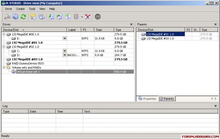

Hai to all, need some help to solve this problem.
I just receive 4 harddisk IDE 300GB installed inside HP server.
harddisk 1+3 (raid 0), harddisk 2+4 (raid 1).
the problem is when they change the Windows system (before is windows server 2000) to windows server 2003, all the data (in raid 1) gone.
Harddisk detected in BIOS but the file systems is "Dynamic Disk" and cannot be access in anywhere.
I already try to retrieve the data inside using many software data recovery. like media tools, easy recovery, test disk, etc. but none success.
any solution ???

I think U will have to manually analize the structure of the arrays to choose the right method of recovery. I'm afraid it is not about magic programs, though they are helpful of course if U know which one to use in a given situation and how.
U have to check the RAID structure, probably U will have to make a complete image by deinterleaving the RAID and create a continuous image. Then U can think about what program to use for filesystem recovery, if one is not working correctly, check the cause and eliminate it...

 Post subject:
PostPosted: September 8th, 2006, 1:17
Joined: July 27th, 2005, 3:35
Posts: 92
hallo baha cevik, thanks for the info. :)
I already try using r-studio again, but still can get a correct data out from the harddisk
here is the picture :
note : I'm using virtual stripe set (because the harddisk is raid 0 and making into one huge volume (2x300gb = 600GB)

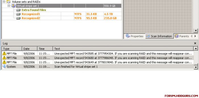

note: after finished scanning, its show some recognized fragment files. What is Unexpected MFT record 543649.. bla..bla.. things ????

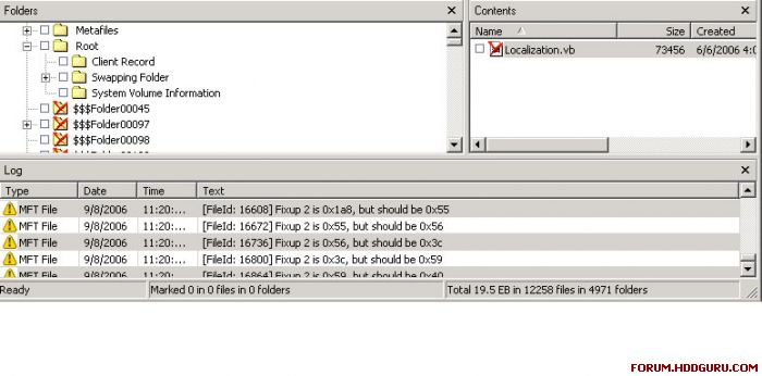

note: after try to explore the founded recognized.. it show (below) "fixup 2 is 0x1a8, but should be 0x55" .. ??
I already try to read the manual.. but none is show about error message.

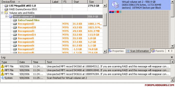

note : I'm using virtual volume set, it recover a lot of files. but it show that the file should be (like : 12000bytes) but only recovery (6000bytes). I suggest this is because of the striping method using.
so any suggestion ?? how to merge the file together so can be access ??
or maybe anyone show me how to using in r-studio correctly ?

 Post subject:
PostPosted: September 8th, 2006, 1:35
Joined: November 1st, 2005, 10:04
Posts: 238
check properties (next to parents) for stripe size.
Check drives in hex viewer to see if you can manually
confirm start and stripe size - then probably it's in the bag.
I suspect partition table is shot, but don't worry about this.
success!
btw. seems like you running this R-stud from the client computer.
In this case you probably OK, but avoid this in future.
Use your own OS and clones of raid - much safer.
Did they not mirror the "Backup" Volume on drives 0 and 2 ?

but, need to know.. which method should I choose.. Virtual Volume set ot Virtual Stripe set ??? because this to method generate diffence output files..
