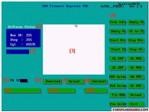

PostPosted: February 13th, 2007, 8:12
Joined: February 3rd, 2007, 7:47
Posts: 20
Heres the pic from the manual that im going by. Cant see [scan_mode].
 Post subject:
PostPosted: February 14th, 2007, 14:36
Posts: 20
I was going to try running [Fix mod] but im a little worried. In the manual it says to fix the HD if you DONT care about the data to use [fix mod]. But then later on in other procedures that DO keep your data it tells you to use [fix mod].
So can anyone clarify if using [fix mod] wipes the data?
Also while im here what about when emptying the G-list or moving it to P-list?
Just incase I try that.
 Post subject:
PostPosted: February 14th, 2007, 14:43
Posts: 410
Location: Romania
If you want the data do not touch the G-list
