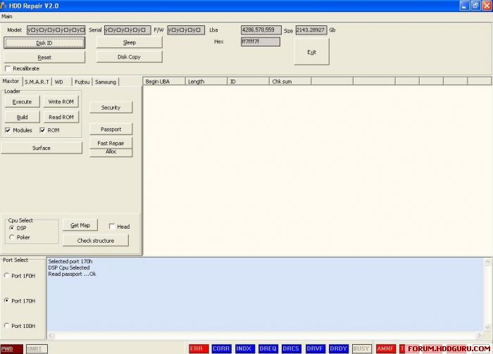

 Post subject: Maxtor DiamondMax Plus 9
PostPosted: February 9th, 2007, 10:16
Joined: January 11th, 2007, 13:11
Posts: 32
Maxtor DiamondMax Plus 9 Calypso
6Y080L0422611
YAR41BW0
N,M,B,A
M6FYA
Any ideea?

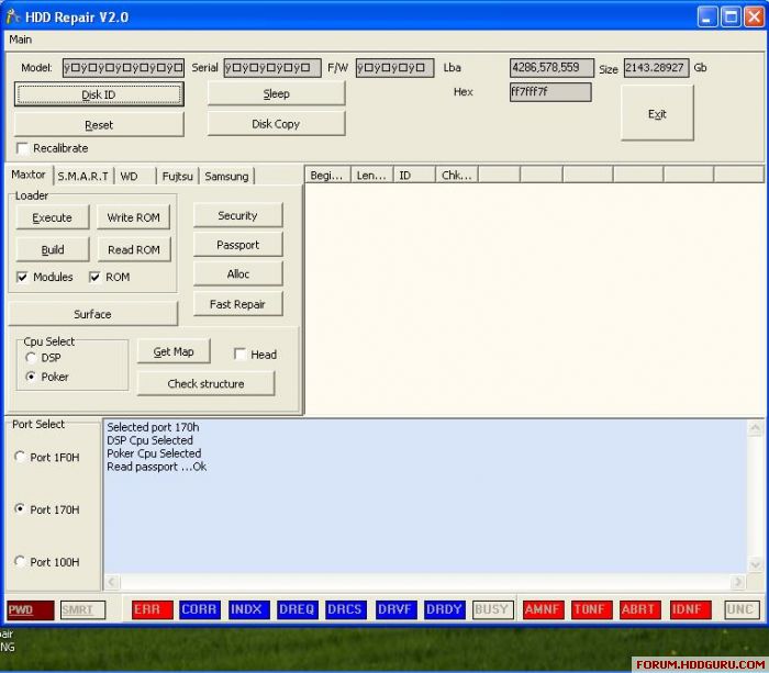

 Post subject:
PostPosted: February 12th, 2007, 12:44
Posts: 32
OK. Poker selected. The same thing I think!
So, once again...any ideea?
Image[/img]
 Post subject:
PostPosted: February 12th, 2007, 17:42
Posts: 4817
Apparently there is no working drive connected to port 170, or the prog cannot access that port (all the status and error bits are ON)
U have to reach a state where DRDY and DRCS are on and all the others OFF.
 Post subject:
PostPosted: February 13th, 2007, 2:34
Posts: 411
Location: Romania
Hi
Yes , i agree with pepe, looks like there is no drive at that port. To check if the program is working, u can select port 1F0 and see if the problem remains or not (the DRDY and DRCS lights must be on, the rest of lights must be off).
Or probably it is a Win XP problem and u should use a little program Userport to gain access to that ports. You can find that program at http://files.hddguru.com.
Rgds
 Post subject:
PostPosted: February 13th, 2007, 13:48
Posts: 32
I think I made an wrong problem exposure.
"HDD Repair 2.0" is woking. ( At least I think so, I did not repaired any hdd but I've conected working hdd on it and the ID was OK.)
My problem is with the hard disk. This is not working and the print screen is what "HDD Repair 2.0" show when I push "Disk ID"
I was asking for some help regarding what shoud I do with this hard disk.
Or maybee I am so newbee that I can not see that the software is not working as it shoud be.
I am realy in the mist here.
 Post subject:
PostPosted: February 13th, 2007, 19:18
Posts: 4817
Hi
U can only work with drives becoming ready. But from the picture I can only see that either the port is not working (see ccc-s post, but if U say U worked with drives successfully, I think this is not the case), or the drive is completely dead, or set to slave.

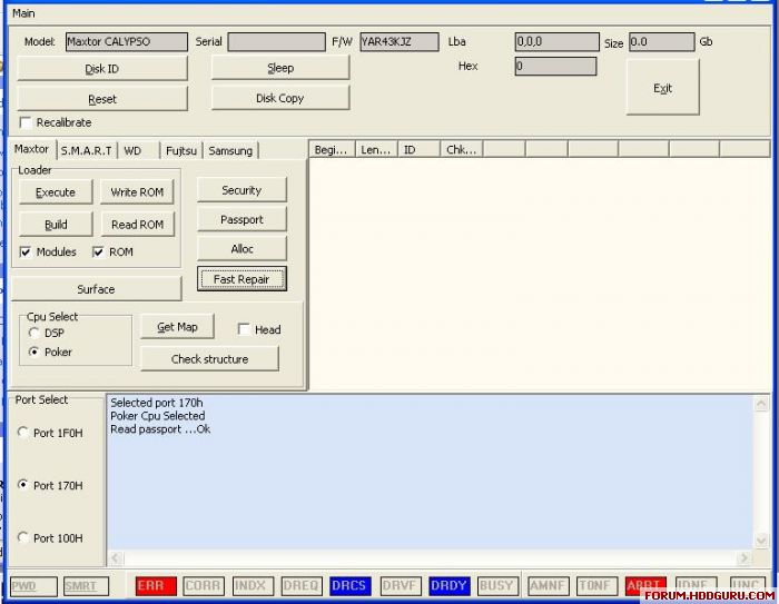

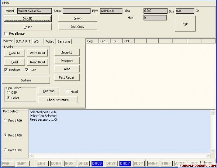

 Post subject:
PostPosted: February 15th, 2007, 12:57
Posts: 32
OK. Now hdd is master, it identify it OK, it become ready.
If I touch any of the butons , this is what I get :
So what shoud I do next?
 Post subject:
PostPosted: February 16th, 2007, 3:49
Posts: 2288
Location: In ur HDD !
U should put the hdd in Safe mode jumper configuration then load the appropriate LDR from the EXECUTE button under the loader option then if command successfull press Check structure button then .
 Post subject:
PostPosted: February 16th, 2007, 7:41
Posts: 32
Can anybody please give me the "Safe Mode" jumper configuration for Maxtor?
 Post subject:
PostPosted: February 16th, 2007, 11:04
Joined: February 3rd, 2007, 7:47
Posts: 20
For my Diamondmax 8 POKER safe mode is ['_:::] (pretend there is 2 dots above the _ ).
I see elsewhere that safe mode for a Diamondmax9 60gb Calypso SHOULD be [II:.:]
I cant find one for yours exactly. Maybe try the one I use. I also read it could be for ALL POKER drives.
Again. I cant be certain if these are right (except for the one I use). Its just what ive read on forums.
