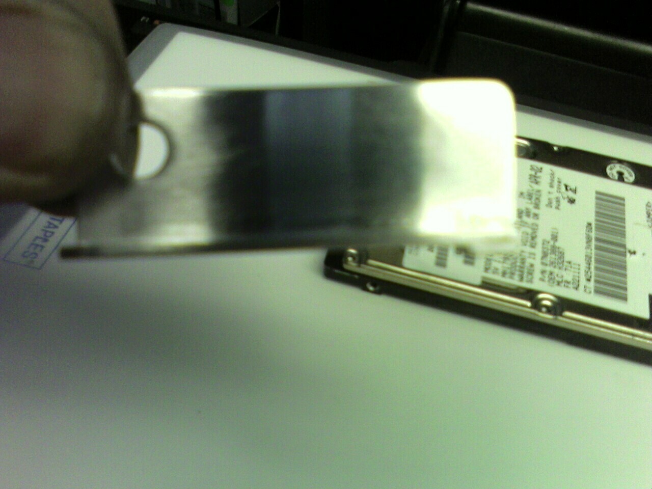

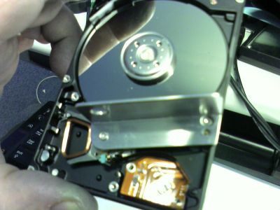

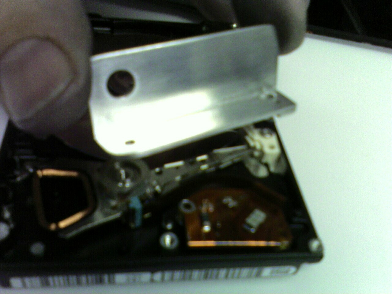

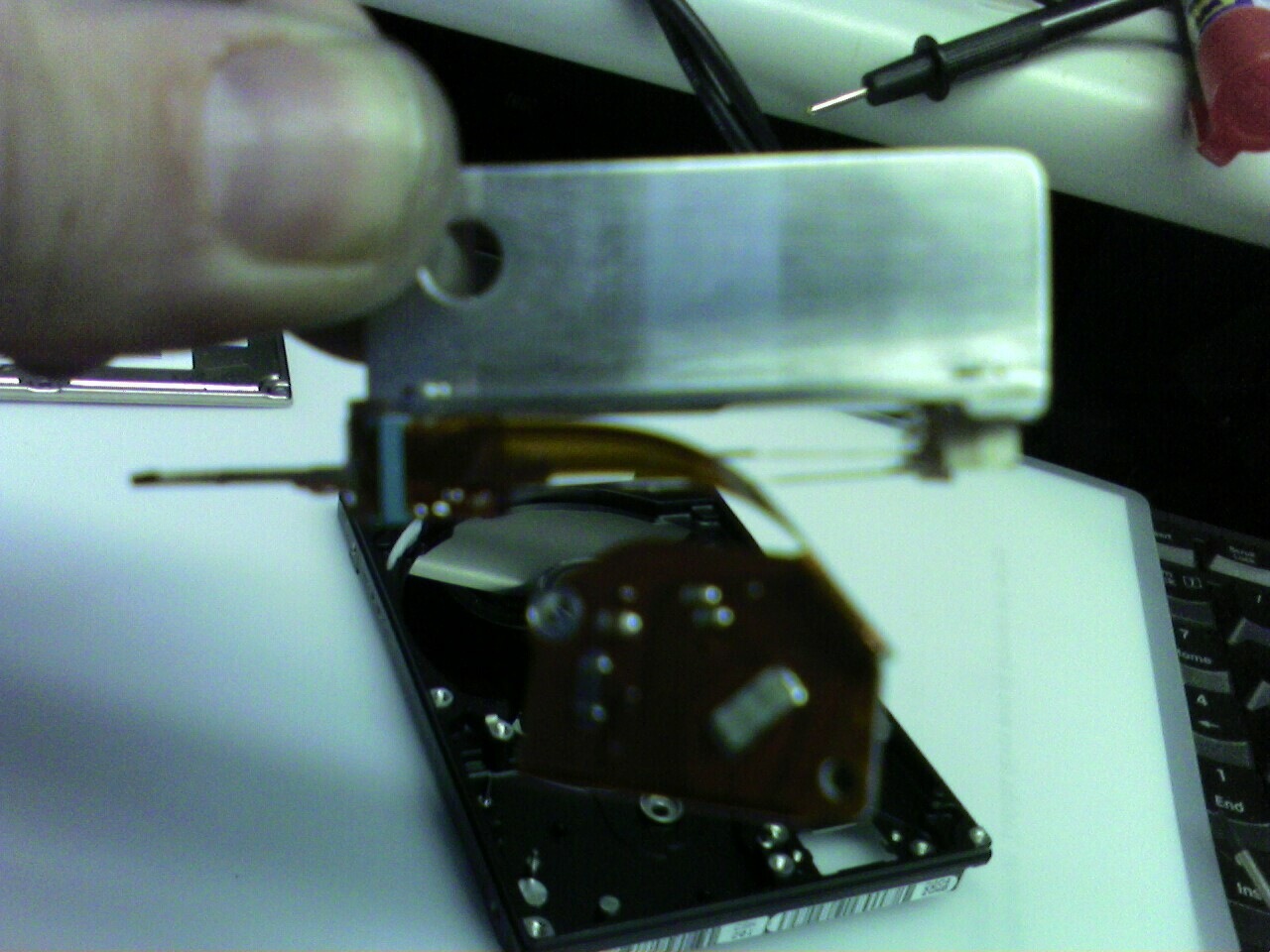

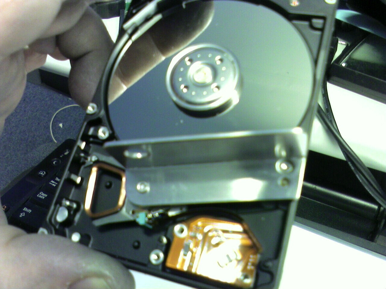

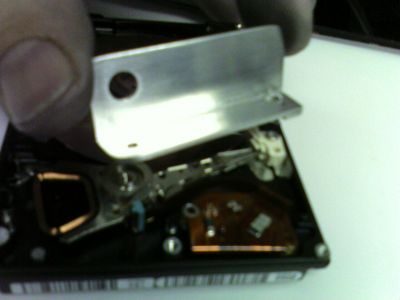

Well, if anyone's interested, here's my Ramp fixture. All it took was:
Some angle aluminum stock
Drill Press
Files
Sand Paper
Propane Torch
Aluminum 'Welding' rod
6 hours of fitting and filing (I'm a perfectionist)

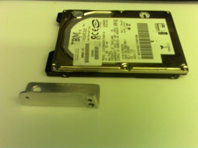

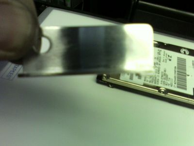

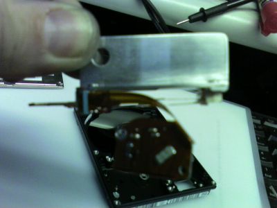

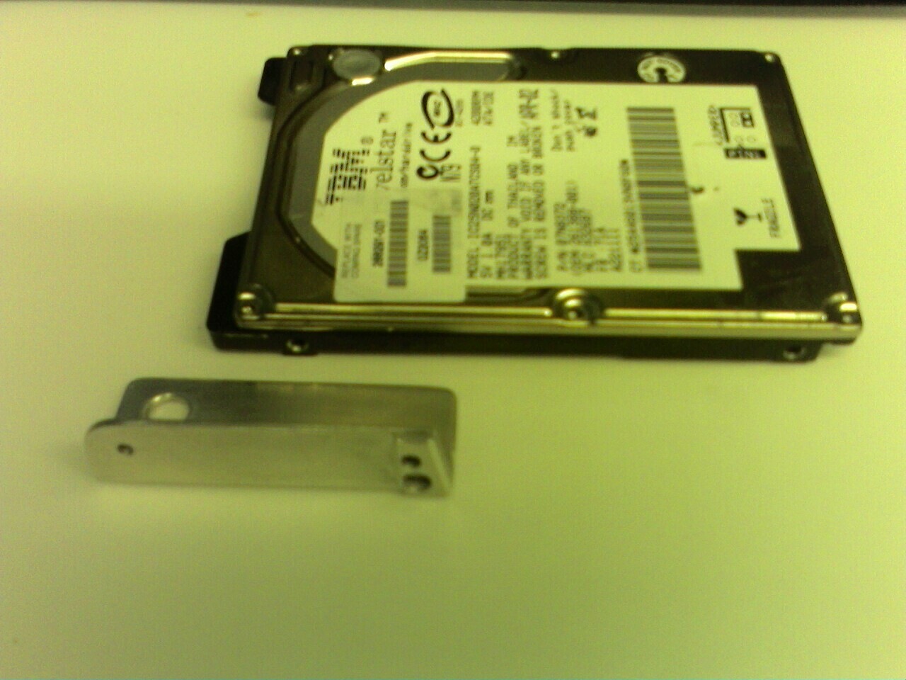

Here's two more pics. Sorry they are blurry, it's my crappy cellphone. Can't focus up close.
I have to admit, I used to be a 'Keep Everything Secret' kind of guy when it came to data recovery. In the scheme of things, helping each other only helps. People in the DR business won't close up shop because you didn't share with them. The average Joe isn't going to do a Head Stack Replacement because they found some info on the Internet. Even if I don't get paid for it, I hope some Grandmother somewhere gets the pictures of her grandkids recovered. I'm thankful that people here share as much as they do.
