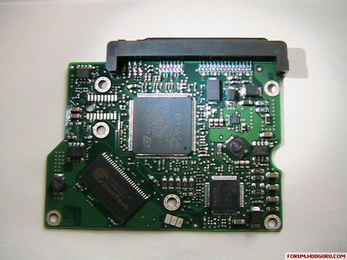

Hey, I'm pretty much a noob at circutry and the like, but i'll describe to be best of my knowledge and hope someone can help.
I tried to plug my seagate 80gig barracuda into a 4 pin power connecter while the computer was running (dumb, I know) and was met with a spark and I'm guessing a short as the psu will not turn on unless the hdd is not in the circuit. after some research, I deduced that the problem was probably a blown protection diode and I need to remove it. But, my warrenty is void if I rip it apart so I need to know for sure that I can fix this thing before I do so.
Any tips would be greatly appreciated, thanx.
Andy

A model number (ST380xxxA) and a FW rev. would be helpful, also a picture of the PCB :)

The screws are star-shaped...I might need to get a special screw driver to take it apart... the model is st280811as
http://one.fsphost.com/nixx/IMG_0244.psd

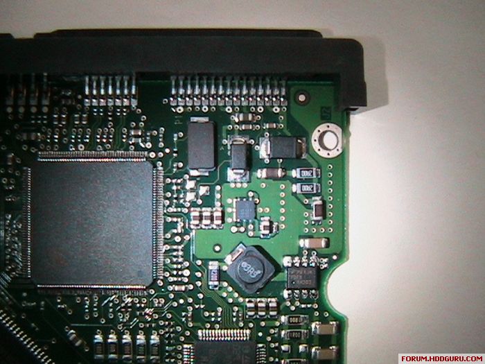

Ok, so I got the donor, a torx-8, made the swich, and turned it on. success...up to the point where POST tries to read the drive itself.
It froze up unless I had the drive disconnected. any ideas?
and this is the internal side of the frankenstein pcb...where is the diode I want to remove?

PostPosted: May 24th, 2007, 12:38
Joined: May 9th, 2007, 17:26
Posts: 9
Ok, I got a PM with the location of the bad diode and I removed it...worked lika a charm, so thank you all for the support, you make my life much easier (and cheaper!)
for those who are watching with the same problem, carefully remove the piece circled in red, there will be some sticky stuff under it, make sure to wipe that of, but be careful not to scratch the board.
