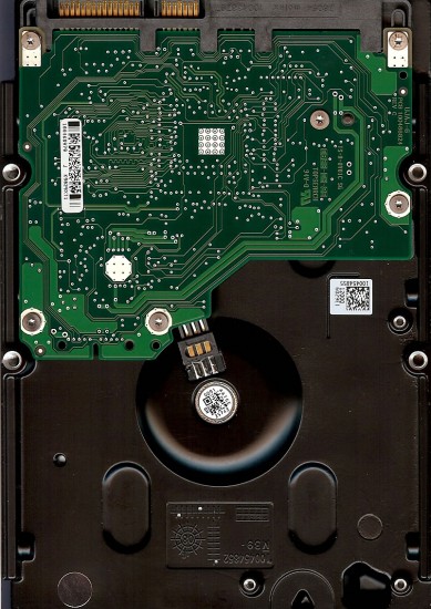

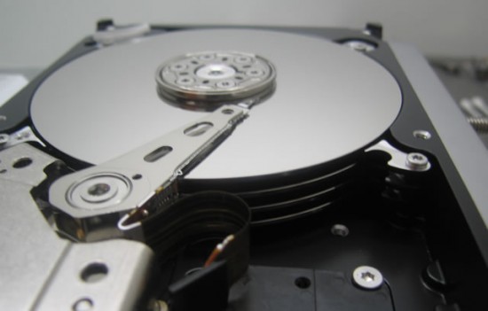

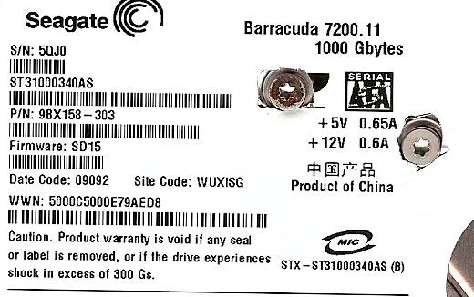

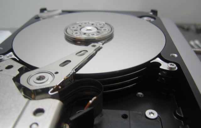

Hi to all,
here is the photo,
The heads can move the the splinde dont move.
ZeBong
" Россия еще раз"
 Post subject: Re: Seagate 1TB - motor dont move
PostPosted: March 2nd, 2009, 9:36
Posts: 1517
Location: Mexico
U have a little hope the heads are on land zone thats good , and maybe its possible to "free" the spindle without platter exchange
PostPosted: March 20th, 2009, 18:53
Joined: February 11th, 2009, 13:29
Posts: 40
I have this exact same problem in my office right now. I have managed to release the stuck spindle (Very carefully.) but the drive still gives me the same symptoms.
According to current monitor there is a spike to ~900ma max for ~1 second then it will drop to 0, and a second later will attempt again.
I have a identical PCB on hand, and it give me the same results, also putting the PCB from this drive to a known good drive the drive will spin up fine (not identify of course, but spin up)
I am guessing that the circuit on the spindle itself is likely damage, I am here for any input I can receive.
It looks as if a platter transplant maybe in order for this drive.....sigh
