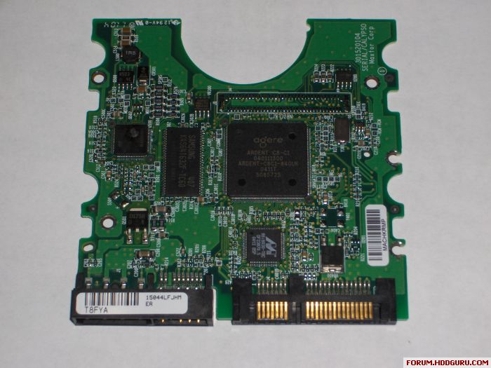

A few months ago when i turned my computer on my power supply shorted out and killed my hdd along with it. I noticed when i took the hdd out that one of the chip on the controller board was burnt. Would my data still be ok? The HDD doesn't power on or do anything. Could i just find the proper the controller board with the right firmware and replace the burnt out one and retrieve my data? Thanks!

Here is a pic of the controller board.. You can clearly see the the one chip has melted or something.. linkImage

Looks like the motor driver IC is toast.
On the replacement board: you'll need to determine which of the 8 pin ICs on the bad board is the ROM (Google the part number) and transplant it to your donor PCB. It contains adaptive information.
Drives are cheap. It is not wise to depend upon a repaired drive for important data.

In the "old days" often you could swap a good board for a bad one and expect to recover your data.
Modern drives are fine-tuned at the factory. Each drive has different parameters, e.g. defect maps, head maps (e.g some drives have heads that are not used although they are physically present), etc. This is called ADAPTIVE DATA.
Maxtor stores some of this adaptive data in a tiny serial ROM IC on the board. When you take a board from a donor drive, it will have it's own adaptive data which will likely not be entirely compatible with your drive. This will result in clicking, etc. and other start-up problems.
The solution, when swapping boards, is to desolder the ROM from your bad board and solder it onto the replacement (donor) PCB. This is best done with the correct tools and experience . . . .

Good news! I bought a PCB from ebay for my drive and it worked perfectly! I've been able to get all my data back! Thanks for everyones help
