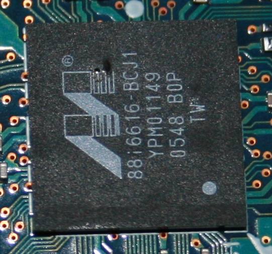

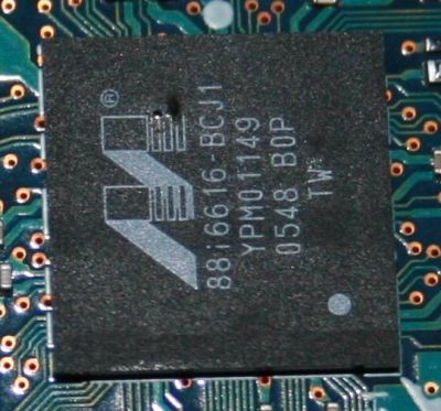

I have a Toshiba MK6032GSX SATA 2.5" drive that it's FUSE and CPU
are burnt out(Its visible on the chip).
I am aware of the fact that Toshiba drives keeps some critical information
like adaptive data inside the ROM. So swapping PCB or perhaps changing
the burnt CPU won't help to access the data
(I suppose that ROM is inside the burnt CPU chip).
Do you think there is a solution to recover data from this drive.
I appriciate any comment in this regard.
Thank you

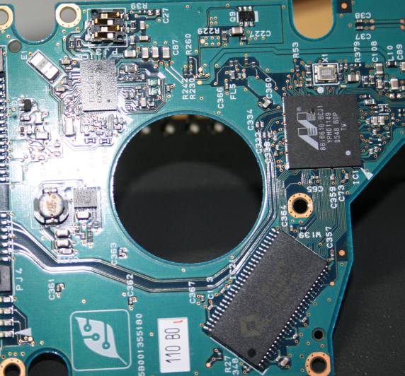

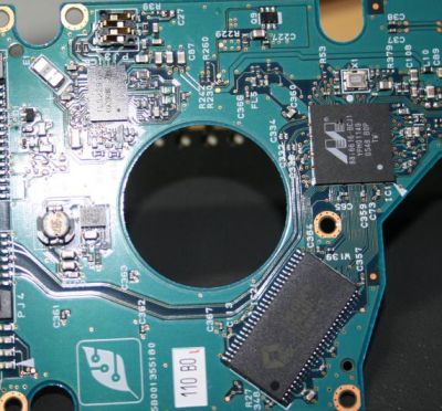

Hi Starling,
Thank you for the reply. I think there is no external ROM on the PCB.
Please have a look at the PCB image and correct me if I am wrong.
Again, thanks for the advise.

PCImage:
on some models (some GAS and GAX models) there is an external flash memory storing the FW, so it could have been true for this one.
Pninja:
Too bad it is not true in your case. U may try swapping the PCB and see if it is possible to read some sectors from the drive (probably not). If yes, then U will have to deal with the shifting points caused by the different translator...
It worked for me once but that was an old model (MAP).
regards,

pepe:
I swapped the PCB in the first place. It started endless clicking :( .

AFAIK, the only way forward is so transfer the "ARM" chip containing the ROM info, onto a compatible PCB.
AFAIK,
As I said, the ARM chip(Processor) is fired.There is nothing left there to transfer.
