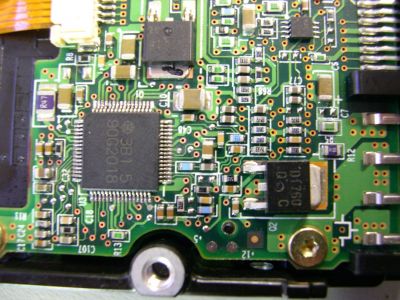

hi gurus!
i have IBM deskstar DTLA-305040 with burnt motor controller, i replaced it and still not powering up, maybe other components? please help me ....
The 90G2018 motor controller shown on photo has been replaced.

in your photo i also see a mosfet/regulator with a hole ?
 Post subject: Re: IBM deskstar DTLA-305040 burnt motor controller
PostPosted: October 2nd, 2007, 21:35
Posts: 1241
Location: inside ROM
Rameez, the drive clicks after i swapped NVRAM and ROM to donor identical pcb.
Amarbir the hole is the manufacturing hole, its is tested working. I still could not figure out why the drive will not power up, i have identical pcb board, i swapped the NVRAM and ROM and still would not work. ummmm headache.... :(

Today before i do head exchange the drive starts up but the motor controller chip gets really hot, i mean untouchable.

Tried replacing 90G2018 today same results.
Is read channel exchangeable? I suspect the read channel chip is blown cause all major parts warm except the read channel chip dead cold. :roll:

Posts: 4840
just replace the MHA, put the prepared donor PCB on the drive afterwards, it should work...
