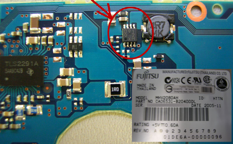

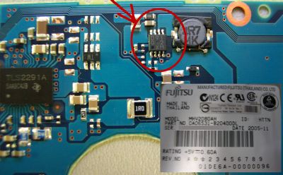

Is this flash ROM?
 Post subject: Re: Fujitsu MHV2080AH burnt processor any chance?
PostPosted: September 4th, 2007, 0:06
Joined: October 1st, 2006, 6:29
Posts: 107
No, thats a diode. If the processor failed i am afraid it's gone, firmware on MHV cannot be matched just from the label itself. sometimes it does not work.
