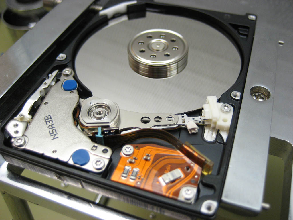

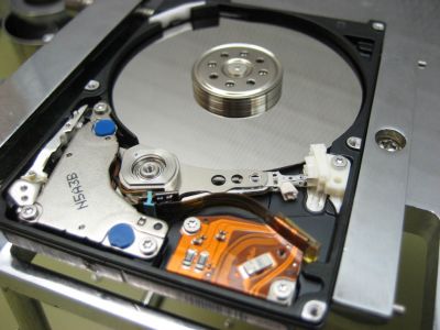

Hi there,
If you knows that your heads are gone, then the proceedure is the same as for the Hitachi 2.5"....this drive has a ramp aswell.
Straws or folded paper workes good.

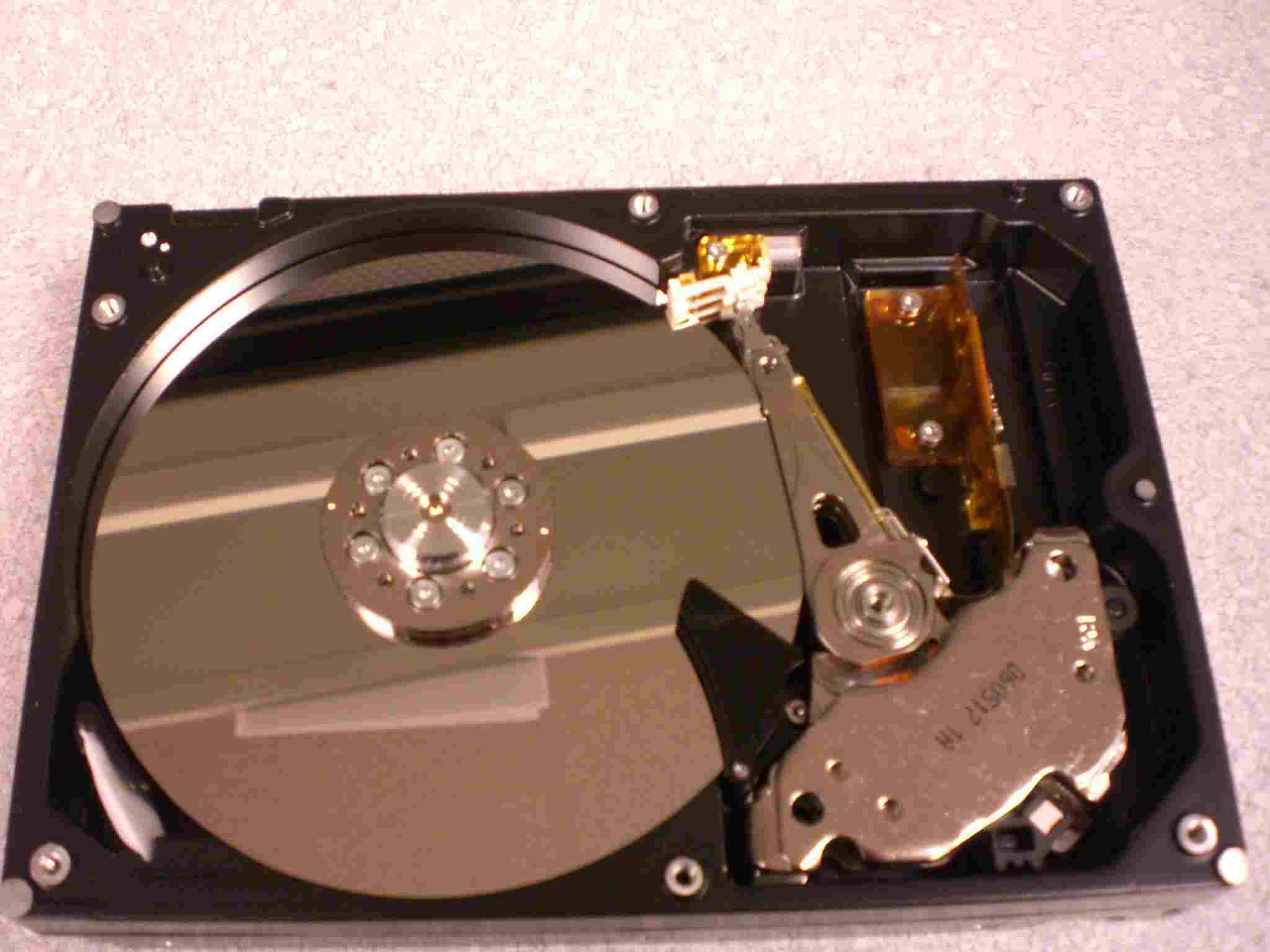

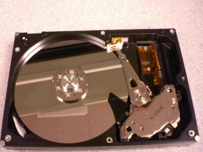

Now, I am a little confused.. Do I move the heads from the ramp to the platter while spinning the hub with a piece of paper in between, before I pull the head stack or do I remove the screw from the ramp to remove the head stack? I tried practicing with a spare drive and did not succeed. what would be the way to remove the head stack on a disk with ramps,.....this is a picture of my HD....Please help!

So I replaced the head stack, I found head 1 lingering/crashed (counting from bottom to top starting from 0) and now flying again. I know because I rechecked it after making them fly and have not crashed; now I have a new symptom. Before it used to just click for ever, now it clicks for a couple of minutes and then it settles. I hooked the drive back to an IDE cable and then to a USB, but cant see the drive at all, not even from the bios PC view. What would be my next step to follow?
Thanks for any help and all the help I already got. So far it has been a good challenge.
