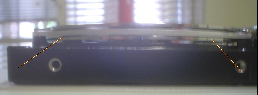

 Post subject: STOPPED ENGINE (SP1644N REV A)
PostPosted: January 25th, 2008, 14:11
Posts: 1060
Hi to all!!
Stopped engine, I know that they exist you vary techniques to unlock, however before you make would like it to exactly have some stories of cases similar or it model of hd (SP1644N REVA P80M 2007,02)
I know that here they exist expert in hdds SAMSUNG!! :mrgreen:

Plus one it will detail platter (one) is disaligned!
:vo:
Help??

Hi
what is your question exactly?
 Post subject: Re: STOPPED ENGINE (SP1644N REV A)
PostPosted: January 30th, 2008, 9:49
Posts: 1060
Hi pepe!
how I must make to unlock and to try to recovery the data of this hdd? :mrgreen:
Thanks advance!!
:vo:
Нет ничего невозможного
PostPosted: January 30th, 2008, 17:51
Posts: 4816
Yes, either free up the spindle or swap platters and align them.
There's no easy way...

I have some 3 disk refurbished maxtors Platinum 200GB that were like this, from USB caddies, spindles were stuck from being dropped and one disk was slipped also. I used a piston ring compressor (like mechanics use) similar to the platter exchange tool, clamped it around the platters, loosened the fixing screws, and re-tightened them to help align them. I had success with 3 out of 6 this way to re-align the disks. I freed the spindles with two small screwdrivers inserted into the hub holes, and another to help turn the spindle until it freed up.
Like this without crimps on edge http://www.mytoolstore.com/kd/kdengi08.html
Platter exchange tool $2000.00
This one $15.00 :) :)
