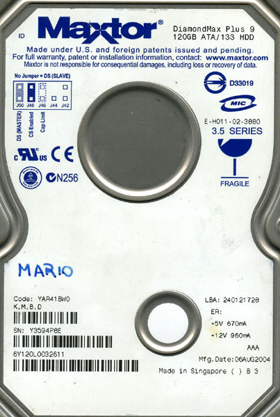

Hello gurus,
on a Maxtor HDD the motor IC has smoked!
Thiese are the data of the dead HDD:
YAR41BW0 K,M,B,D
S/N: Y3594P8E
6Y 120 L0 03 26 11
Agere Ardent C8-C1
M6FYA
Y3594P8E FY03A
I have also these DiamondMax Plus 9, and I would like to know if I have the chance of a PCB swapping, without buying a new PCB.
Disk #1:
YAR41BW0 K,M,G,A
S/N: Y47J5A4E
6Y 160 P0 04 28 11
Agere Ardent C8-C1
M8FYB
Y47J5A4E FY04A
Disk #2:
YAR41BW0 K,G,G,A
S/N: Y466TAJE
6Y 160 P0 04 28 11
Agere Ardent C8-C1
M8FYB
Y466TAJE FY04A
I have also some DiamondMax 10 and 8, but I think they aren't good for PCB swapping!!!
tnxxx
carlitos

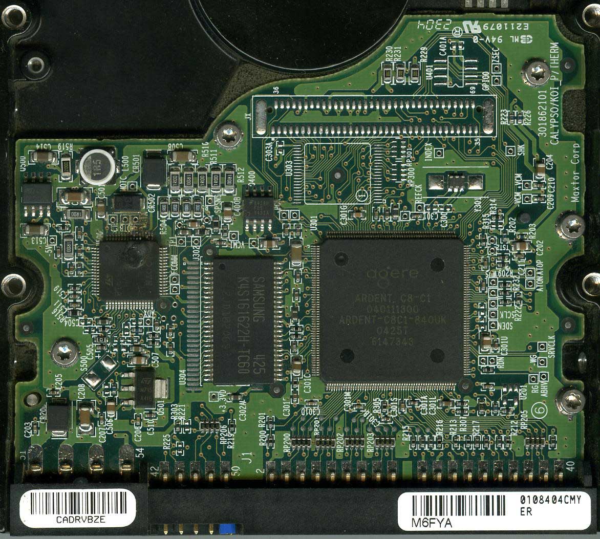

Post a pic of the PCB (patient)
 Post subject: Re: PCB Swapping list for DiamondMax Plus 9
PostPosted: March 10th, 2008, 16:13
Joined: November 15th, 2006, 16:19
Posts: 15
of the broken one?
PostPosted: March 10th, 2008, 16:27
Posts: 15

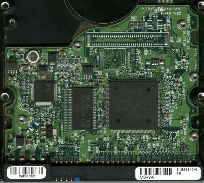

File comment: PCB smoked motor IC

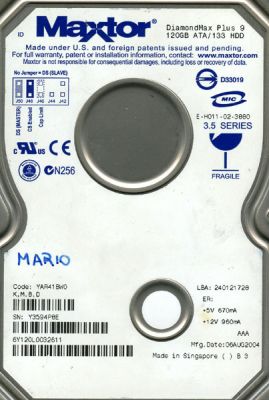

File comment: Top Sticker
Tnx
carlitos

Any of those boards will match your burned board.

the patient PCB does not have external flash ROM...
but the others should be working...
PostPosted: March 11th, 2008, 4:11
Yep, should be good.
Go for it.
Your patient does not have external EEPROM.
