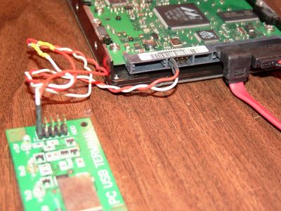

I am new with SAMSUNG HD.
I wanna know about SAMSUNG HD.
How to connect SAMSUNG HD to access terminally?
I have SEAGATE Terminal Access Tool, Can I use it to do it?
* Which software/utility to use/generate terminal command?
* What hardware and what is the procedure to connect for SAMSUNG HDD IDE & Sata Both.

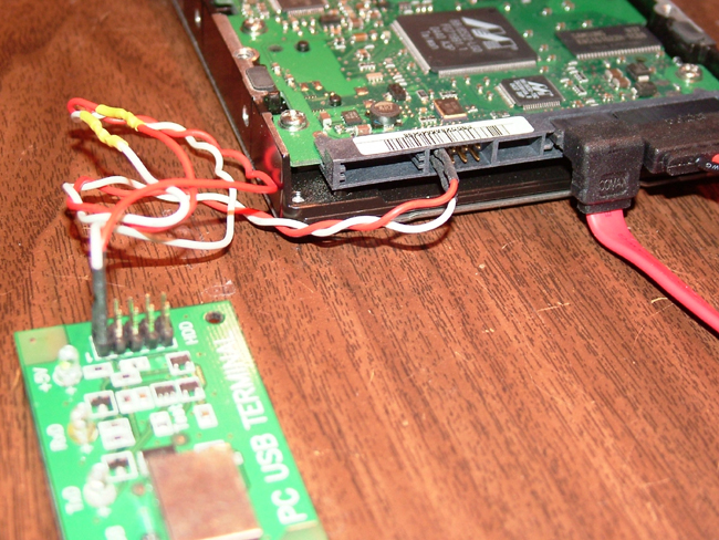

Do you have a PC3000?
There are TX and RXD inputs and outputs on the Samsungs that are suitable for terminal mode. The pic below is a SATA drive hooked to the PC3000.
Jon

Thank you for your reply. But I dont have PC3000.
Is it possible to access SAMSUNG HD using Seagate TX and RXD inputs/outputs using com port?
And which utility can I use to access the HD?
HyperTerminal of Windows XP, does it work in this situation?

Well, you can see what terminals to use. Why don't you do a little experimenting yourself?

at least a small interface circuit is needed between the COM port and the HDD, otherwise the +-12V can kill the drive's TXD and RXD pin...
see MAX232!
