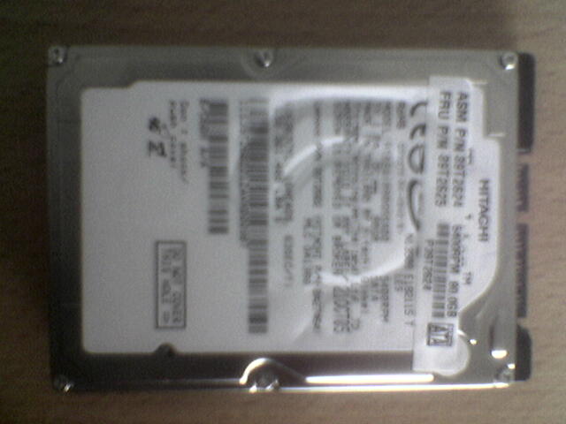

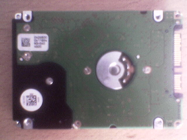

Here be last pictures of the dead HITACHI, i started contacting pros for it, already packaged and ready to be sent.
Should you be a Hitachi expert, please feel free to pm me with your website, fast quotation, or at least wish me a good luck ! :)
Best regards,
Gar.
PS: i had to comment these obvious pictures, because of the sooo very bad quality !
File comment: front side
File comment: back side
