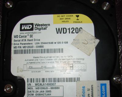

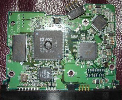

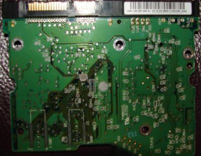

I've attahed the pictures of my Harddisk (PCB Burnt).
Let me know if you have a compatible PCB. I can change the ROM myself from the patient to the donor.

that type of damaged would more likely take out the preamp headstack.
i would change the headstack too to be on the safe side
if the first option does not work for you
