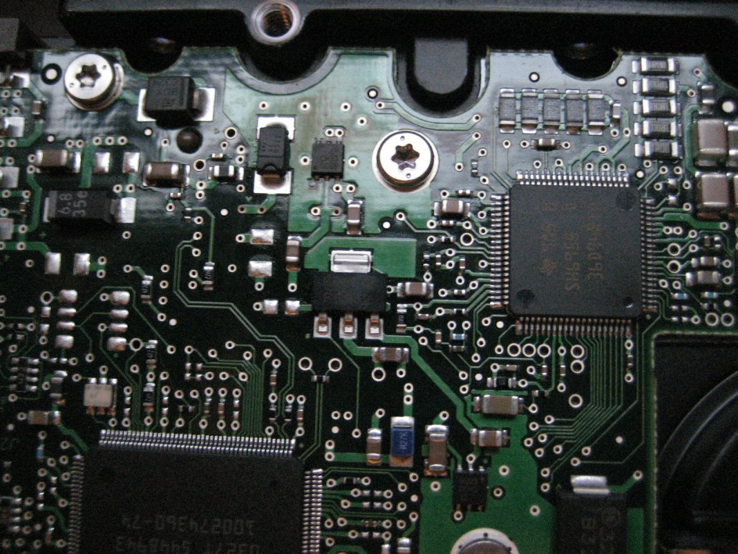

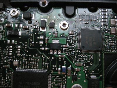

I'm just trying to work out what kind of component i sizzled on my PCB. can you get pcb maps or something?
File comment: its obvious to see
 Post subject: Re: working out what component is what
PostPosted: August 7th, 2008, 4:58
Posts: 1466
Location: Europe, Hungary

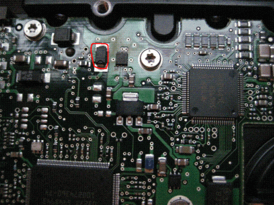

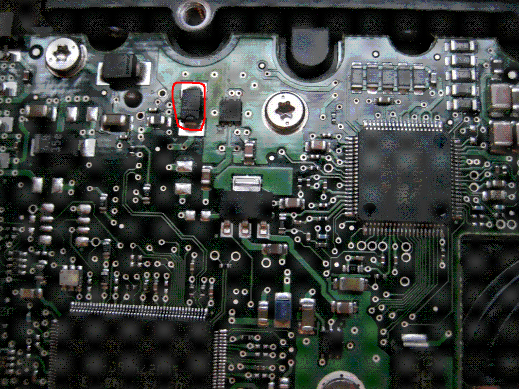

This is a seagate drive, and you have one short TVS diode. :)

The TVS is quite easily identified because it is a rather large black component with just 2 contacts to the PCB, and is clearly seen damaged in your picture. Many HDDs have TVS diodes, I often have Samsung HDDs with damaged TVS, but pretty much any Seagate PCB will have a suitable power diode you could use.
But without the correct tools, you may only end up making things worse!

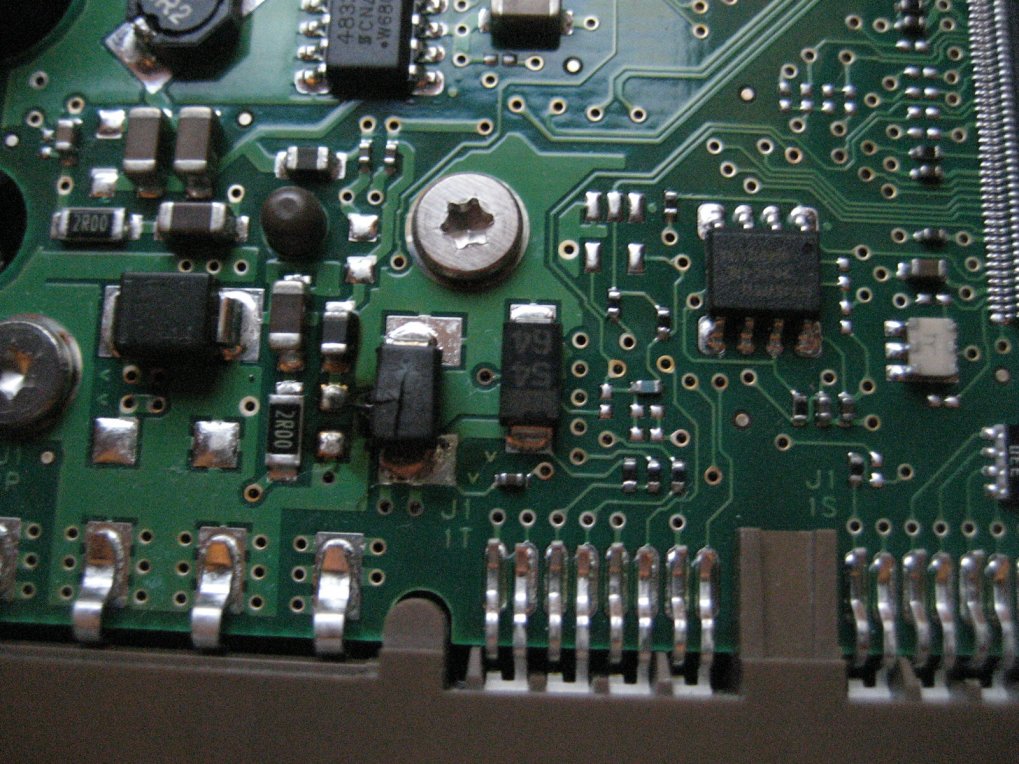

If you post here a picture of the PCB from your 40GB Seagate PCB I can tell you if there is a component on there that can be used.
PostPosted: August 7th, 2008, 6:05
Joined: August 6th, 2008, 6:22
Posts: 14

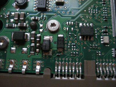

ok too the left of the screw im guessing is wat ill need but if not how do i know the specs?
PostPosted: August 7th, 2008, 6:16
Posts: 411
Location: Romania
In fact this is the one you need

ok tvs is replaced but no power up:( any help?
PostPosted: August 8th, 2008, 23:12
Joined: June 8th, 2006, 19:44
Posts: 3144
Location: Atlanta, GA
The TVS has a polarity. If you put it in backwards it will fail.
Just remove it altogether and see if drive powers up. Makes sure you have a good power supply as noted.
