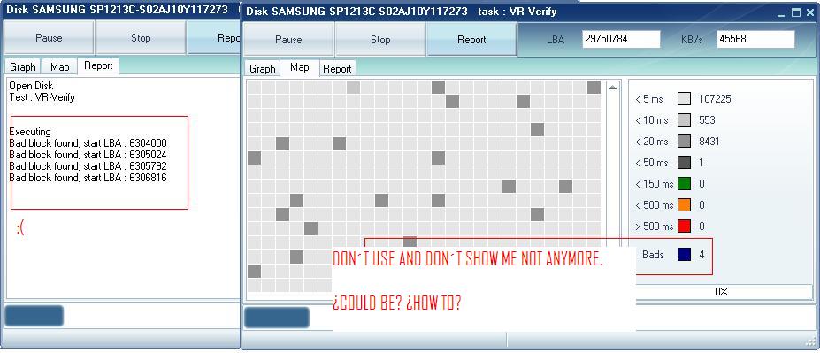

Iam trying to use, for repair bad sectors, ¿which is the option?, ¿I must mark bad sectors?

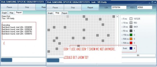

:( it doesn´t work, ¿What can I do, I want that,don´t show me bad sectors, using hddscan, ¿ is there any tool to use, I dont know what´s happend, with hdd regenerator, it is the same problem

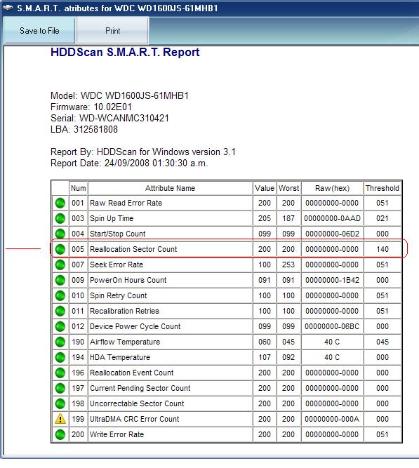

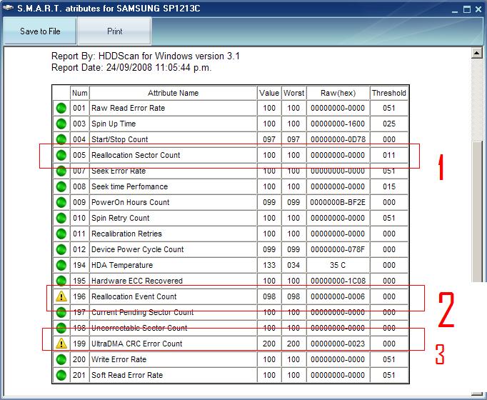

I want that when i use hddscan, don´t show me, Bad sectors, take off, or mark to use other good sectors, ¿what can I do? using mhdd o hdd regenerator, I dont know what to do, I mean that take a look the pic

Please post SMART screenshot. You can see SMART values in hddscan.
Maybe your hard disk reallocation table is full. That is why it is showing bad sectors. Otherwise, this drive looks good. In modern drives, bad sector remapping is done automatically, you should not see bad sectors in windows (unless your bad sector allocation table is full).
What is MHDD showing in surface scan?

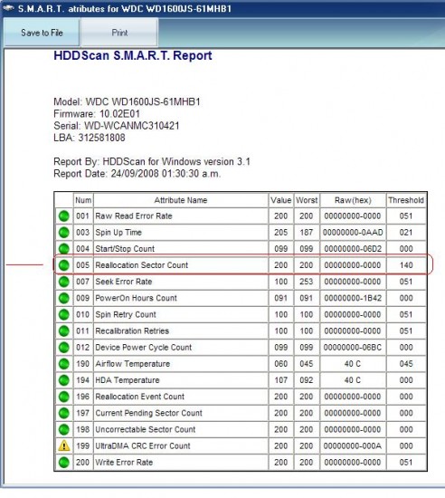

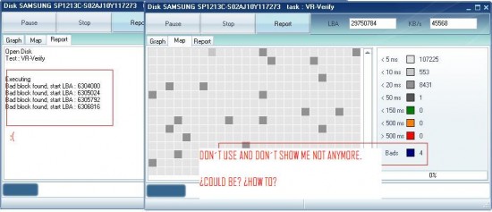

MHDD, it is the same, diagostic, that hddscan, but the difference now, that I do, what do you say me before, Scan + Remap ON. Scan + Erase Delays ON. now iam using again, hdd regenerator I think, it is working, on the screen, say: 4 sector repaired. I dont know, I hope have got good luck. Later i give you the information.
now iam interested, that you saying:
Syncelery, I don´t know that problem can you to explain, I have an example about my disk, because the other who have the problem it is running, hdd regenerator sorry. would you be so kind as to explain with my hdd, bye brother

This all looks good to me.
I don't know how you can get bad sectors on windows in this scenario. Maybe pros can help.
Please run Western Digital Data Lifegard Diagnostics and choose WRITE ZEROS (all data will be gone, if you still have anything on this drive). Then check your SMART values again.

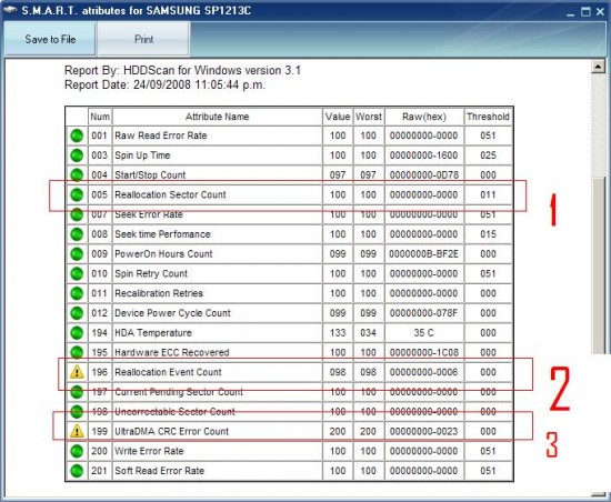

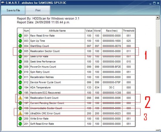

Well, iam very confused, i try with hdd regenerator, i can´t see bad sectors, in combination vmware (virtual machine) configured for use physical drive. there is not. And after running, hddscan,I can see again bad sectors. the ask is ¿why? I dont understand.
I try, with vmware mhdd dont work, just can use, sata cdrom and, 8mb virtual memory as a drive. I dont have time to repeat the process with mhdd but I give you the information for more detail. bye brother, I hope that you can help me =) ;)

Because hddreg doesn't do the job. True error remapping can only be accomplished working with the error lists or using internal drive specialized functions, and when possible, not in case of weak heads, for example.

vmware, hdd regenerator, windows ??? What are you doing?
hdd regenerator is snakeoil (anyone feel free to counter this).
Go to DOS (DOS... no virtual machine, no windows command promp -- PURE DOS) and run Western Digital Data Lifegard Diagnostics and choose QUICK TEST. If all is good, then choose WRITE ZEROS. Then scan with MHDD (in DOS) and then check your SMART values.
Stop wasting your time with anything in windows at this point. First find out what the real problem is.
Your Reallocation Event Count is 6... your Reallocation Sector Count is 0. This means drive found some weak sectors and marked them pending. But later it was able to successfully recover these sectors (by reading or writing them). Reallocation Event Count records both successful and unsuccessful tries. That is why it is 6.
Your ULTRA DMA CRC Errors are increasing. Change your CABLE.
