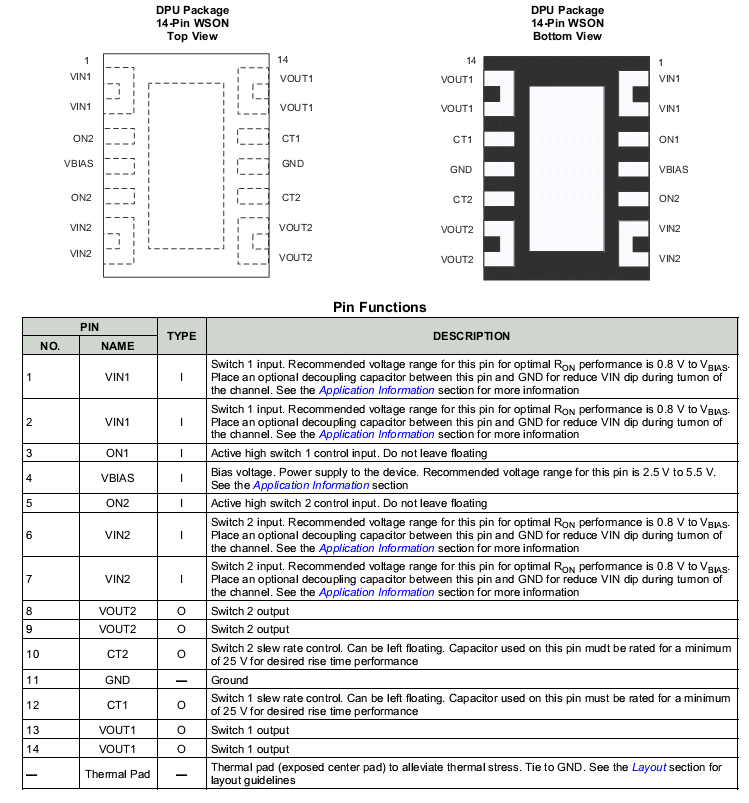

The 14-pin IC adjacent to V1 and V3 could be a TPS22966. I would check the two Vouts.
TPS22966, Texas Instruments, 5.5V, 6A, 16-mohm ON-Resistance Dual-Channel Load Switch, marking RB966:
http://www.ti.com/lit/ds/symlink/tps22966.pdf

I have measured all points you marked for me:
V1 1.10Vdc
V2 3.05Vdc
V3 1.87Vdc
V4 1.81Vdc
V5 12.15Vdc
V6 1.10Vdc
V7 1.26Vdc
At the e-fuse:
Vin 5Vdc
Vout 5Vdc
14 PIN
Vout1 1,81Vdc
Vin1 1.81Vdc
Vout2 1.26Vdc
Vin2 1.26Vdc
Bias 5Vdc
http://forumbilder.se/G82V8/singleshot0000
Looks quite suspicious that the Vin and Vout are the same at the 14pin IC?

RB966 is a switch, so Vout = Vin. All the voltages look OK.
