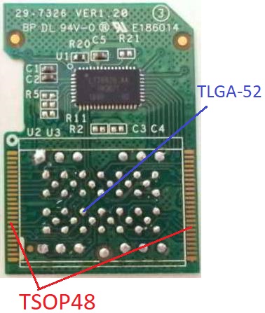

small detail, but the MCP (multi chip package) has 2 parts, flash and PSRAM. There are different actual part numbers for each, and the flash part is
http://www.datasheetcatalog.com/datasheets_pdf/M/3/0/L/M30L0R7000B0.shtml
We actually discussed this last year: http://forum.hddguru.com/viewtopic.php?f=10&t=37167&p=262087 and I've been working on reading a similar chip. As I remember these chips are pretty small, smaller than it looks on the pics.
just going over this again I see I've missed a very important detail. I was under the assumption that the FlashCat pro did everything the other FlashCats did. I see the developers actually told me the XPORT should support it, and looking at spec pages for each device, seems with all the FlashCats I have, I don't have the right one. I am ordering the XPORT, I already have level shifters.

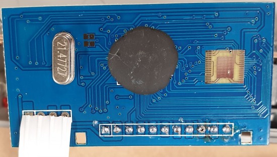

 Post subject: Re: Accessing/Modifying/Dumping M36L0T05 Flash Contents
PostPosted: June 24th, 2019, 2:00
Posts: 3963

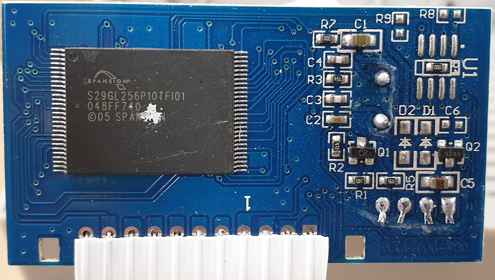

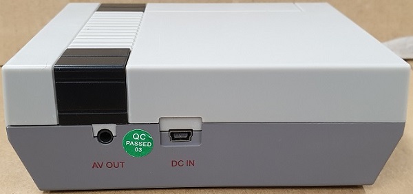

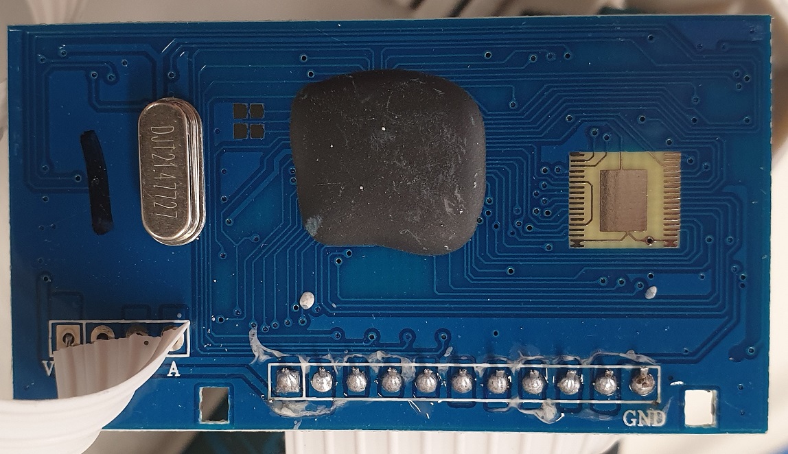

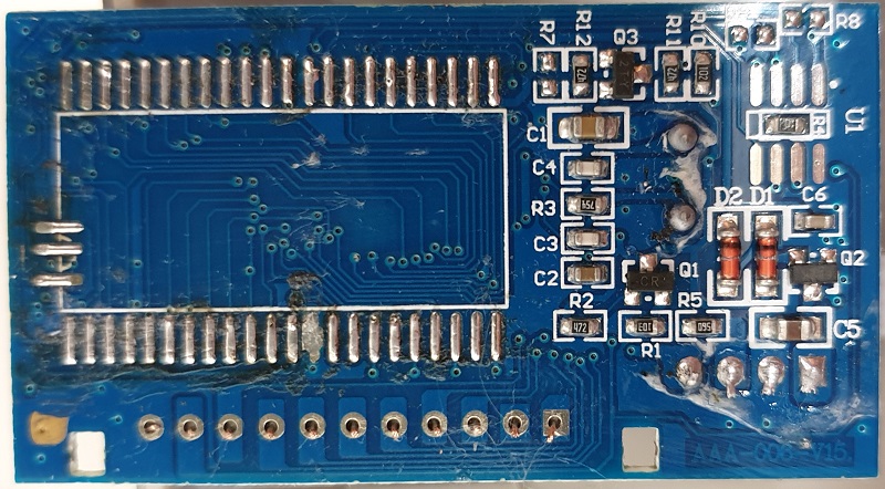

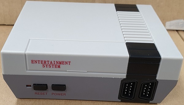

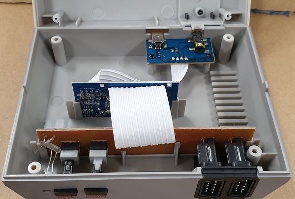

So my unit arrived and it is slightly different mainboard. Holds a single Spansion S29GL256P10TFI01 chip. Datasheet:

So your Spansion part is flash only whereas the OP's part is flash + PSRAM? This would suggest that the RAM is not used, or perhaps the blobs are not same (your blob may have on-chip RAM while the OP's may not).
PostPosted: June 24th, 2019, 11:06
Posts: 3963
I don't think the RAM is used. It may be possible to tell once more is worked out on the OP's board, such as if any connections to the flash that would be RAM only are missing, or tied to just flash.
Here is another teardown of a similar console. https://hackaday.io/project/27204-fake-nes-classic-edition-teardown
It uses a Spansion Flash as well. This one has a difference in the controller cable, only 4 wires. Also there is 2 pads that could possibly be the same as the pads between the CPU and crystal Osc labelled J1 and J2. they appear to be hard wired together with the trace. I looked closer at ours and I think they are actually connected with traces to ground plane as well.
Im guessing under the blob, a pretty basic FPGA is used, as this seems most popular for this application, and CFI memory interfacing is common. Maybe a Xilinx, Atmel or Freescale. This document outlines interfacing a S29GL :

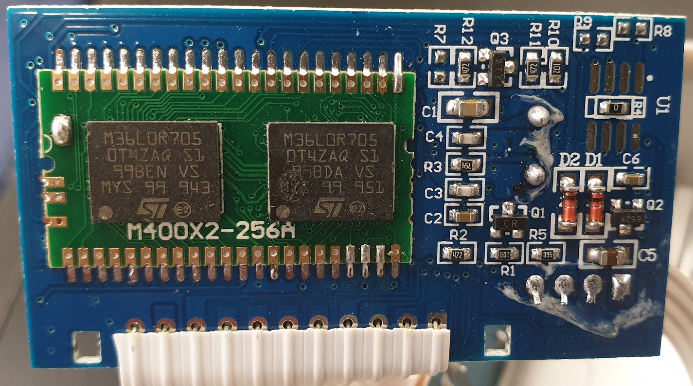

PostPosted: June 24th, 2019, 20:07
Posts: 17215
I'm curious about the power supplies. Where is the 3.3V (and 1.8V ?) supply generated?
PostPosted: June 25th, 2019, 0:36
Posts: 3963

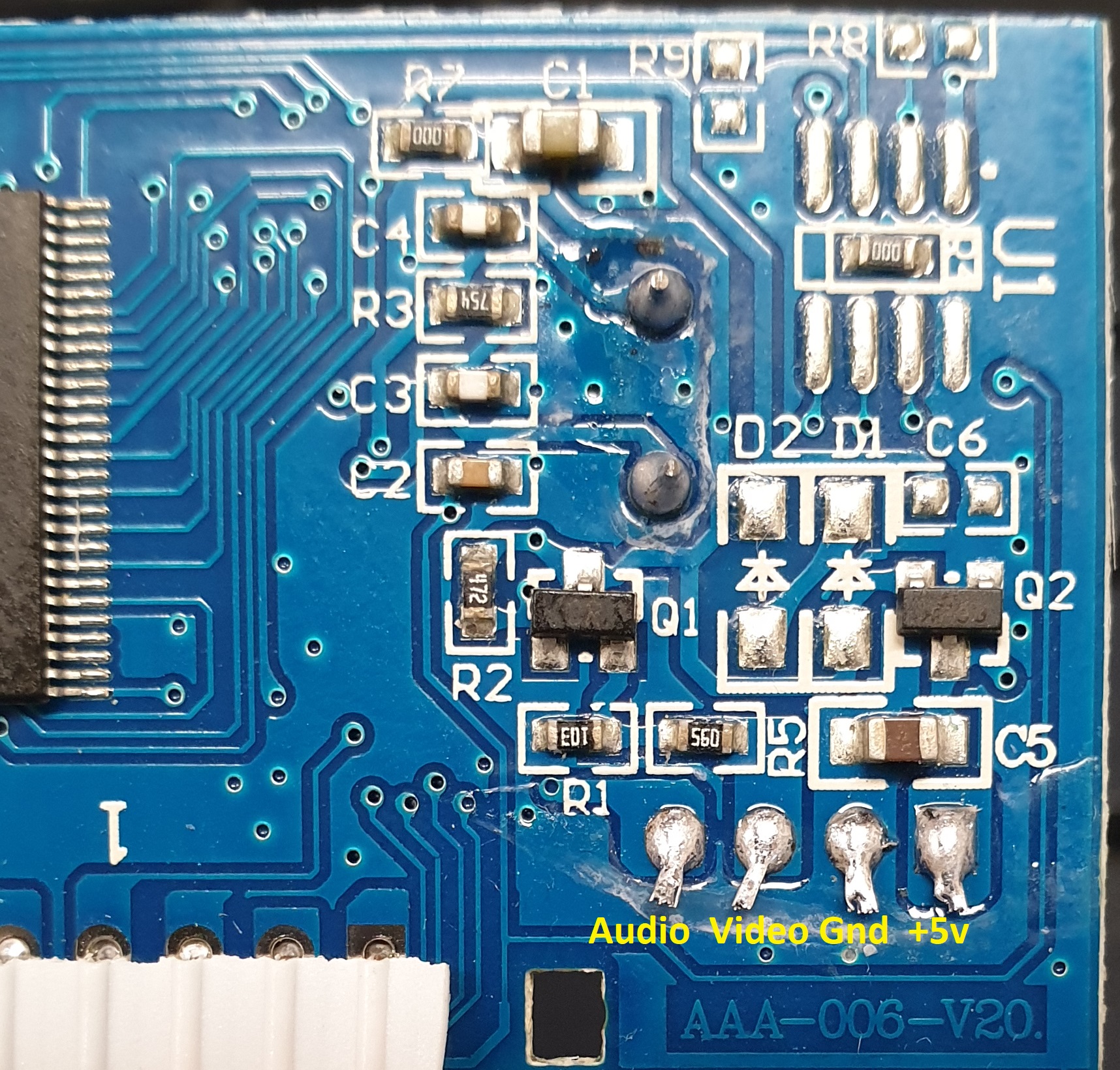

It is supplied by a 5v brick with USB Mini-B connector. if the circuit on the Mainboard doesn't do it, maybe more is done in the Processor itself. It is an extremely sparse circuit. Here is a better photo of the area
PostPosted: June 25th, 2019, 2:22
Posts: 17215
Q2 appears to be a 3.3V LDO regulator, although its circuit reference is that of a transistor. It seems inadequate for the job.
Q1 appears to be buffering the video output.
The 4-wire cable seems bodgy. It is bad practice to share a common ground conductor between power and signal pins. AV ground and power ground should be separate runs.

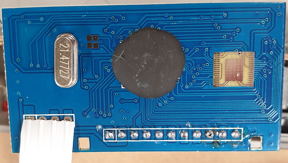

I'm wondering what is under the memory addon board. possibility of another package pads under there in a similar way as this SD Card has 2 possible package types.. if a TSOP48 was soldered on, you wouldn't know about the circuit for the TLGA under there.
if there is an unpopulated set of pads, it may be possible to trace back to the memory board.
because this board would be easy to solder back on, maybe you could de-solder it and have a look what is under it?

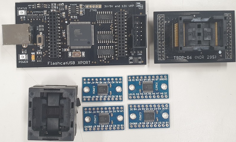

Last week I ordered a FlashCatUSB XPORT and a tsop56 adapter to read the Spansion on my board. I also ordered 2 more units of the game for testing, as I found some cheap, and it will be useful in any case if they are all slightly different or the same.
And I also found a socket manufacturer that can custom make sockets, so I ordered a BGA88 socket with .08 pitch and got them to custom make a limiter for the chip size 8mm x 10mm, as usually BGA88 and .08 pitch is a chip with dimensions 11mm x 13mm.
I am working on a PCB for this socket in AutoTRAX DEX software to make it easy to use taking into account the level converters for the 1.8v these chips, as the FlashCatUSB is 3.3v or 5v
I know my chip isn't BGA88, but I do have an ongoing project that does have one - a chip from an old LG phone
PostPosted: June 29th, 2019, 20:15
Posts: 17215
XC6206P332MR, Torex, LDO regulator, 3.3V, 200mA, marking 662x, SOT-23:
https://www.torexsemi.com/file/xc6206/XC6206.pdf
PostPosted: June 29th, 2019, 20:48
Posts: 3963
so If 1.8v is needed somewhere, do they do this by a dodgy resister voltage divider? or maybe the IC that runs it is so "good" (meaning it is a very purpose oriented IC for this type of application that handles video and audio plus the basic processing for emulation for the ROMs) that it does the 3.3v - 1.8v stepdown..
BTW I don't know electronics as well as Franc, so not sure if voltage dividers are dodgy or quite fine
PostPosted: June 29th, 2019, 21:29
Posts: 17215
Voltage dividers are generally only used for voltage sensing. They cannot be used as voltage supplies. As soon as you start drawing current from a voltage divider, its output voltage plummets.
Another bodgy aspect of the circuit is that there are no small bypass capacitors adjacent to the flash chip's supply pins.
Edit: I believe that a nominal 1.8V supply is derived from the 3.3V supply by dropping the voltage by 1.2V via diodes D1 and D2. Another bodge ...
This would suggest that your "blob" doesn't require a 1.8V supply.

@HaQue, I should clarify my previous post by saying that the OP's circuit requires 3.3V and 1.8V whereas yours needs only 3.3V. This is because diodes D1 and D2 are populated on the OP's PCB but not on yours.

That would make sense as @mgysgthath's memory chips need a 1.8v supply and mine are 3.3v
So we probably can deduce a little more about each circuit knowing this supply trace
PostPosted: July 10th, 2019, 2:47
Posts: 3963
UPDATE:
I received a few things. 1 of the consoles, I think same as OP's luckily.
NOR Removed:
I also received the new FlashCatUSB XPORT, some level converters and the BGA-88 socket:
I will be able to read the Spansion NOR tonight I think, and I will also be making a PCB for the BGA-88 Socket to use on the FlashCatUSB, and do the level conversion, so I don't have to rewire everything all the time. I made a Mock-up in Paint to show how I think it will look:

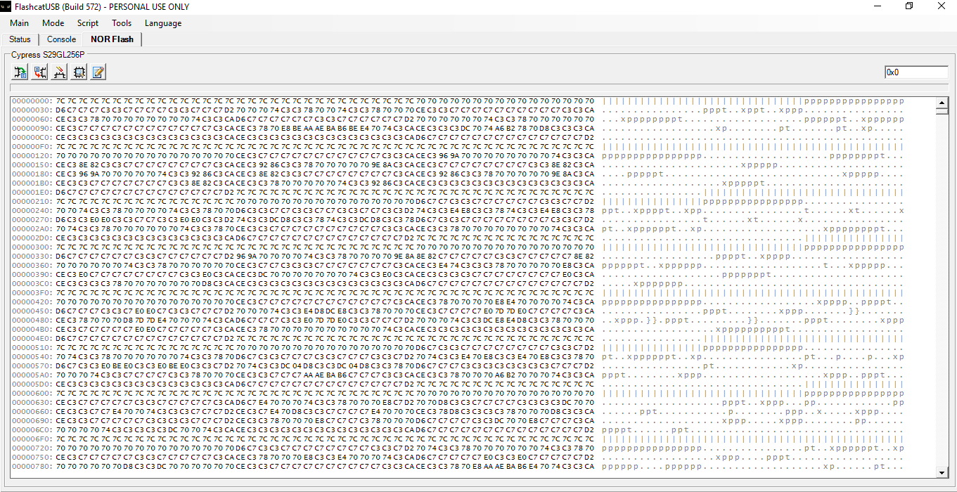

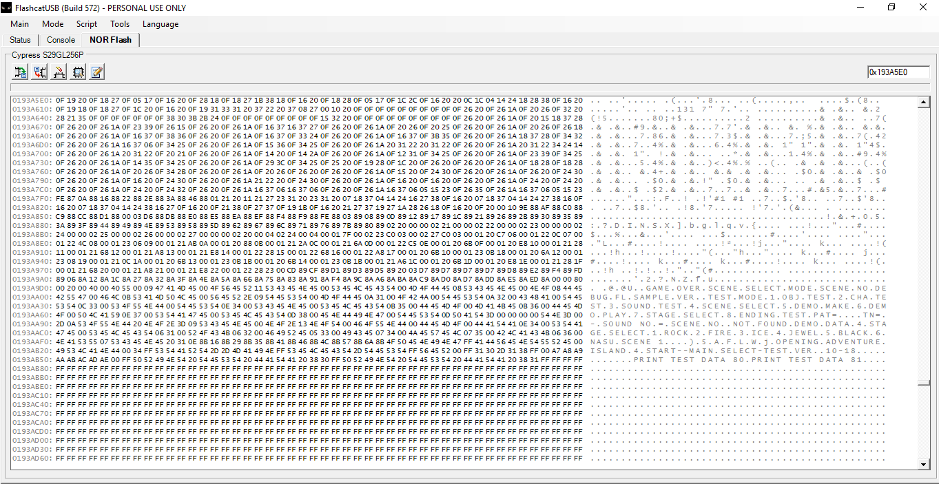

PostPosted: July 10th, 2019, 8:33
Posts: 3963

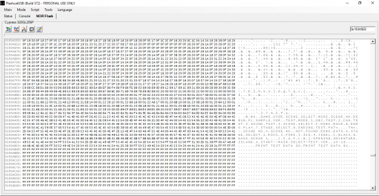

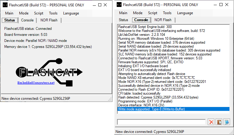

I read the Spansion S29GL256P10TFI01 TSOP-56 NOR Flash without incident. Binary dump is 32MB, 7zip'd file is 12.2MB :
PostPosted: July 10th, 2019, 10:37
Posts: 3963
ddrecovery wrote:
Nice job.
Thanks. Makes it easy when someone creates a nice tool like the FlashCatUSB!
I installed binwalk and all dependencies on the Linux Sub system on a Win10 laptop.
I ran the dump through binwalk, though I expect a lot of false positives because this probably isn't actual firmware (Guessing that would be flashed to the FPGA/CPLD/or whatever processor is in the blob)
I have only given the output a quick scan, but interesting copyright notices!
I am guessing that this flash just contains a bunch of ROMs, and there may be some more analysis by finding a ROM file the same as one in the flash, carving it to see what the file format is. maybe can carve out the rest of the ROMs and see whats left. May be possible to flash more in there or switch ROMs or others, or even just get it to display something cool.
There could be something in the flash that can help ID what is under the blob as well.
