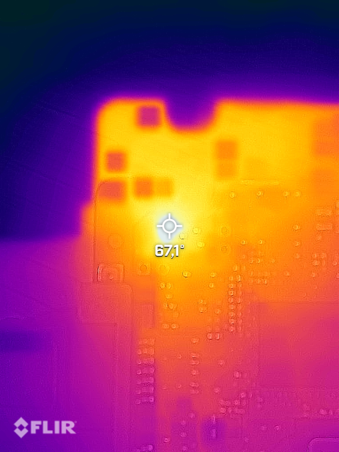

 Post subject: Re: Crucial MX300 - No SATA connection
PostPosted: March 22nd, 2022, 8:33
Joined: July 23rd, 2015, 6:40
Posts: 123
Location: Austria
FLIR arrived :D
have to play around with it, but first images shows me, that i'm not that bad at guessing temperatures :D
PostPosted: March 22nd, 2022, 8:51
Posts: 1323
Not sure what your calibration is like, but flip the pcb over and check it again.
