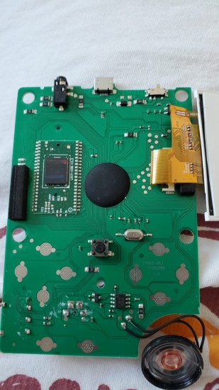

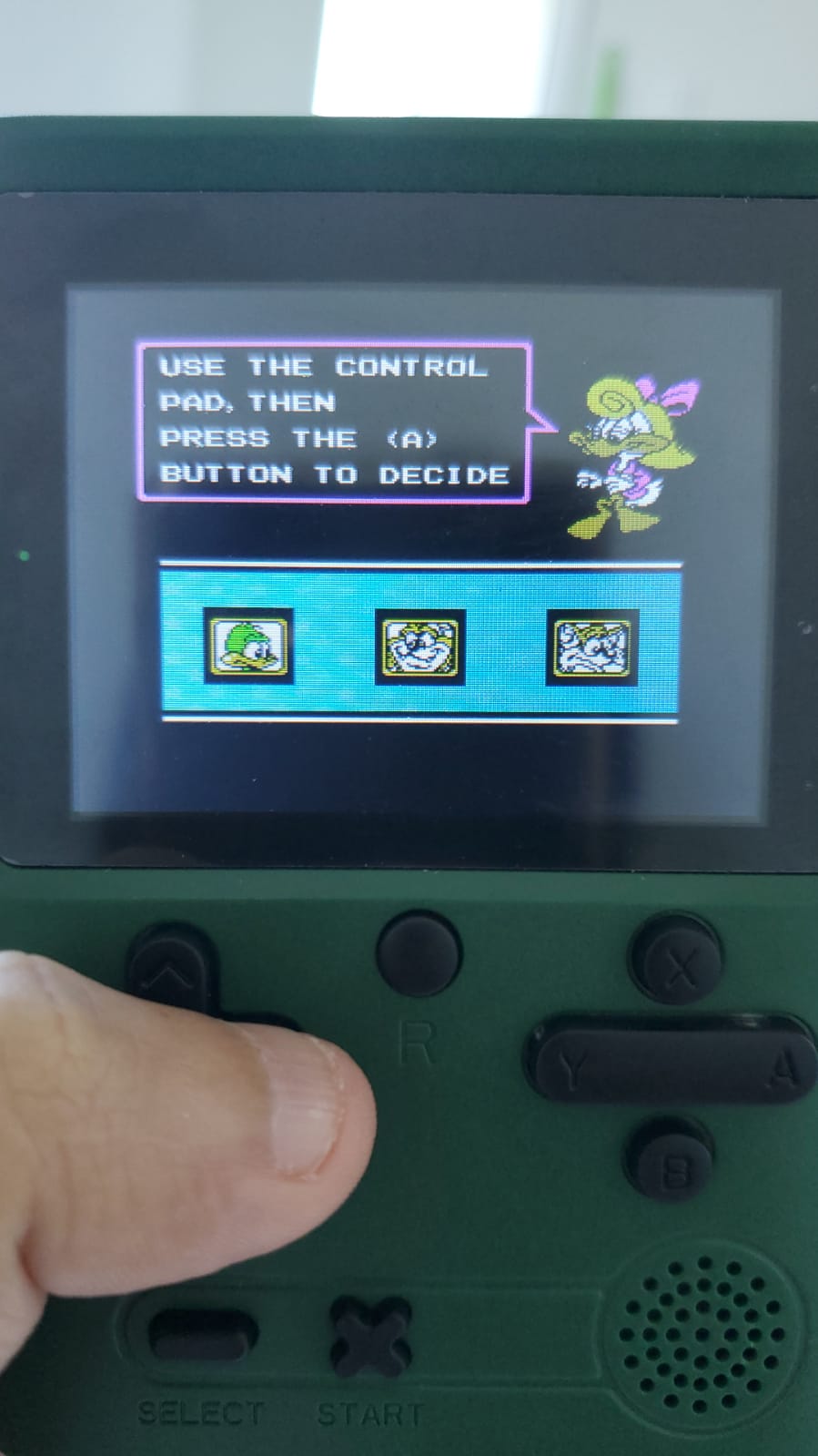

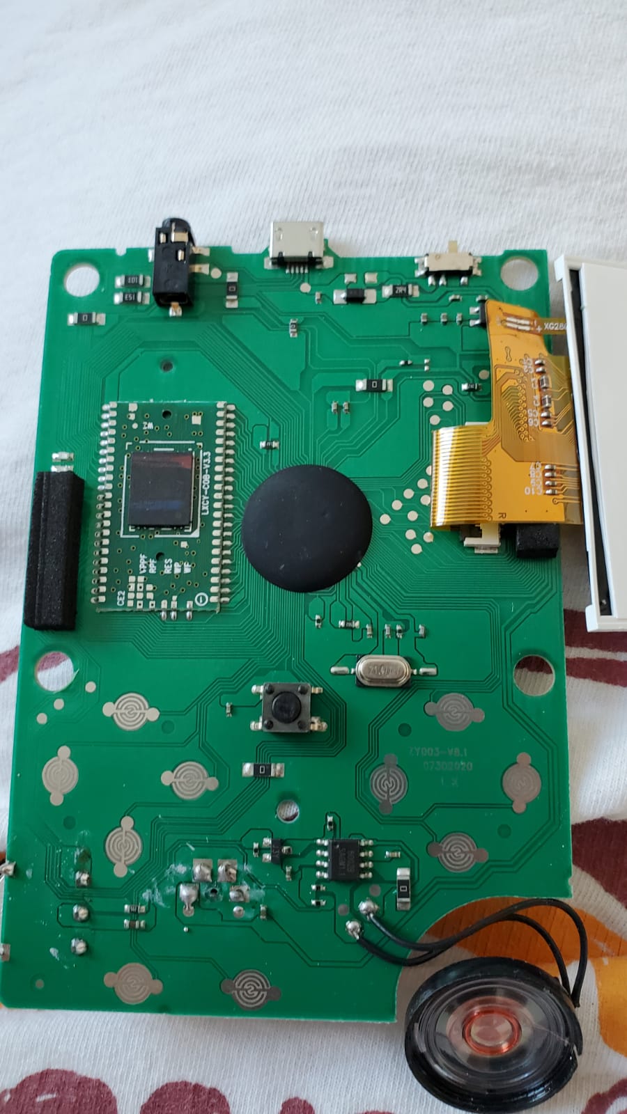

Hello guys, i saw that you successfully dump the data from those chips, in my case i got a new Retro FC mini console, this one was a bargain soooo, i bought it, well story short, it has a blob, also the M36L0T7050T3ZAQ, so i was trying to read the contents and learn how this one works to hack the roms and the basic landing screen that is soo annoying, i tried with my raspberry to identify the port and other things about the board, but looks like the usb port does nothing else than receive power and send power to the dummy extra 2 player controller included in the package, so i was wondering if you would be so nice to provide information about how did you manage to dump the contents and more important if you guys were able to flash it again with different data.
Cheers.
File comment: board
File comment: Quality

The FlashcatUSB XPORT should be able to read that chip, though you would need to do one or more of the following:
1) check datasheet of actual chip for voltage and pinout
2) if 1.8v, make an adapter with logic level converters
3) wire it up on a board to interface with XPORT.
I have just started re-visiting this and have received some level converters, and started designing a board that will go straight on XPORT.
Forget the BLOB! It is likely just an FPGA emulator, and offers no value to pursue getting into it.
flashing with different data, while theoretically possible, isn't really viable. It has been discussed already in previous posts.

Thank you, yes i was able to read the data form the flash, i used a RPi0W it was a bit slow but it worked, the sad part, i was planning to update the content and add more functions and kind of mod the usb entrance to allow read write actions, but while i was reading the binaries and the small amount of info about these roms and how the worked i realized it will take me way more time, and it wont be useful, these change every month and the as the picture shows they will just mod the chip over an over and just change the blob to work with the new chip. So not worth the effort.
At the end i reused what i could and created a small linux retrobox using fbdev for the rpi and the components in the handheld.
Thank you community, and i think we can close this out, is not worth the effort.
PS: i have the datasheets, pdfs, looks like that chip is deprecated and the info is not longer available in all countries.
Cheers
