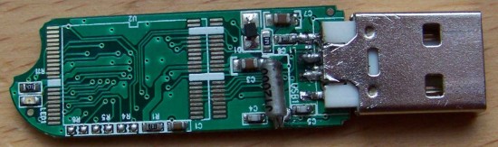

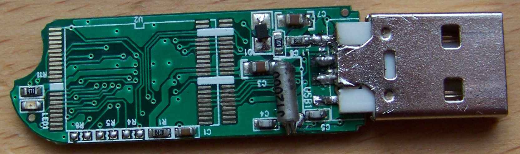

I've got flash drive that has partially damaged PCB (close to USB plug). I don't know model name of it.
I'm looking for PCB photo (both sides) of this drive.

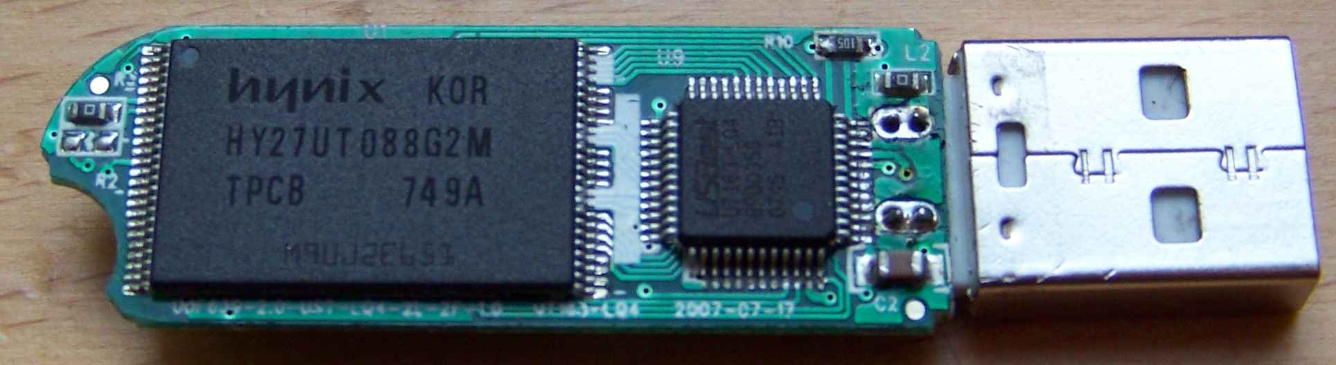

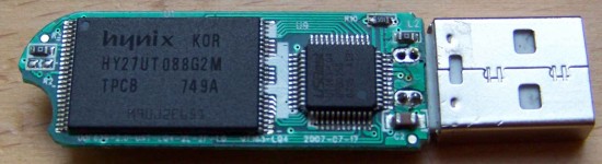

Controller UT163. Someone bend it and then tried to repair it.
Don't know where to connect second and third pin (USB plug to pcb).

Looks like all element on place. Is pen recognize by OS?
If not, you should read flash directly form nand.

Here is a datasheet for the controller:
http://booroo.ru/wp-content/uploads/files/UT163.pdf
It looks like pins 8 and 9 are the USB D+ and D- pins, respectively.

It's not recognized by OS nor ChipGenius, but the led on it is on (red).
8 and 9. Thanks. I thought so. I'll try and let you know.

Drive is working. Thanks.
