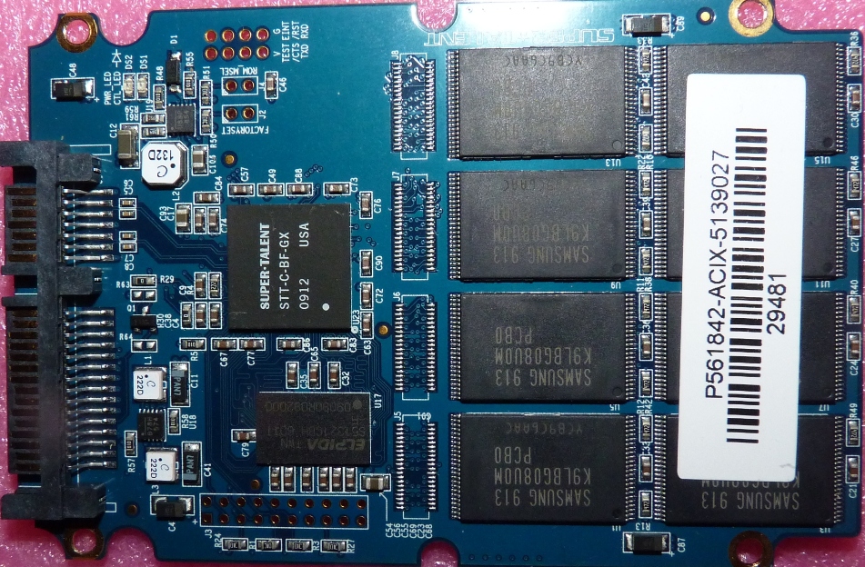

Type:
SUPER TALENT (SATA 64GB) FTM64GX25H
878294008732 P561842-ACIX-5139027 29481
Controller: SUPER-TALENT STT-C-BF-GX 0912 USA
16 x Memory: SAMSUNG 913 K9LBG08U0M PCB0 YCB9C6AAC
1 x ELPIDA TWN S51321CBH-6DTT-F 09090R092000
More:

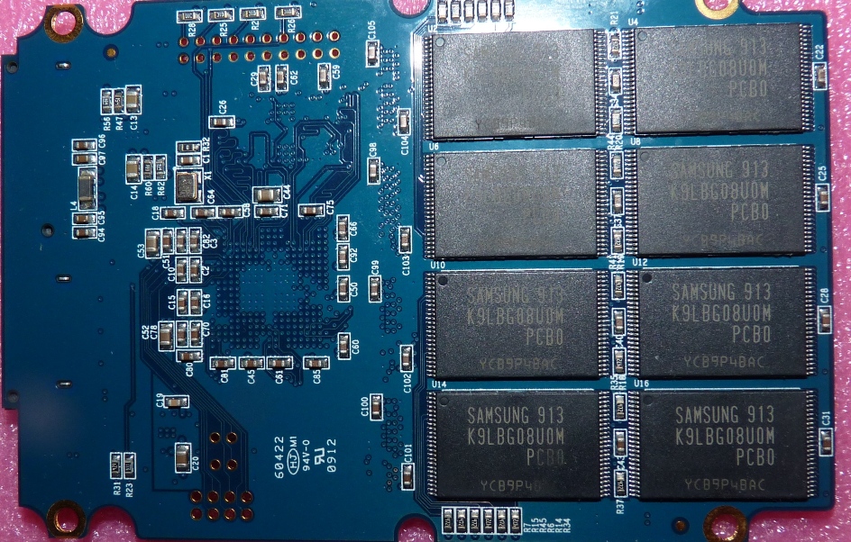

Can you show photos of this SSD? - both side of PCB.

Pictures:
 Post subject: Re: Super Talent FTM64GX25H “Yatapdon g barefoot-rom” Red LE
PostPosted: February 14th, 2013, 3:48
Joined: February 4th, 2013, 15:36
Posts: 57
Location: Russia
Although the stamp on the controller is Super Talent... This is a rebranded Indilinx Barefoot controller. PCB layout is exactly same that I saw on another drives.
The string "Yatapdong Barefoot-rom..." meens that the drive is working in emergency mode. For some reasons it is not able to start main firmware. May be firmware or some other structures are damaged. But i'm sure most of your data is still alive.

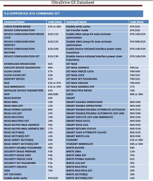

So it is probably possible with SATA only.
Can anyone confirm this?
How to make a standalone ATA script? (MHDD? more directly?) What are possible errors that i can bypass this way?
Of course even if don't change anything i really want to learn how to talk to the SSD by ATA commands
and get any diagnostic answers from the SSD and post them here.
Someone please give any directions how to talk to the SSD and which are striking ATA- /vendor specific-commands here.
@bubaleh - thanks! to send/answer messages just click "answer" in a message, "PM" below any public posting or in the top of the page "User Control Panel" or "0 New messages"
PostPosted: February 18th, 2013, 18:20
Joined: February 11th, 2013, 13:44
Posts: 25
Location: germany
Datasheet:
SuperTalent Ultradrive Datasheet_Channel_v1.3.pdf [519.34 KiB]
Downloaded 1873 times
