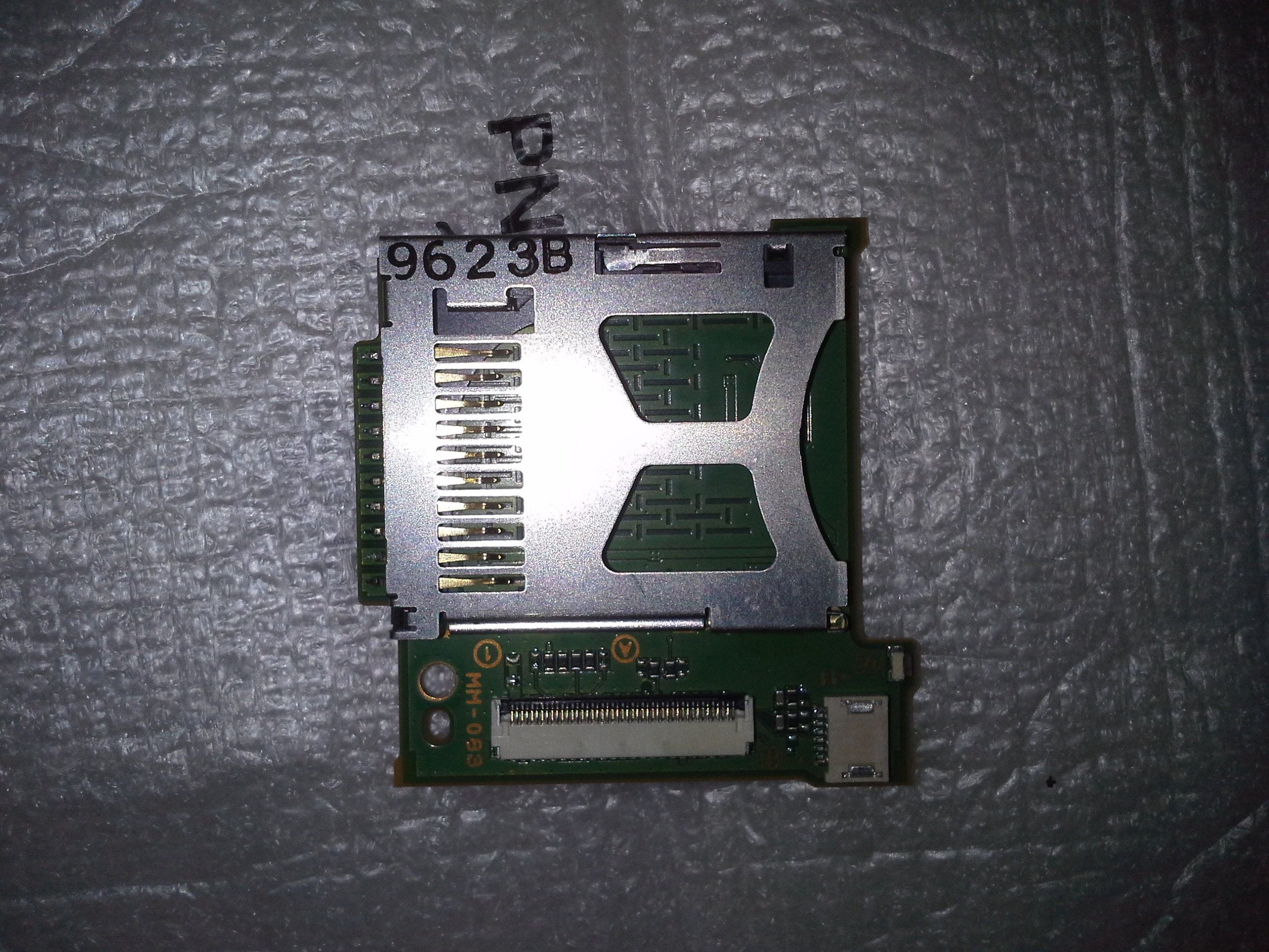

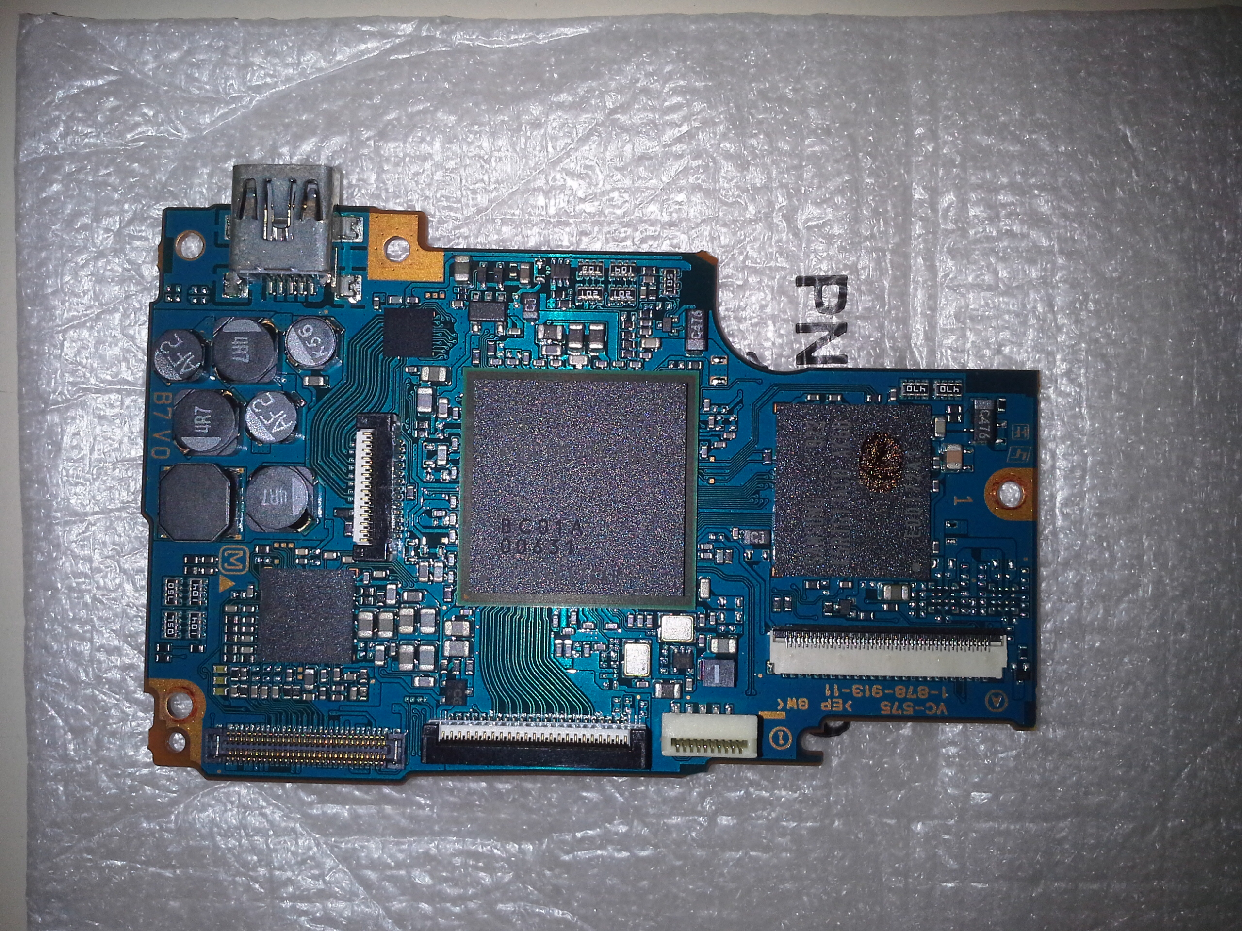

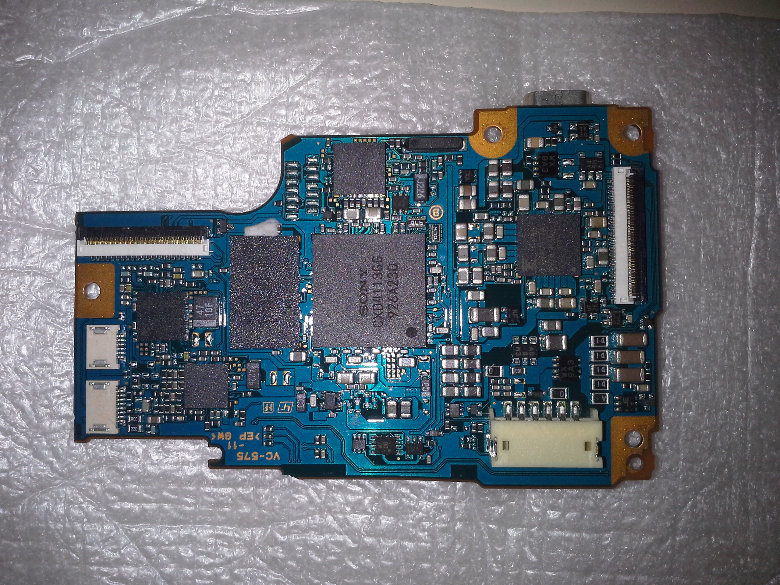

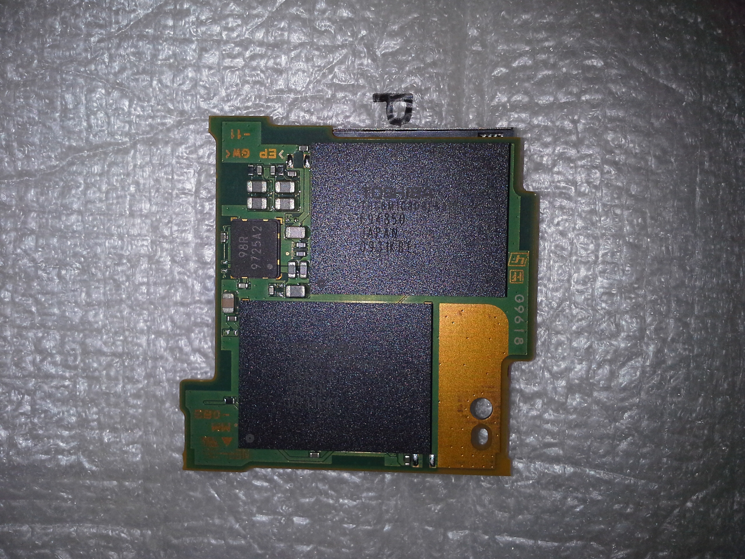

I dropped a digital video camera and sent it off for repair. I was told it was an uneconomical repair but the technician said he could remove the memory modules for me to send away for DR.
He supplied me with 2 small boards, pictures of both sides of each board are following.
I hope the pics are clear enough.
Is data recoverable from these memory modules?
If so, any recomendations for a reputable company in Victoria Australia would be appreciated.

I believe so, could you please list the chip numbers on the second picture (or all if you feel energetic) as they are hard to make out and important.
I am in Adelaide and work with Flash, and have helped a number of people on here that have posted to me.
Welcome the chance to help you on this.

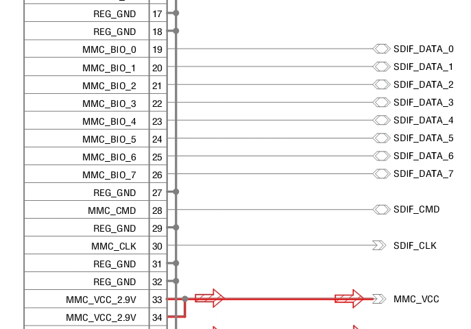

The "MM-083" card appears to have a standard 8-bit MMC interface with a 2.8V supply voltage. Its diagrams can be found in the Level 3 manual.

 Post subject: Re: Advice on camera modules
PostPosted: April 12th, 2014, 17:41
Posts: 17356
IC8701 & IC8801
THGBM1G8D8EBAI2
32GB eMMC
http://datasheet.octopart.com/THGBM1G8D ... 973698.pdf
http://pdf.datasheetarchive.com/indexer ... 020864.pdf
SE6601
21kHz/23kHz
Pitch/Yaw Sensor

fzabkar, I don't know how but you nailed the camera model. HDR CX520.
HaQue, If you still need the numbers on the chips it might take another day, I'm going to need to source a magnifying glass or digital microscope. I'm more than happy to send them to you in SA if this is within your field.
Appreciate the input so far.
PostPosted: April 13th, 2014, 20:34
Posts: 17356
I searched for PDF documents containing "VC-575" (the number on the larger PCB).
http://www.google.com/search?q=%22VC-57 ... 3Apdf+sony
