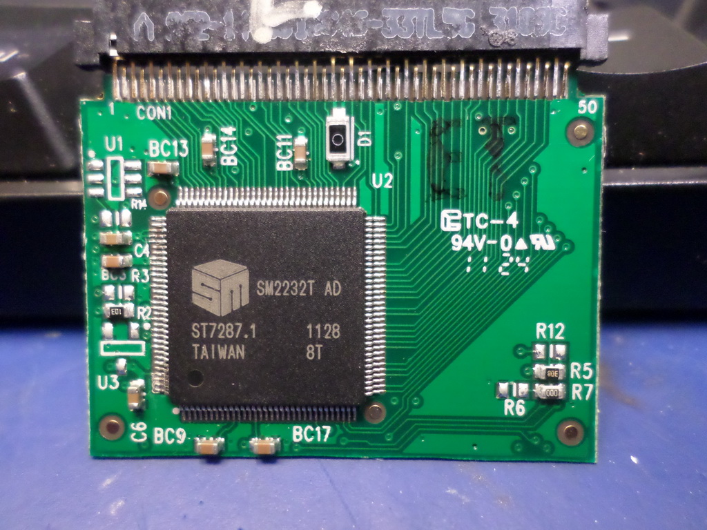

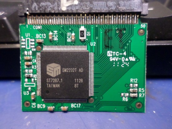

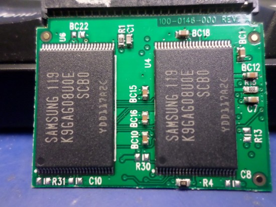

I received this device today Envoy Data 4GB CF, user connected the card upside down and can't access the data, when I look at it, card comes "ready" with capacity of 128GB. I don't own any flash reader as right now, could somebody please guide me to what components I could check to see if I can't get it going?
Thank you

Unfortunately it's not as simple because no way to get layout of PCB and pcb components.
Worth to check resistors (black elements Rx).
Chip-off would be ideal solution here, this controller is pretty simple to recover and good NAND chips (double-crystal package).
[Unite by bytes-->Inversion--> Pair-->Unite by virtual page (1 virt.page = 4 x ph.pages)]. Then Logical Block translation algorithm which is also simple in this controller.
 Post subject: Re: CF 4GB "Envoy Data Corp"
PostPosted: July 3rd, 2014, 16:43
Posts: 17256
The pinout of the CF connector suggests that reversing the connector should still maintain the same positions for the VCC and Ground pins, so one would expect that there should be no catastrophic damage. It only remains to be seen whether the I/O pins can tolerate such a reversal, but experience with 40-pin HDD IDE cables would suggest that they would normally be idiot proof.
http://pinouts.ru/Memory/CompactFlash_pinout.shtml
I can't see that there is much for you to do other than to verify whether +3.3V is present at the NAND chips. To this end you would measure the voltage across C1, C2, C3, C4, or C5.
You should also confirm that the CF card identifies itself correctly in other respects (to confirm that there are no stuck data bits on the IDE interface).
BTW, U5 appears to be reserved for an external +3.3V linear regulator. It is needed by earlier controllers that don't have an internal regulator.
U6 appears to be reserved for a PSU supervisor IC that issues a reset if the supply falls below a certain threshold. I suspect that the SM2232T may have its own internal supervisor logic.

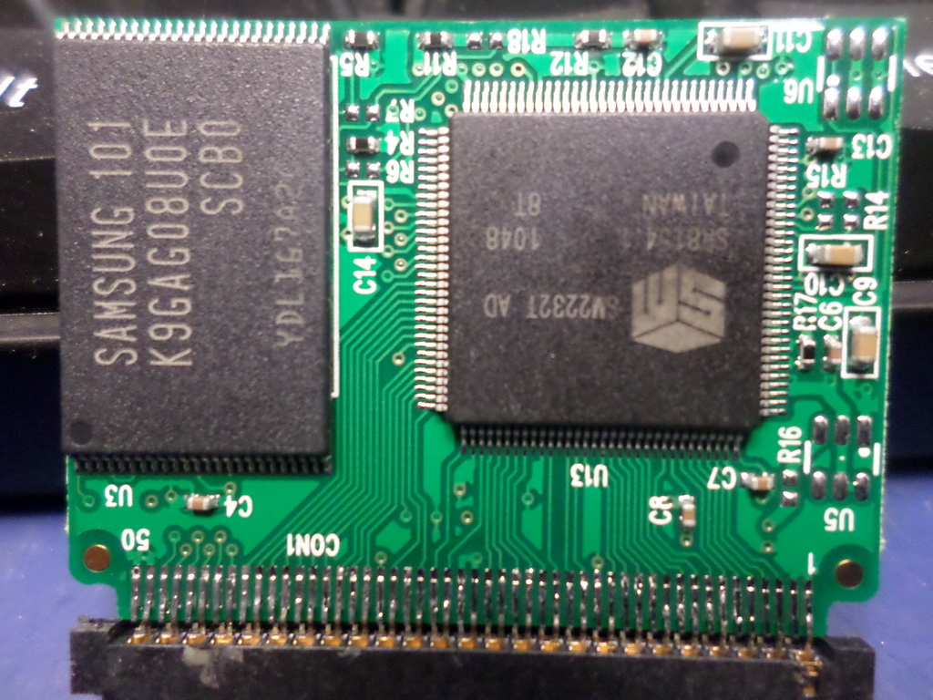

It would take me less than an hour to trace the circuit and come up with a diagram of my own.
The NAND flash pinout appears to be standard:
K9GAG08U0E-SCB0, Samsung, NAND Flash, 2.7V - 3.6V, 16Gbit, 8KB + 436B page size:
http://rln.nnov.ru/uploads/files/k9gag08u0e.pdf
The CF connector pinout is also standard.
I have also found a circuit diagram that might help (even though the controller pinout appears to differ significantly).

Wrong capacity almost certainly means controller firmware damage, I would think a very slight chance that any failed component could exhibit this behaviour, and as Fzabkar says, not much to really check. As Sasha says, chip off recovery is the solution here, if you don't have a NAND chip reader, then you might need to either get one or outsource. For someone with the tools, a very run of the mill recovery, as long as the chip read is good and the controller didn't go "berserk"

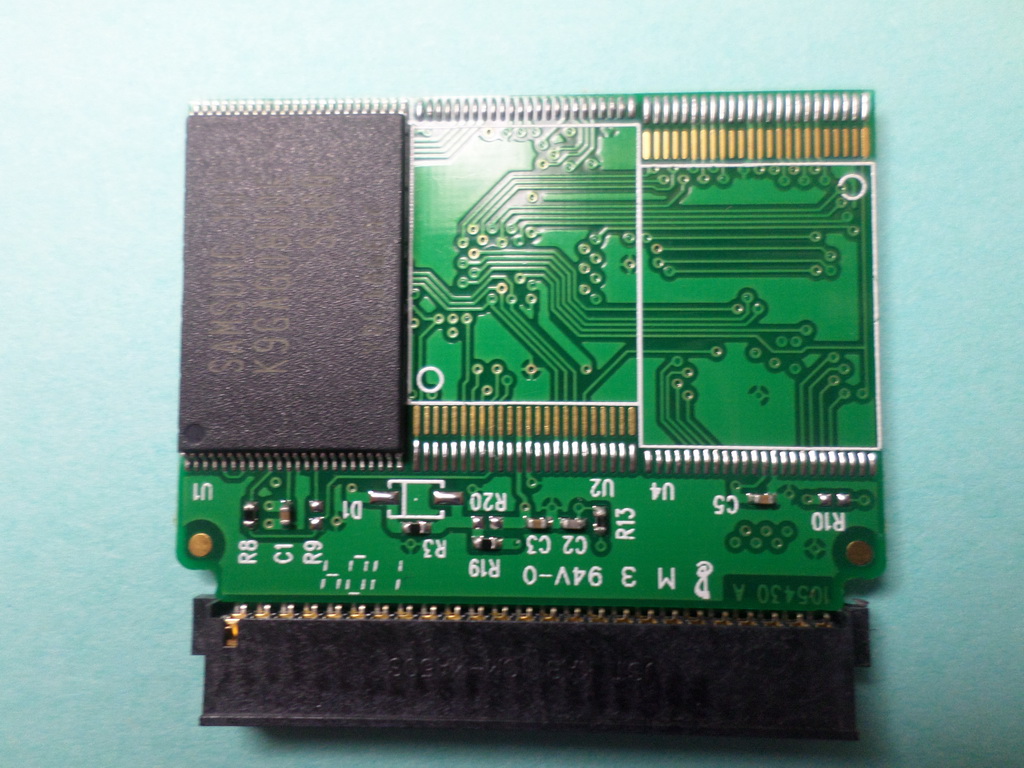

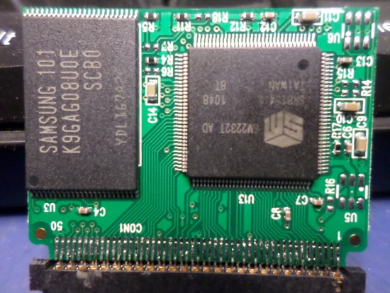

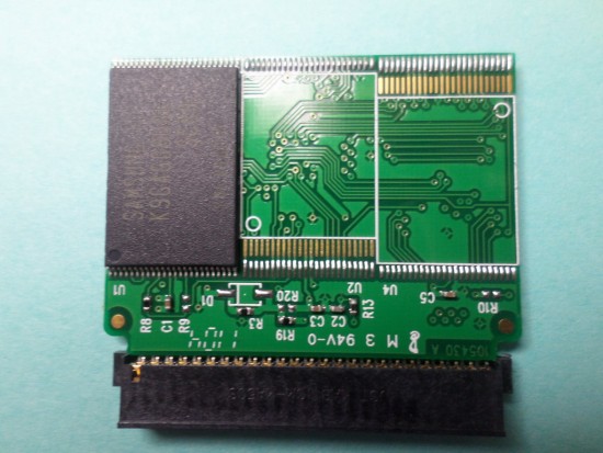

Quick question, I got a part to attempt to xplant the chips, the flash and MCU are the same but the PCB has a different layout, do you guys think the xplant to the part's PCB will work? the difference are the bad card U3 and U1 are populated, on the parts are U4 and U6.
thank you

The PCBs appear to be functionally and electrically identical. The differences in the Ux circuit references are irrelevant. The designer could just as easily have chosen any name, eg IC102.
That said, the PCB manufacturing dates differ by 20 weeks (week 04 of 2011 versus week 24 of 2011), so it could be that the flash controllers have some differences in their embedded firmware (is "ST7287.1" a firmware version or a serial number?) that would cause them to interpret the flash data differently. Moreover, you would need to do some circuit tracing to determine the NAND chip order.
BTW, you still haven't determined the nature of the fault. How do you know which chip is bad?

I agree with pcimage, wait for FE. IMHO, probably chips are fine, data intact or mostly intact. controller firmware/damage the cause.
The difference in PCB could be quite important, such as a slight timing change or to suit the later revision of the controller.
I would say the date codes of controller are are 1048 and 1128 respectively, I doubt you could find any information anywhere if Silicon Motion simply produced chips this whole time exactly the same, or if there were slight revisions. It is possible the number Fzabkar referred to is a serial or revision, but it is not a firmware code. The firmware code is normally on a sticker on a NAND Chip if it is recorded, never printed onto a controller.
Even if exactly the same, very unlikely for a transplant to work, as the firmware would almost certainly be different, and even if it wasn't, during the process of Envoy getting the device ready with the mass Production tools, the tools have many configuration settings that match to the device/NANDs and I would highly doubt you could use a donor board and controller on the patient NANDS, and transplanting all chips if PCB is not exactly the same is going on a hope and pray.. Also, a controller like that is not a piece of cake to transplant!
The date codes I was referring to are those printed on the PCB.
As for the other numbers, I found a few images:
http://flash-extractor.com/library/SM/S ... a__2x1.jpg
http://www.flash-extractor.com/forum_old/files/cf.jpg
http://www.flash-extractor.com/forum_ol ... g_1319.jpg
SR1442.1 1030 SM2232T AD
SR2262.1 1032 SM2232T AD
SR8153.1 1048 SM2232T AD
SR8154.1 1048 SM2232T AD
ST7287.1 1128 SM2232T AD
It appears that the "ST" number may be a batch code rather than a firmware version. Maybe the "AD" is related in some way to the embedded ROM code???
