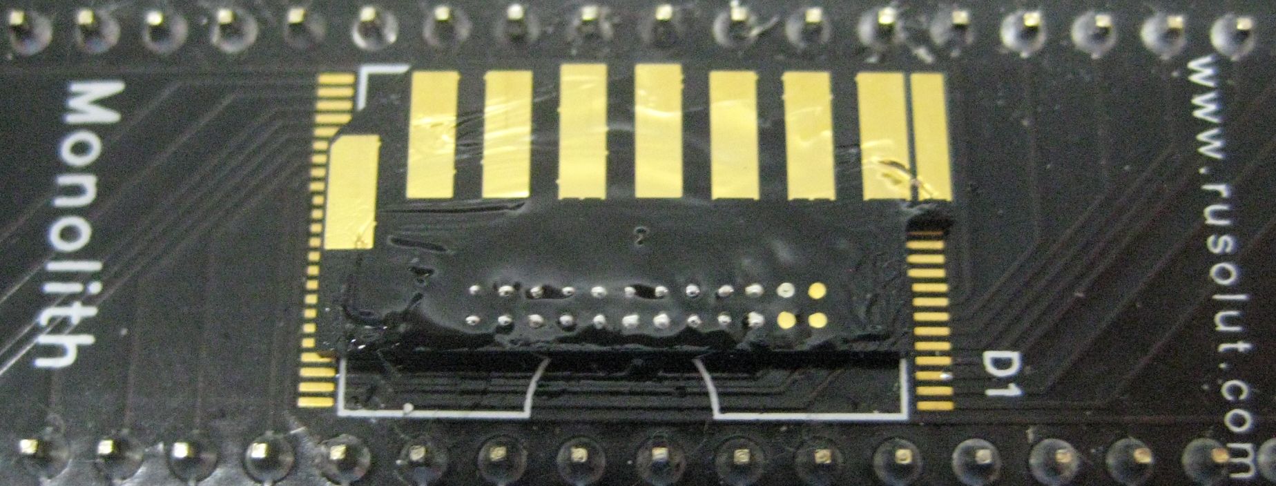

Hi, everyone!
Please advise if the pinout of this monolith from Toshiba SD card might be the same as the one with the 27pin SD?
File comment: already with flux on it:)

are you referring to SanDisk ones? if so then I don't know, but maybe test like the following:
Label each pin across as column a,b,c,d etc, and rows 1 and 2.
test pin F1 and see if it is VCC, and test pin K1 and see if it is GND.
if not, test with GND on SD pads, and find GND on test pins. see if pinout lines up at all.
the last 3 cols for the 27pin SD are for 16-bit bus, so you might be lucky.

Yep, it`s flux :D But the card itself was ridden over by a car several times and spent a day in water, but there`s no any visible damage. Do you think it is recoverable?
I tried to test the pins but no luck

If you find the ground of the SD pins, using continuity test, are any of the test pins also Gnd? same with vcc?

I have found no GND or VCC, tested all the pins :(

So Sandisk pinout will not fit.
