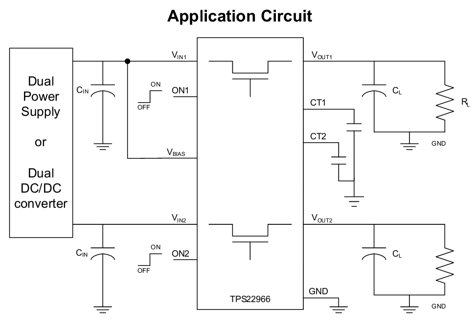

The 14-pin IC adjacent to V1 and V3 could be a TPS22966. I would check the two Vouts.
TPS22966, Texas Instruments, 5.5V, 6A, 16-mohm ON-Resistance Dual-Channel Load Switch, marking RB966:
http://www.ti.com/lit/ds/symlink/tps22966.pdf

14 PIN
Vout1 1,81Vdc
Vin1 1.81Vdc
Vout2 1.26Vdc
Vin2 1.26Vdc
Bias 5Vdc
http://forumbilder.se/G82V8/singleshot0000
Looks quite suspicious that the Vin and Vout are the same at the 14pin IC?

RB966 is a switch, so Vout = Vin. All the voltages look OK.
