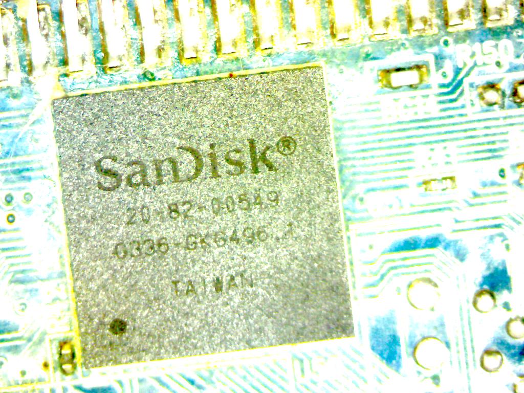

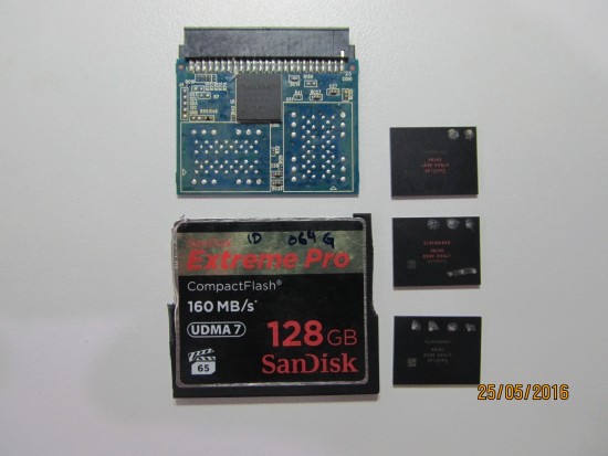

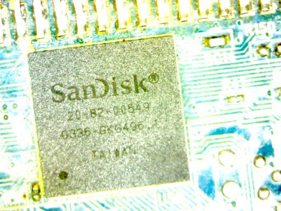

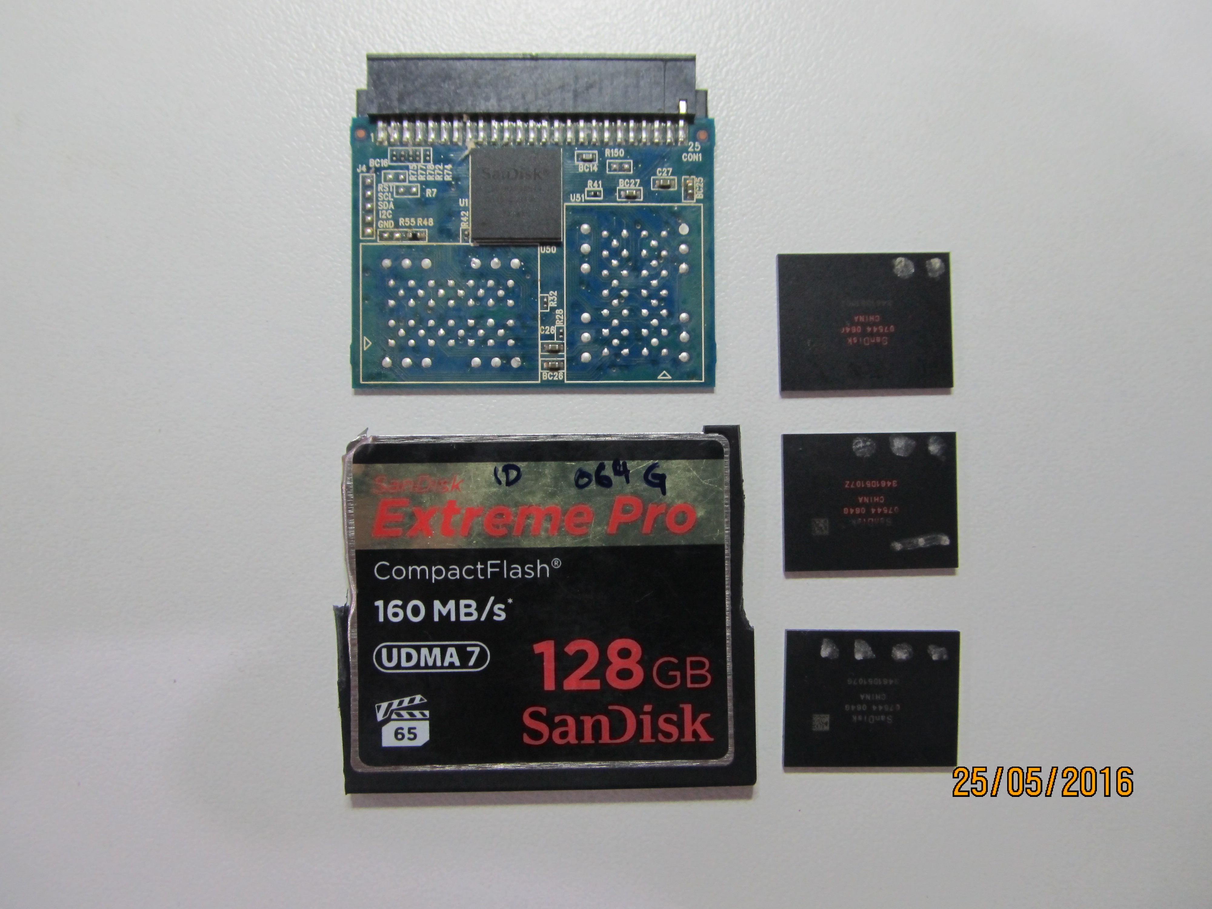

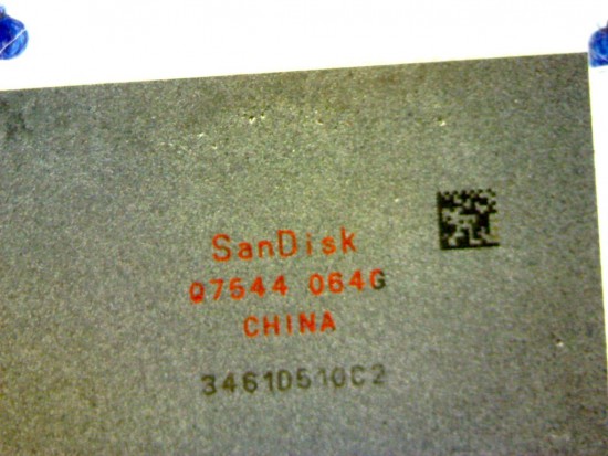

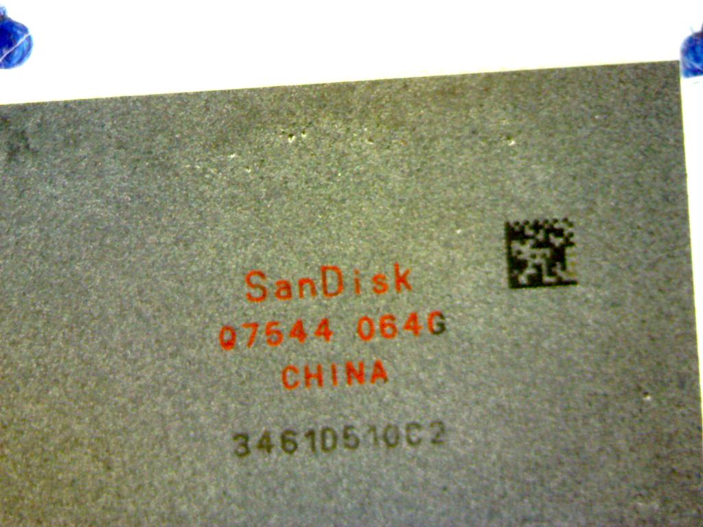

is it encrypted? i asked few friends about it and some of them said: some models are YES
anyone tried this model?
Chip: Sandisk 07544 064G
Chip ID: 45 3A 95 93
Controller: 20-82-00549

No. This controller not crypt data. Usually it is rebranded SM controller.

Generally this is to be told with the card or the dump on hands, but chances are that proper translator-based reassembly won't be possible.
We mostly get these of 64 GB capacity, but worked with the larger ones as well.
What kind of data you're looking to recover? Photos should be pretty recoverable, but videos will be PITA to get back.
And yes, that's not SanDisk, but relabeled SM2236. Memory chips are Toshiba and relabeled as well. Check the number of memory banks in the chip.
P.S.
And where's one more chip?

Agree, not encrypted.
We have done many 32gb and 64gb versions but not yet 128gb. :-)

@ Dmitri 4 chips 4 banks
@ pcimage me too
@ arvika Images required only
