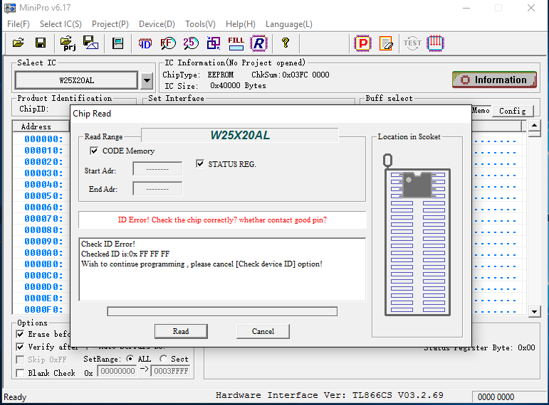

i am trying to program rom using tl866 universal programmer
on wd drive pcb 771672-004
ic no: winbond 25X20ALNIG
please help me where i am making mistake. programmer not reading the ic
 Post subject: Re: help! Rom recovery using tl866 programmer
PostPosted: August 28th, 2016, 10:02
Posts: 1388
Location: isreal
Have you tried to read it out of the circuit ?
PostPosted: August 28th, 2016, 10:17
Posts: 713
Location: Brazil
Are you sure the socket or the clip are the right way ? My old eeprom burner informs a FF FF FF FF id when the chip is upside down.

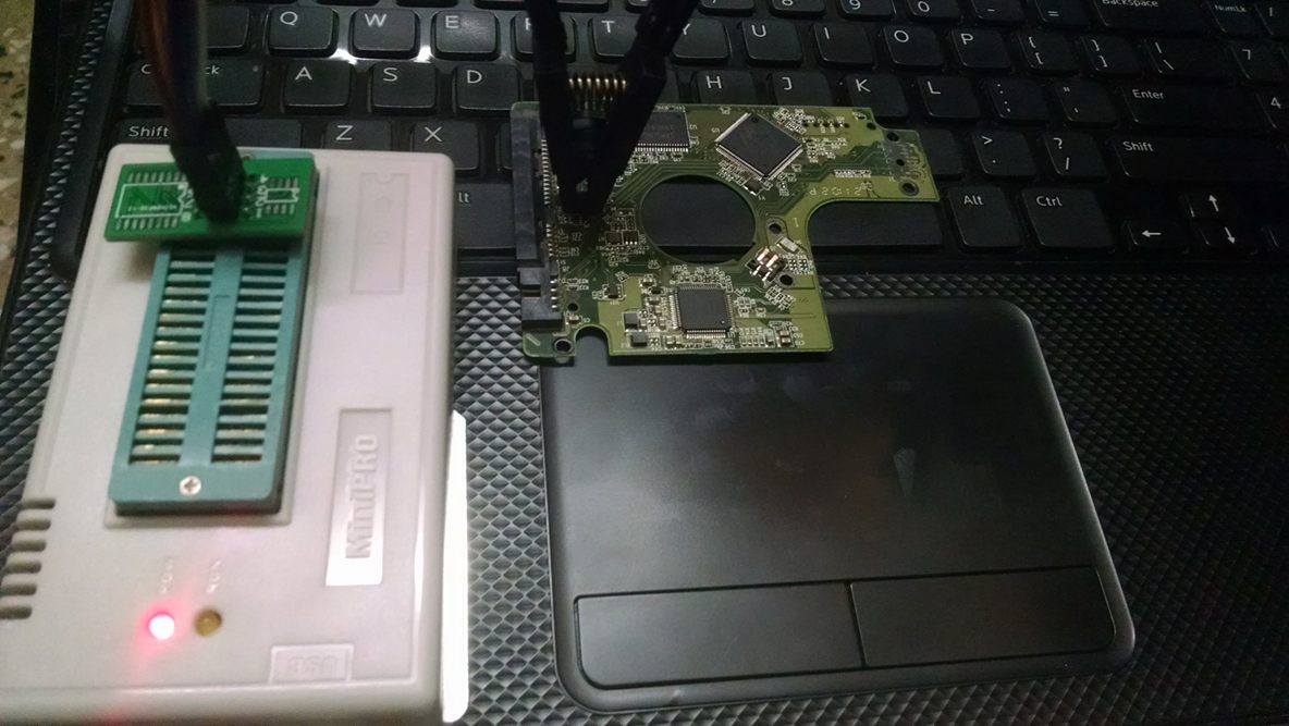

PostPosted: August 28th, 2016, 10:52
Posts: 738
Location: Ottawa, Canada
The adapter is inserted the wrong way around. The "1" needs to be at top-left, although it looks like the red lead is connected to pin 1 of the reader so double-check that the red lead of the clip is connected to the red dot on the IC.

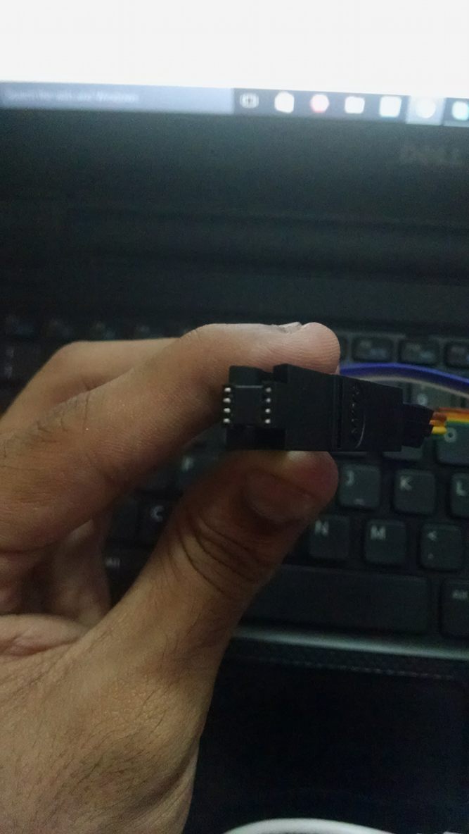

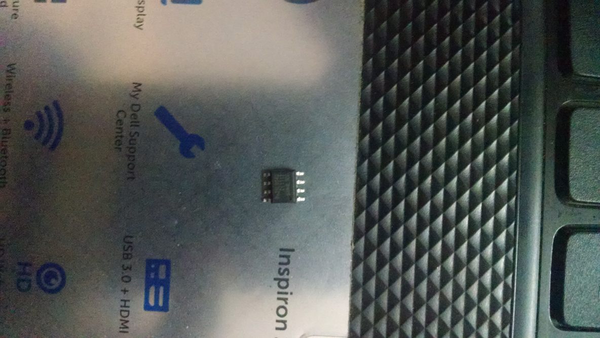

i insert the adapter as you told. but still getting same error
it is not reading it.
here is the situation please help

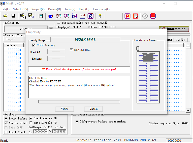

now this error encountering
PostPosted: August 28th, 2016, 15:51
Posts: 1388
Location: isreal
earlier you wrote:
Why have you selected now W25X16AL ?
Select W25X20AL
remove the V from check device ID
then read it

can you please tell me which adapter is suitable for seagate 2.5 hdd rom??
i dont want to sold ic i want adopter like that i am using now. this adapter is not working fine with seagate 2.5 hdd.
PostPosted: August 29th, 2016, 4:24
Posts: 186
Location: Germany
On your screenshot you have W25X16AL selected which is different to chip that you told us.
All you need to do is select the correct model and it should read fine.
By the way where did you get that clip device so you don't have to de-solder?

So how did you get to Seagate ?
this solution is solved thanks.
i was selecting the wrong chip model.
i also want to write rom in seagate 2.5 that is why i am asking. i dont want to sold the ic i want to do it directly.
this adapter isnt working on seagate 2.5 because ic is different.
i hope you got me now.

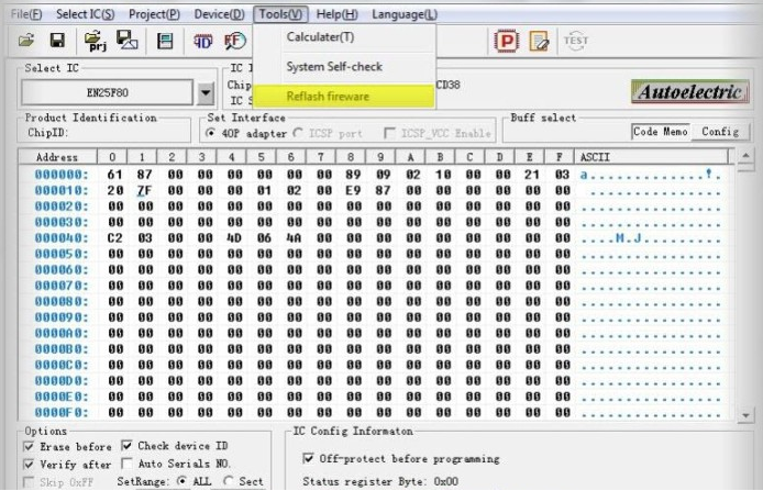

PostPosted: August 30th, 2016, 1:29
Banned User
Joined: August 12th, 2016, 12:54
Posts: 55
Location: US
Can you must work Reflash Firmware tl866
I am from cuudulieuocung.org and I am currently banned from this forum for creating multiple accounts to promote my crappy website.
PostPosted: August 30th, 2016, 7:19
Posts: 186
Location: Germany
Are you talking about the flat Winbond chips? They are almost on every 2.5" drive not just Seagate.
Can't see why you can't solder some BGA balls on the sides of the chip then use your clip device.
Web: https://www.day1data.de
