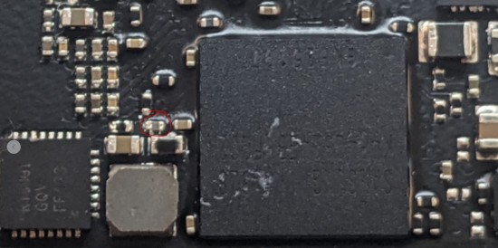

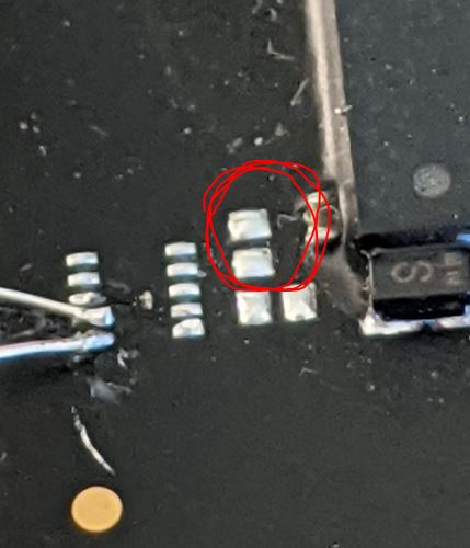

Have an SSD from a Macbook Pro here that just gets hot and isn't recognized. Model is Samsung MZ-JPU256T/0A6. It went through ultrasonic cleaning already.
Attached are photos of an IC and area where I noticed corrosion. The IC is marked:
PSRI
4AK
A7HE
I believe it is this: http://www.ti.com/lit/ds/symlink/tps61086.pdf
Can anyone confirm this for me? None of those caps are short. Not too sure where to start otherwise.

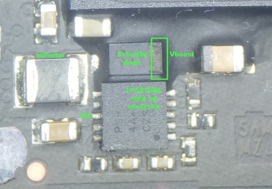

I believe you have correctly identified the IC. I would measure the boosted output voltage.

I'm getting 11.95v. Known good measure 12.43v. Resistance to ground measure about the same, so I don't think it is short -- but would .5v be enough to make a difference?
 Post subject: Re: Apple SSD (Samsung MZ-JPU256T/0A6) liquid damage
PostPosted: December 5th, 2016, 19:37
Posts: 17256
I'd be surprised if the difference was of any consequence.

JGAN wrote:
Any ideas on where to possibly go from here?
Examine the other chips?
Look for a serial diagnostic port?
JTAG port?

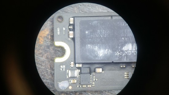

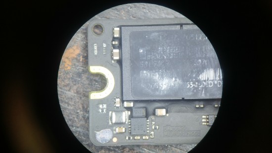

I got two like this. Power looks ok, they got DRD- DSC but then get BSY as soon as I try doing something. One had liquid, the other one was working with USB adapter and stopped working.

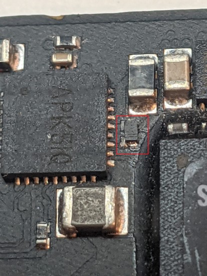

I've been looking at the board the only suspicious components I can find is this coil, It's open with probe on each side.
