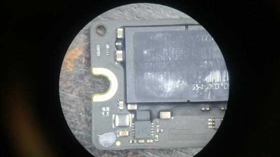

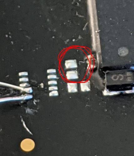

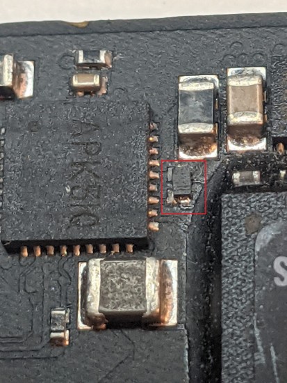

 Post subject: Apple SSD (Samsung MZ-JPU256T/0A6) liquid damage
PostPosted: November 18th, 2016, 18:13
Joined: November 27th, 2012, 21:59
Posts: 94
Location: Upstate NY, USA
Have an SSD from a Macbook Pro here that just gets hot and isn't recognized. Model is Samsung MZ-JPU256T/0A6. It went through ultrasonic cleaning already.
Attached are photos of an IC and area where I noticed corrosion. The IC is marked:
PSRI
4AK
A7HE
I believe it is this: http://www.ti.com/lit/ds/symlink/tps61086.pdf
Can anyone confirm this for me? None of those caps are short. Not too sure where to start otherwise.
YVmrEsa - Imgur.jpg
YVmrEsa - Imgur.jpg [ 4.57 MiB | Viewed 19248 times ]
w7lWe4b - Imgur.jpg
w7lWe4b - Imgur.jpg [ 4.66 MiB | Viewed 19248 times ]
 Post subject: Re: Apple SSD (Samsung MZ-JPU256T/0A6) liquid damage
PostPosted: November 18th, 2016, 18:46
Joined: November 27th, 2012, 21:59
Posts: 94
Location: Upstate NY, USA
Also are the flex cables for M.2 or Apple SSD so that you can probe both sides of the board while its plugged in?
 Post subject: Re: Apple SSD (Samsung MZ-JPU256T/0A6) liquid damage
PostPosted: November 18th, 2016, 18:56
Posts: 17134
I believe you have correctly identified the IC. I would measure the boosted output voltage.
Vboost.jpg [ 189.59 KiB | Viewed 19241 times ]
 Post subject: Re: Apple SSD (Samsung MZ-JPU256T/0A6) liquid damage
PostPosted: December 5th, 2016, 19:20
Joined: November 27th, 2012, 21:59
Posts: 94
Location: Upstate NY, USA
I'm getting 11.95v. Known good measure 12.43v. Resistance to ground measure about the same, so I don't think it is short -- but would .5v be enough to make a difference?
 Post subject: Re: Apple SSD (Samsung MZ-JPU256T/0A6) liquid damage
PostPosted: December 5th, 2016, 19:37
Posts: 17134
I'd be surprised if the difference was of any consequence.
 Post subject: Re: Apple SSD (Samsung MZ-JPU256T/0A6) liquid damage
PostPosted: December 5th, 2016, 22:01
Joined: November 27th, 2012, 21:59
Posts: 94
Location: Upstate NY, USA
Any ideas on where to possibly go from here?
 Post subject: Re: Apple SSD (Samsung MZ-JPU256T/0A6) liquid damage
PostPosted: December 5th, 2016, 23:27
Posts: 17134
JGAN wrote:
Any ideas on where to possibly go from here?
Examine the other chips?
Look for a serial diagnostic port?
JTAG port?
 Post subject: Re: Apple SSD (Samsung MZ-JPU256T/0A6) liquid damage
PostPosted: January 15th, 2022, 13:37
Joined: December 14th, 2020, 11:51
Posts: 57
Location: France
I have a similar case. Where you able to recover data ? VBoost is 12.45V on mine.
Claude
 Post subject: Re: Apple SSD (Samsung MZ-JPU256T/0A6) liquid damage
PostPosted: February 1st, 2022, 8:26
Posts: 191
Location: Switzerland
I got two like this. Power looks ok, they got DRD- DSC but then get BSY as soon as I try doing something. One had liquid, the other one was working with USB adapter and stopped working.
 Post subject: Re: Apple SSD (Samsung MZ-JPU256T/0A6) liquid damage
PostPosted: February 10th, 2022, 12:59
Posts: 191
Location: Switzerland
My findings to get into ROM mode but that's not very helpful in my case.
ROM_Mode_Apple_SSD.JPG [ 34.4 KiB | Viewed 12219 times ]
 Post subject: Re: Apple SSD (Samsung MZ-JPU256T/0A6) liquid damage
PostPosted: February 10th, 2022, 13:02
Posts: 191
Location: Switzerland
I've been looking at the board the only suspicious components I can find is this coil, It's open with probe on each side.
Coil_ssd.JPG [ 139.1 KiB | Viewed 12219 times ]
 Post subject: Re: Apple SSD (Samsung MZ-JPU256T/0A6) liquid damage
PostPosted: February 10th, 2022, 13:13
Posts: 191
Location: Switzerland
What is this ? Diode ?
WhatsApp Image 2022-02-10 at 18.10.32.jpeg
WhatsApp Image 2022-02-10 at 18.10.32.jpeg [ 540.6 KiB | Viewed 12218 times ]
