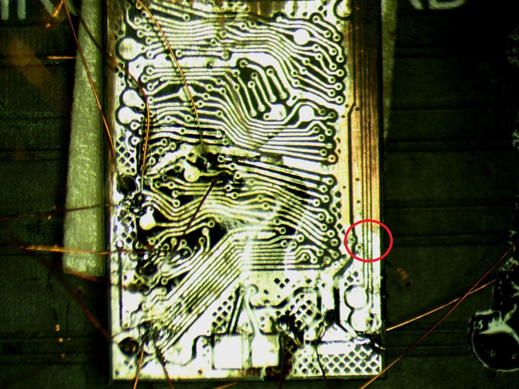

I have a Micro Center UFD Monolith that keeps giving me the ID 86 84 24 5F.
I have wired her up a few times and always get the same ID.
Anyone seen that ID before?
 Post subject: Re: ID 86 84 24 5F
PostPosted: April 11th, 2019, 13:16
Posts: 922
Show photo of monolith.
PostPosted: April 11th, 2019, 13:32
Posts: 1777
Location: Phoenix, AZ USA
Here you go.

I think ID should be 0x88 0x89 0x28 0x5F
wiring looks like correct pinout used.
is this point broken?
Maybe go over the whole thing with microscope and look for any solder bridges or balls fallen onto PCB or cracks.

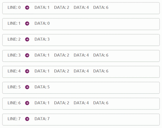

I just tried this NAND ID decoder:
https://multi-recovery.com/decoder_beta.php
Found ID: 89 88 28 5F

As you aren't really using a LA, the "LINE" name isn't quite right, but call the pads LINE:0 , 3 , 4 & 6.
theoretically, when you ID 89 88 28 5F, you should have it wired correctly. But still not convinced nothing is wrong with the monolith!
24 possible combos:
(pad)  :     (wire D1, D2, D4, D6 from reader)
LINE:0 : 1 2 4 1 2 4 4 2 6 4 2 6 6 1 4 6 1 4 2 1 6 2 1 6
LINE:3 : 2 1 1 4 4 2 2 4 4 6 6 2 1 6 6 4 4 1 1 2 2 6 6 1
LINE:4 : 4 4 2 2 1 1 6 6 2 2 4 4 4 4 1 1 6 6 6 6 1 1 2 2
LINE:6 : 6 6 6 6 6 6 1 1 1 1 1 1 2 2 2 2 2 2 4 4 4 4 4 4
Theoretically you should be able to keep trying wire combos until ID is 89 88 28 5F. If the actual die is not 89 88 28 5F, then I'm not sure what you can do!
still not convinced nothing is wrong with the monolith though. Also, there could well be a change in pin order on the die, making the pinout different but in physical same locations (switching data lines) like we are seeing on some SD Cards
regarding the capacity conflict.. there could be a CE1 and maybe a RB1 as well somewhere, presenting the second crystal
or it could just be stuffed!
