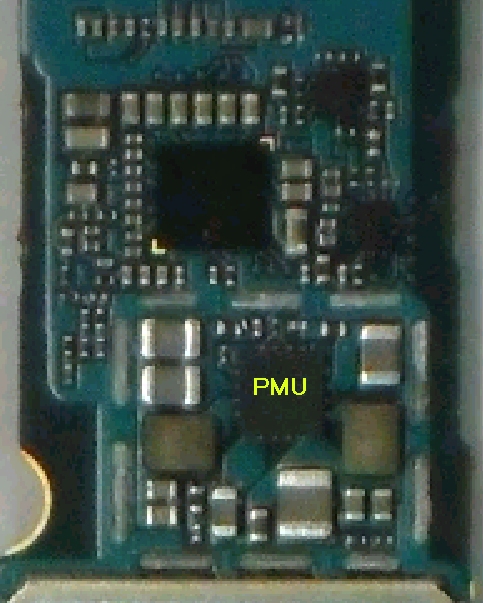

Hi guys!
Have a dead SCV32 (Galaxy A8).
Of course there are a lot of options before chip-off as repairing and what not,
but at the moment wondering where the memory chip is?
On S6 it is above Shannon 333 baseband (to the left from CPU), but this time it is just empty space.
Is it inside CPU Exynos 5433?
Searched the WEB, no info.
Please advise...

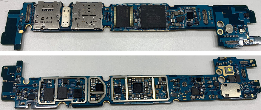

It's not the same PCB, but it has a Samsung KMQ310013M eMCP (EMMC+LPDDR3 16GB+2GB).
Samsung Galaxy A8 Teardown:
http://www.myfixguide.com/manual/samsung-galaxy-a8-teardown/

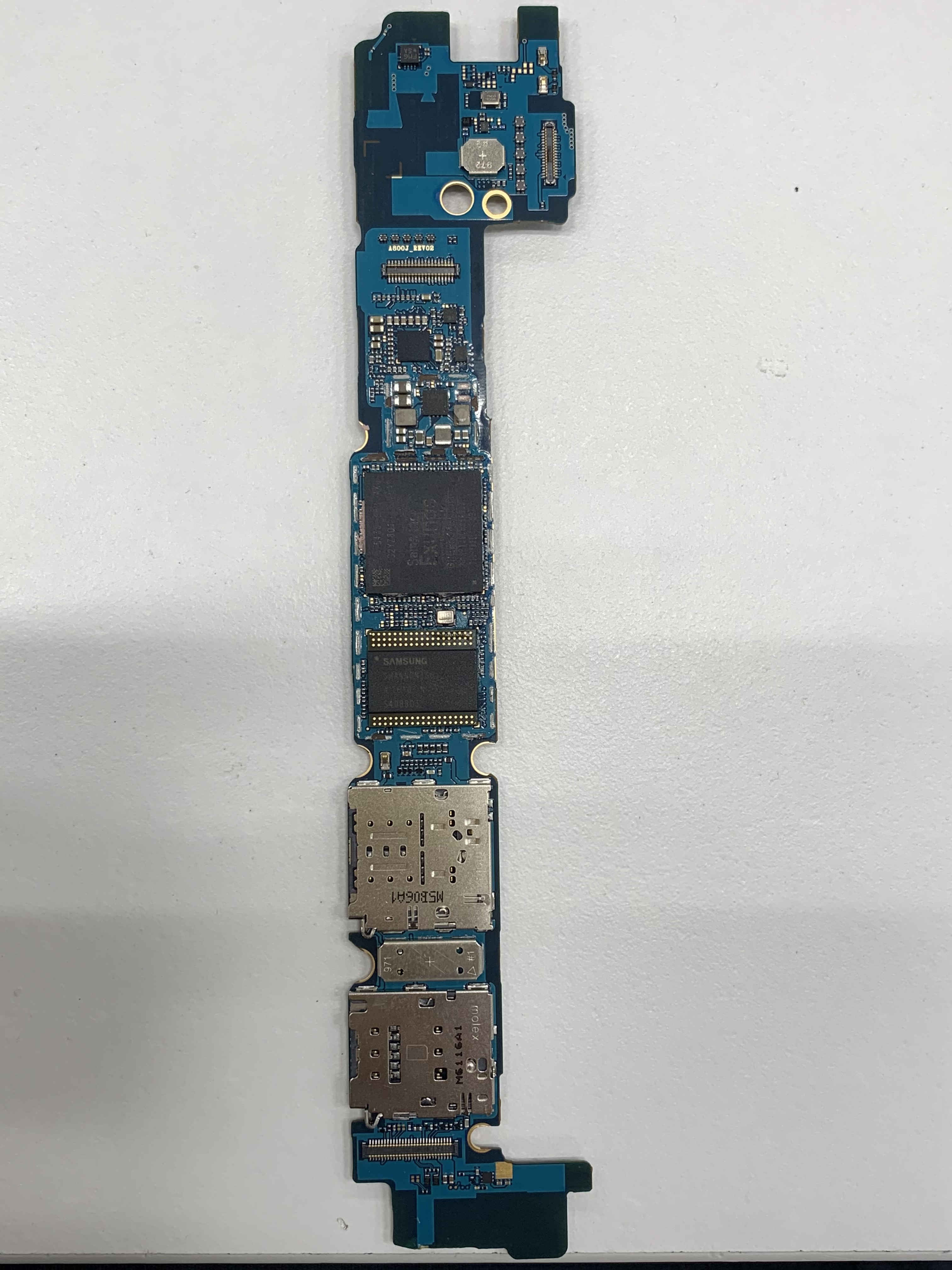

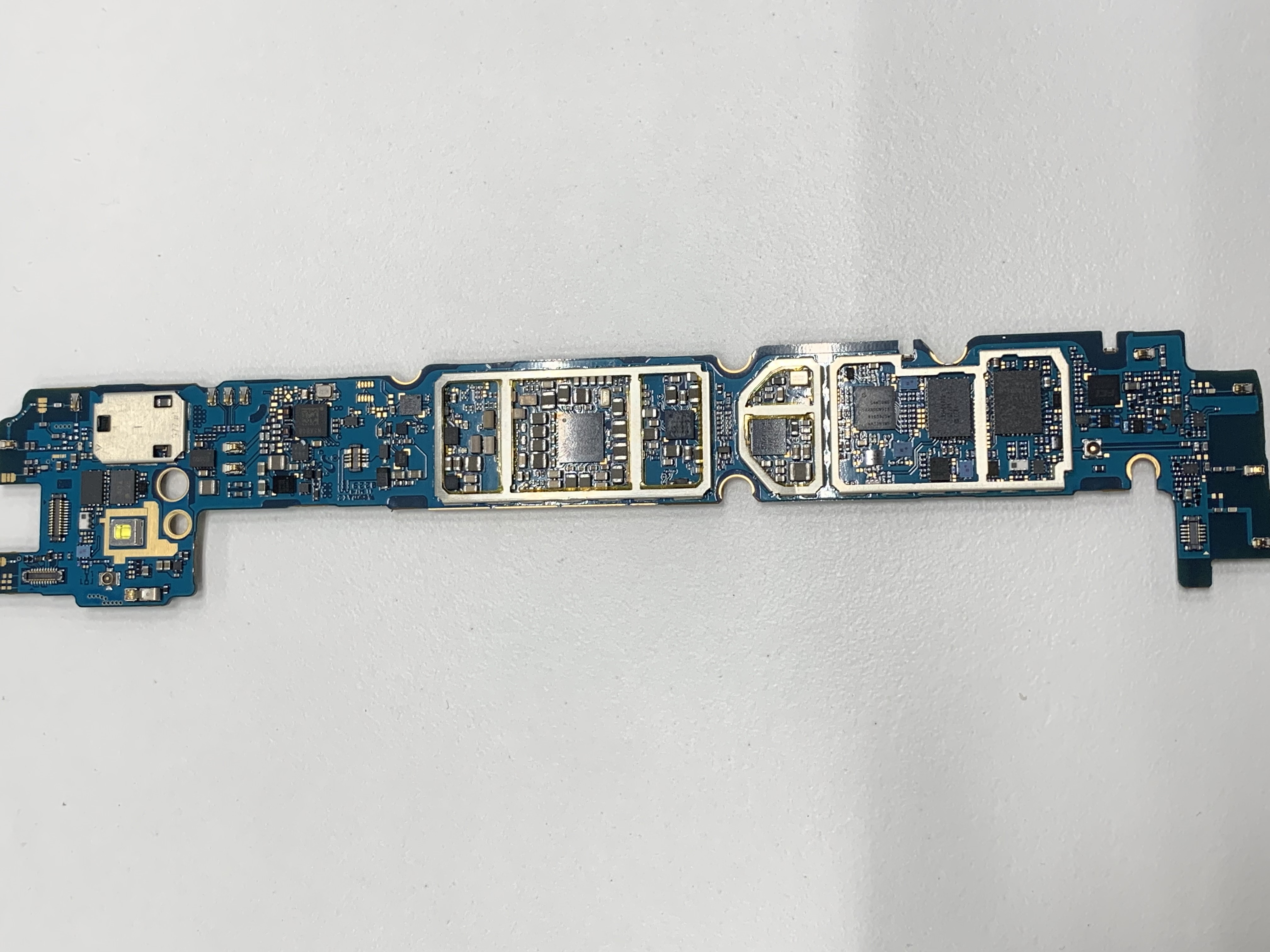

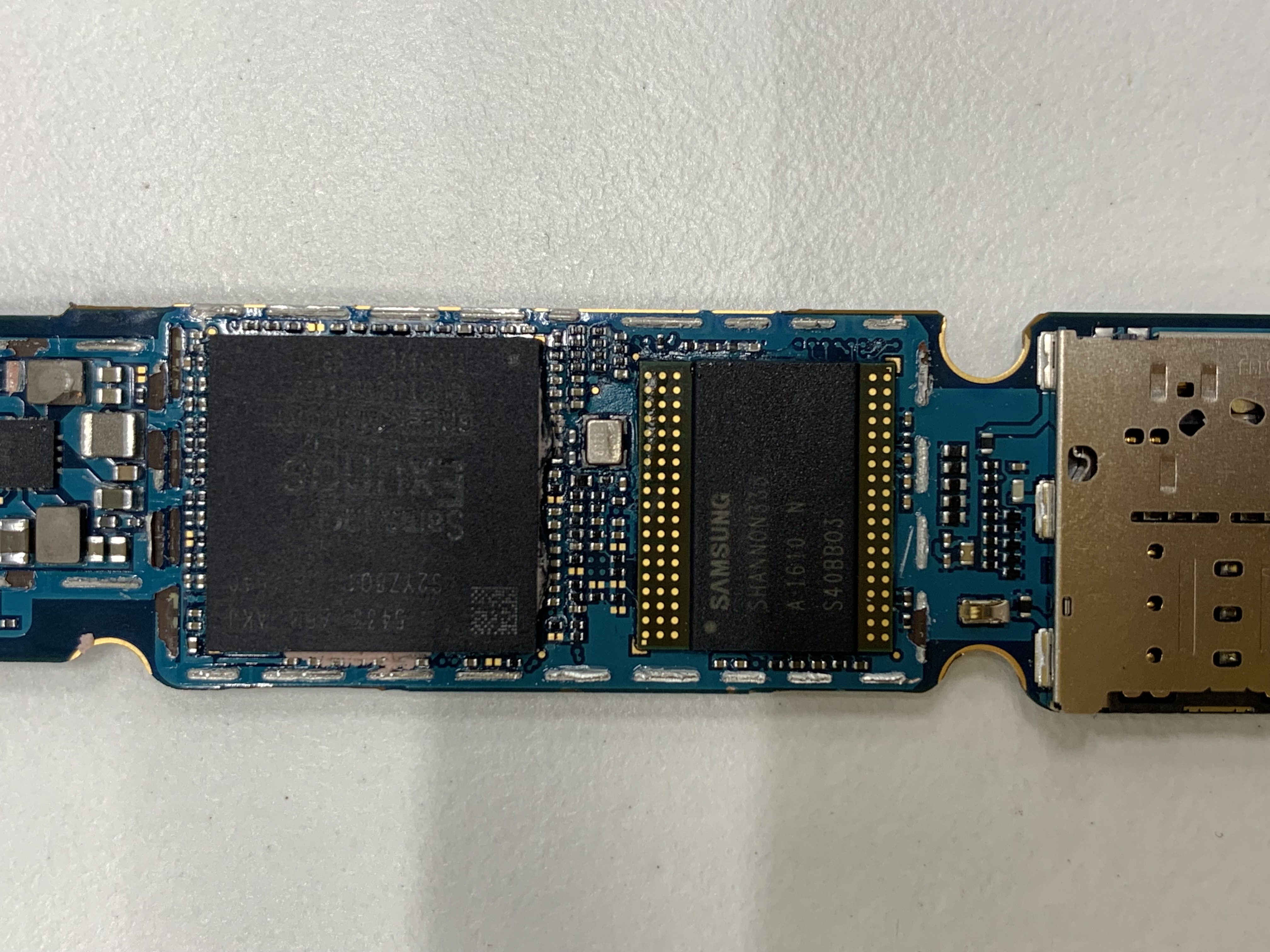

Uploaded some more photos.
And found this...without any new info about the memory
https://fccid.io/A3LSCV32/Internal-Phot ... to-2818832

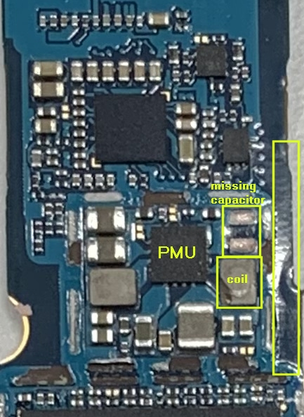

There is some physical damage around one of the power management ICs. Could it possibly be an easy fix?

The processor and eMCP are stacked on top of each other.
https://www.techinsights.com/blog/samsung-galaxy-note-4-alpha-teardown

Why not fix the damage instead of a chip-off, or did you damage the PCB while removing the PMU cover?
There should be two part numbers on the multi-chip. One is the CPU (5433), the other is the eMCP.
