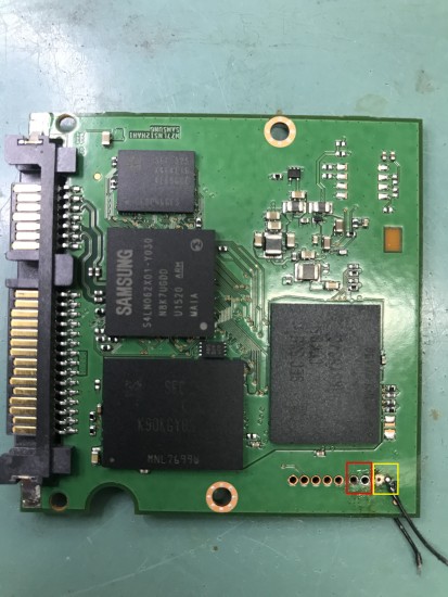

Anyone know the shorting point or work around for Samsung 850EVO S4LN062 i think its Samsung PM871 Lenovo
Either the terminal is locked or not supported by PC3000 ssd?
File comment: RED marking shorting points, but it doesn't work. Yellow marking terminal comm

Yes, red should be the shorting point, and yellow the terminal. What is the behaviour you get? Are all other voltages correct? Do the chips get warm or hot when powered?

Voltage test points for similar PCBs:
https://forum.hddguru.com/viewtopic.php?t=35276
https://forum.hddguru.com/viewtopic.php?p=269636
https://forum.hddguru.com/viewtopic.php?t=37331
https://forum.hddguru.com/viewtopic.php?t=34999

Just get an error from PC3000 shorting is not successful, i think this is terminal lock
How can you say that without measuring anything?

Does it come up on SATA when you short the 2 pins and power it up?
It should provide a RAM-disk on SATA with approximately 80% of the RAM size as the disk size.
