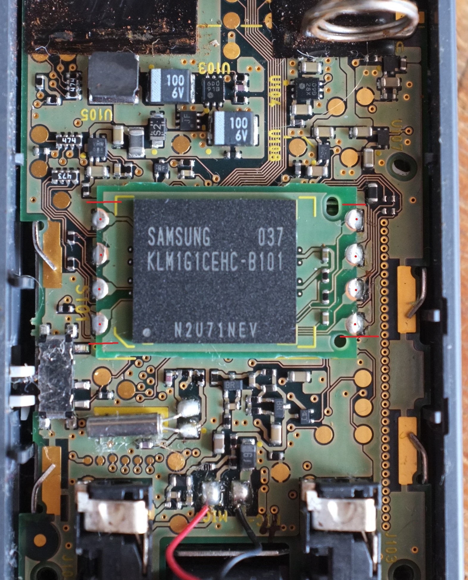

Hi there,
Thanks for the reply. In this case the customer requires deleted data from the voice recorder. This was deleted shortly before the voice recorder failed. There is an 'erase' button which is quite prominent and it will format the device if depressed.
This particular voice recorder has no USB interface so there would not be a straight forward way to get the device into a mass storage mode to attempt the recovery of the deleted files.
Given what you have noted regarding this chip being eMMC and wiring in as per a SD I wonder if the areas I have highlighted in red on the attached image are likely to be leading into the appropriate pins for the SD connection?

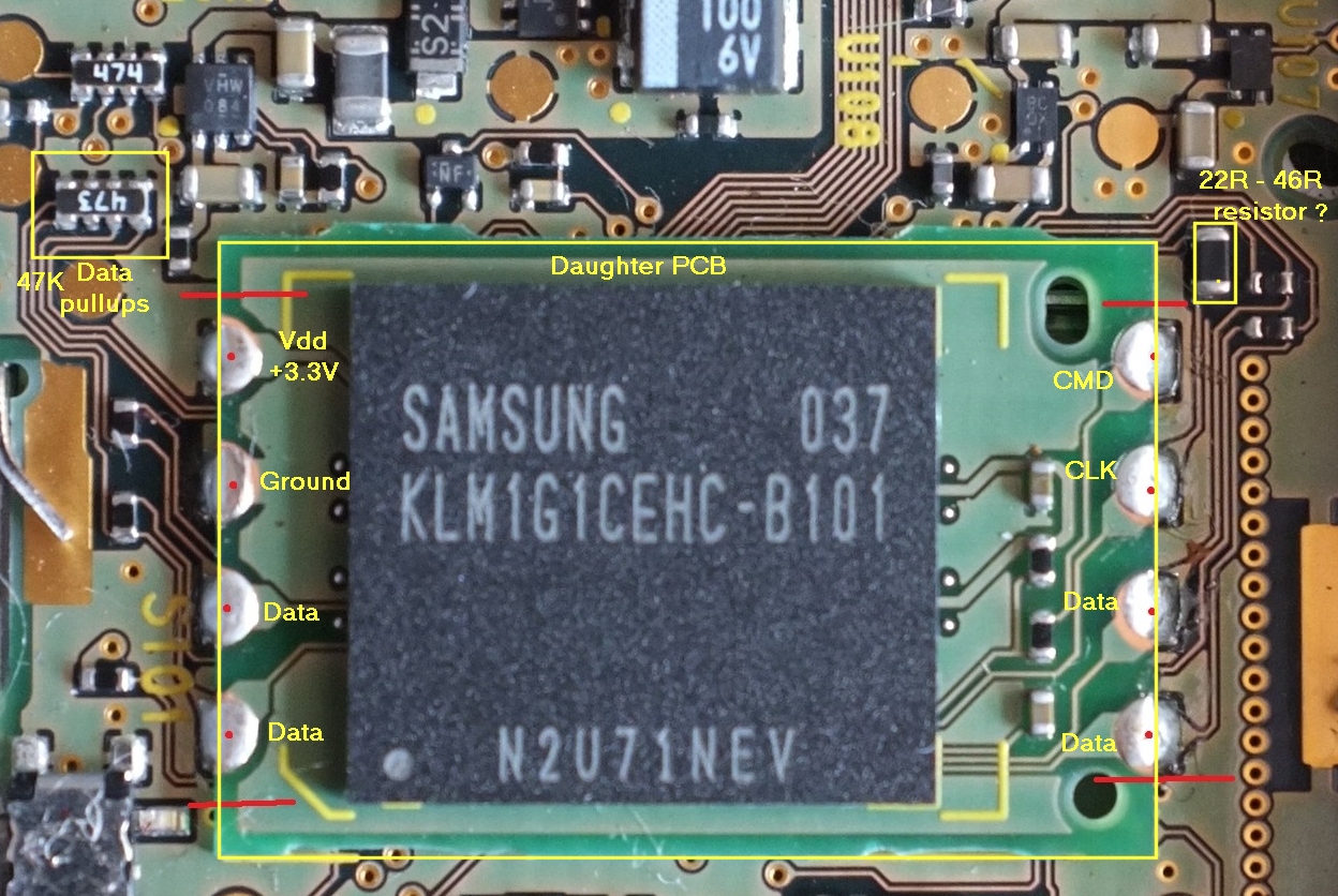

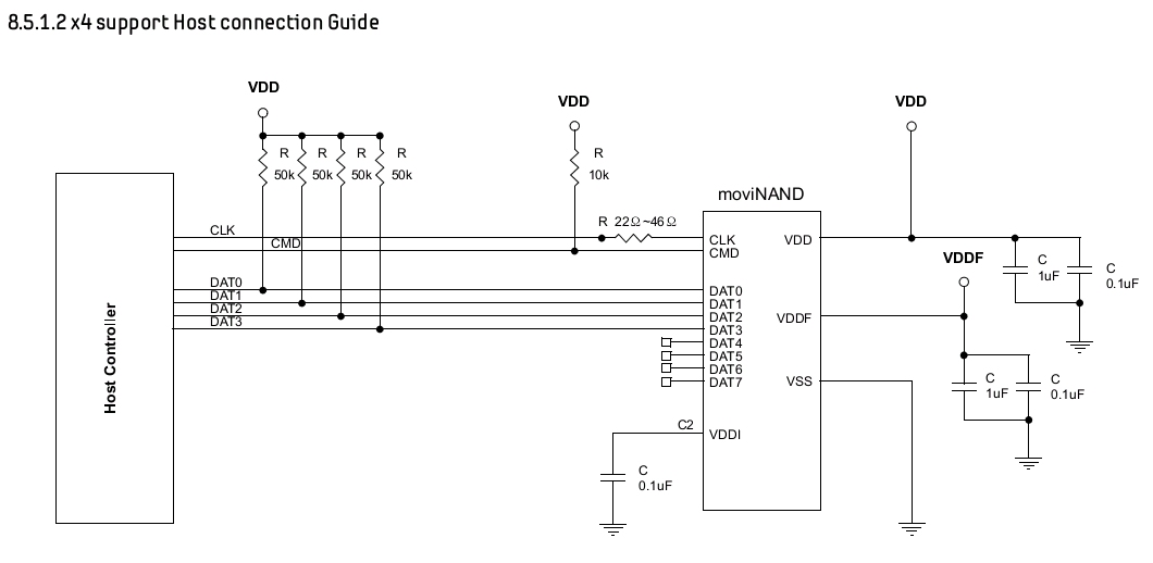

The SAMSUNG moviNAND is an embedded MMC solution designed in a BGA package form. moviNAND operation is identical to a MMC card and therefore is a simple read and write to memory using MMC protocol v4.3 which is a industry standard. moviNAND consists of NAND flash and a MMC controller. 3V supply voltage is required for the NAND area (VDDF) whereas 1.8V or 3V dual supply voltage (VDD) is supported for the MMC controller.
You don't need to remove the chip. You only need to remove the daughter PCB that it sits on. Just treat the daughter PCB as an MMC card.
ISTM that the chip is configured in 4-bit mode with a single 3.3V supply. I would confirm that the +3.3V and Ground pins are correctly identified by measuring their voltages in-circuit.
The order of the data pins (DAT0 - DAT3) is not clear to me, but I would expect that they would be sequential. AFAICT, you won't damage anything if you get the order wrong.
Measure the resistance of the CLK resistor. That should confirm the identity of the CLK pin.
BTW, the model number of the voice recorder may help us to locate a service manual and/or a circuit diagram.
