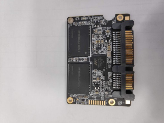

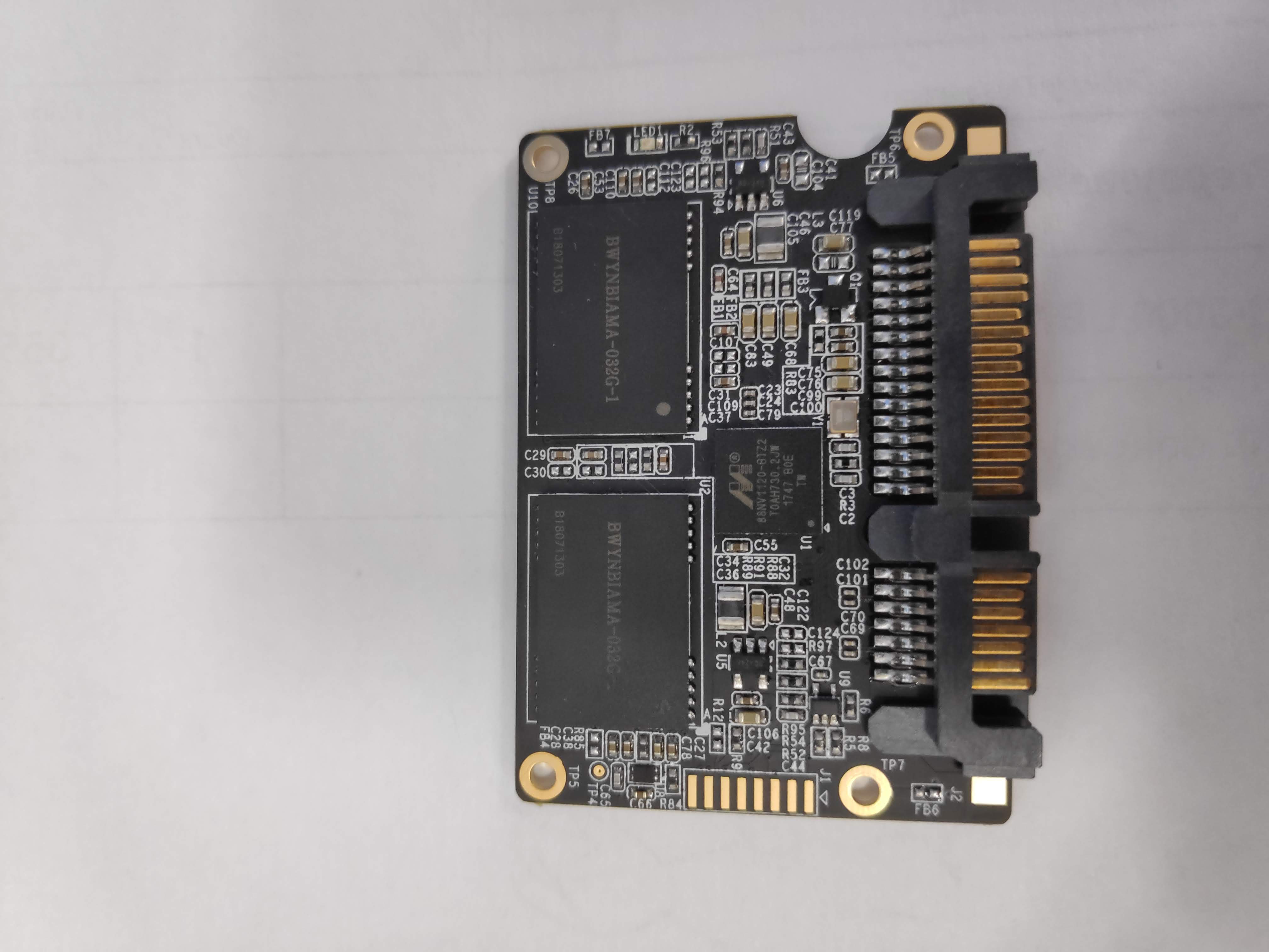

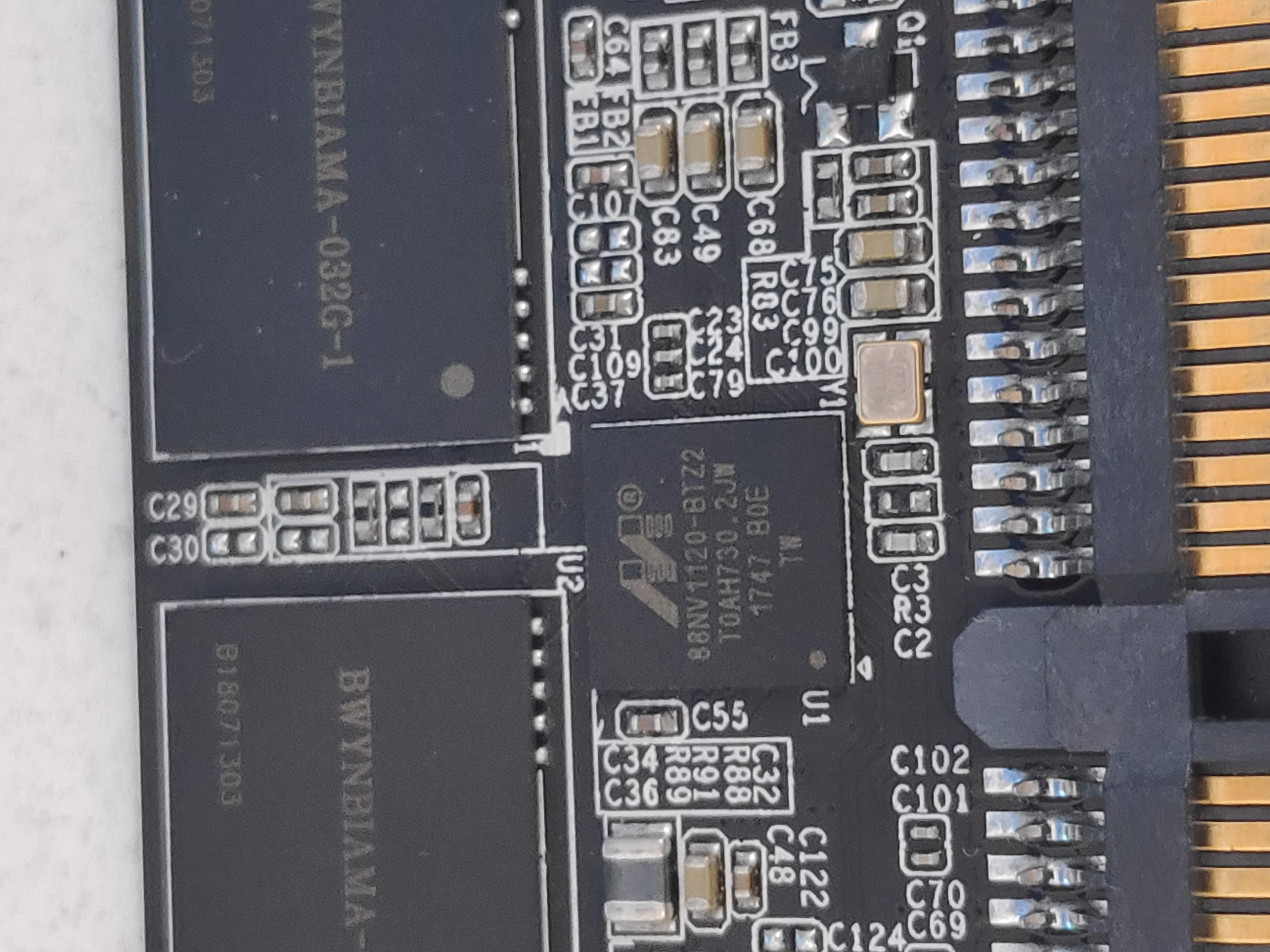

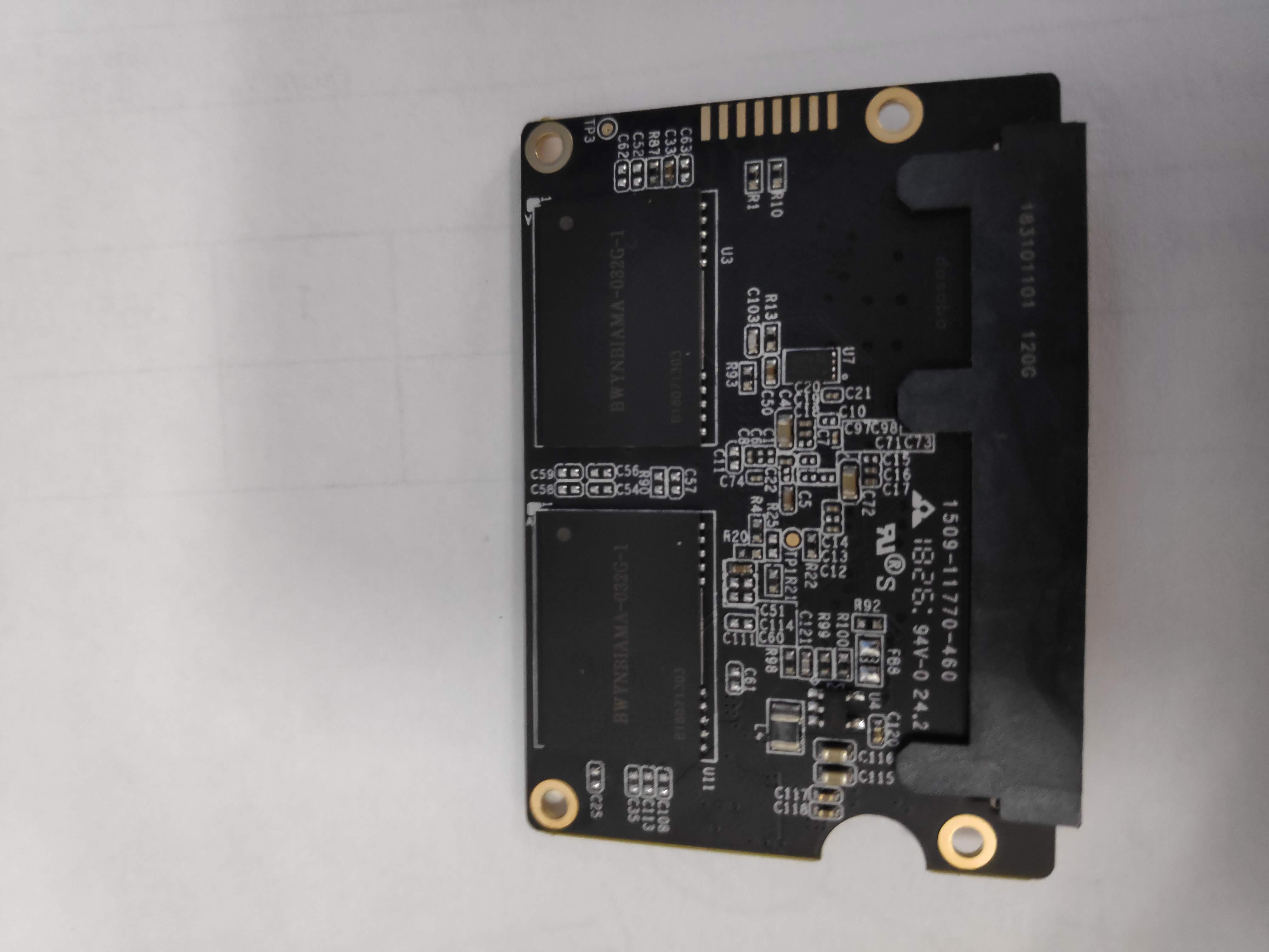

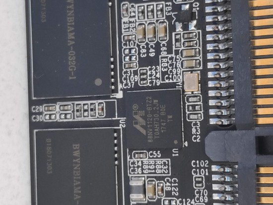

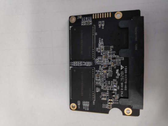

Hi
I have this SSD with this controller that get's full ID with full LBA, but when I try to view the sectors, I can only see sector 0.
I can go to the end of the drive, but it shows always the same as sector 0.
Does anyone have any solution for this? Quote me if you can solve it.
Thank You

My solution works for some cases, but not for all. I can check, but need have drive on table.
