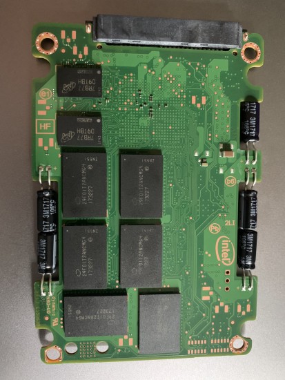

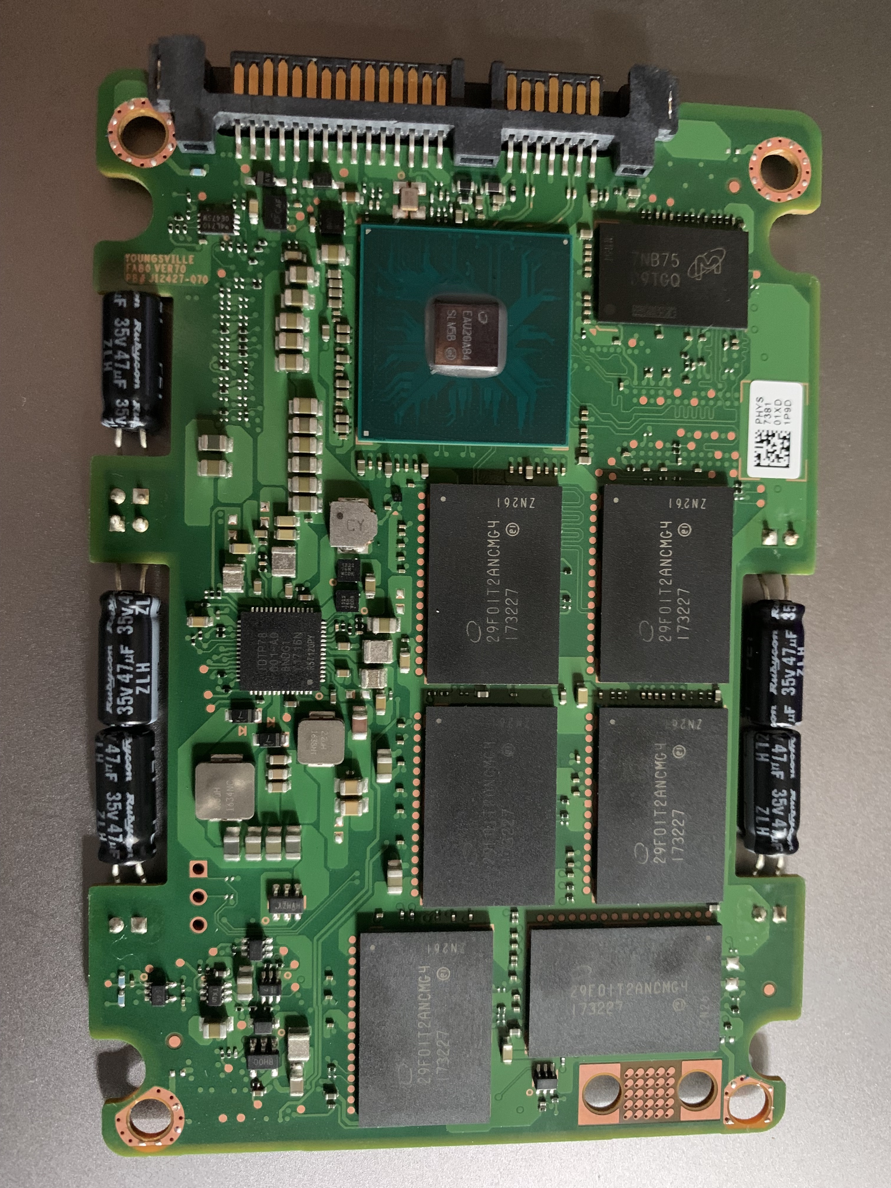

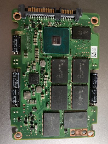

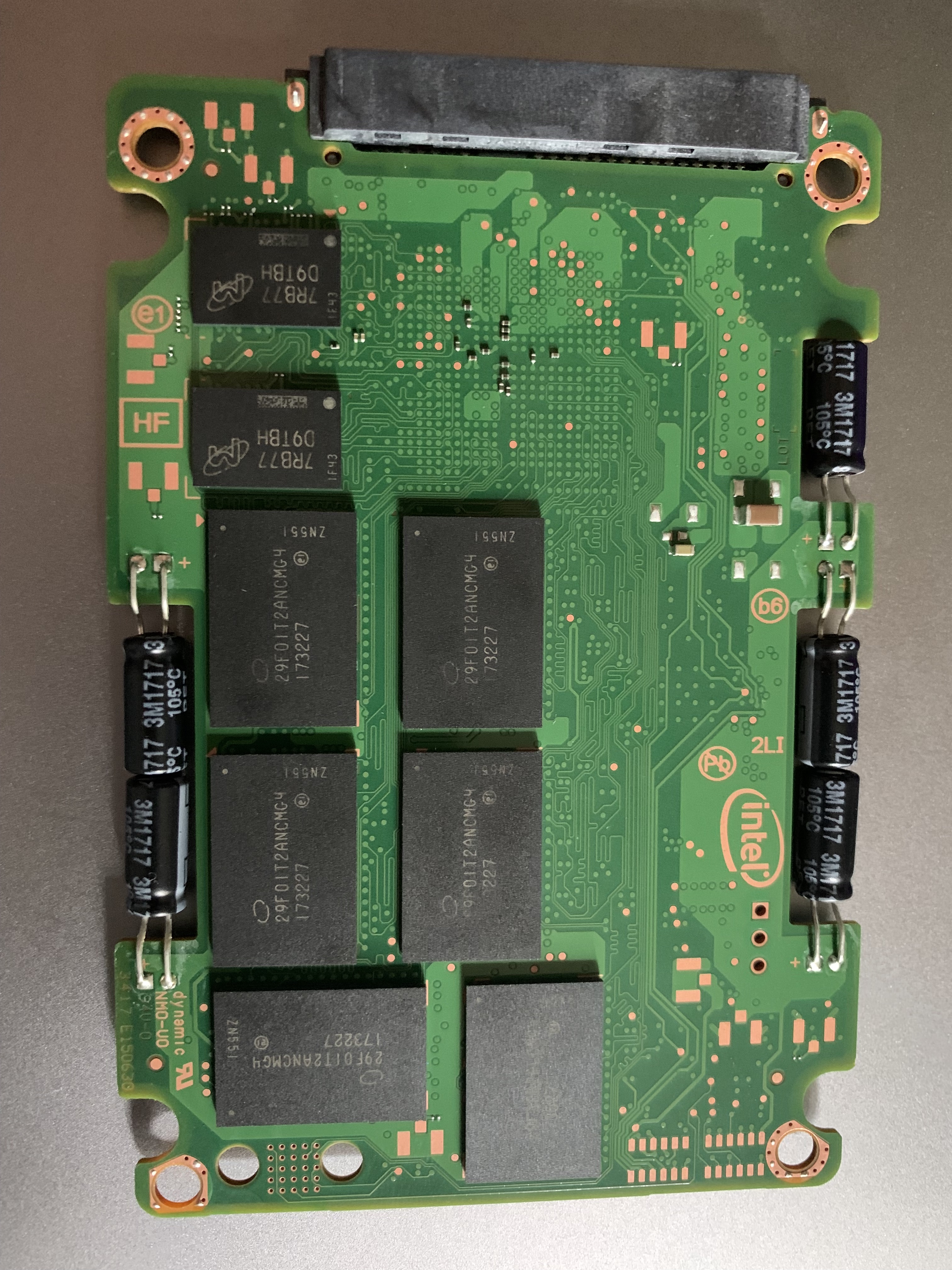

Here are the pictures of the pcb of this drive :
I believe this is more a firmware issue than an hardware issue, so I was wondering if someone new of a way to put these drive into recovery,rom or any specific mode that would allow for a new firmware to be flashed successfully on it (either the HPE one or the intel firmware) or at least remove that disabled logical state. I don't mind losing all the data on the drives.
