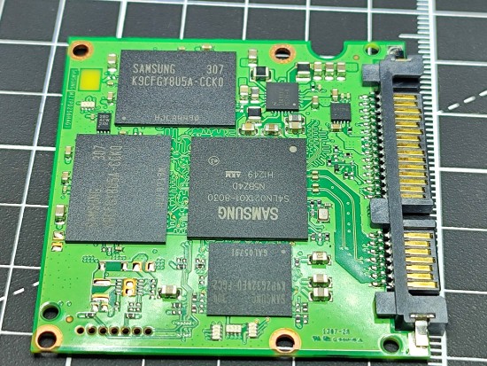

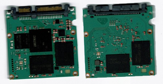

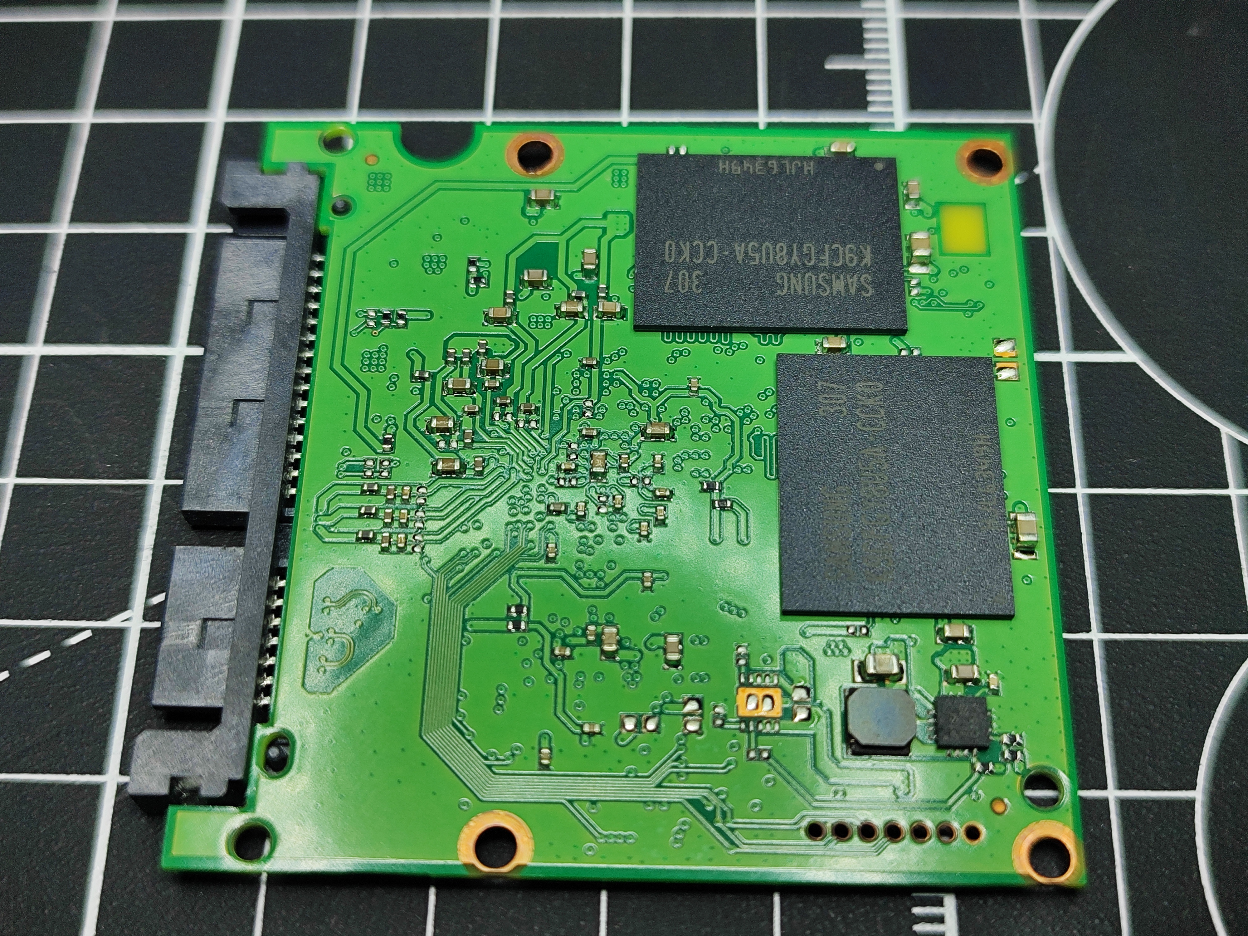

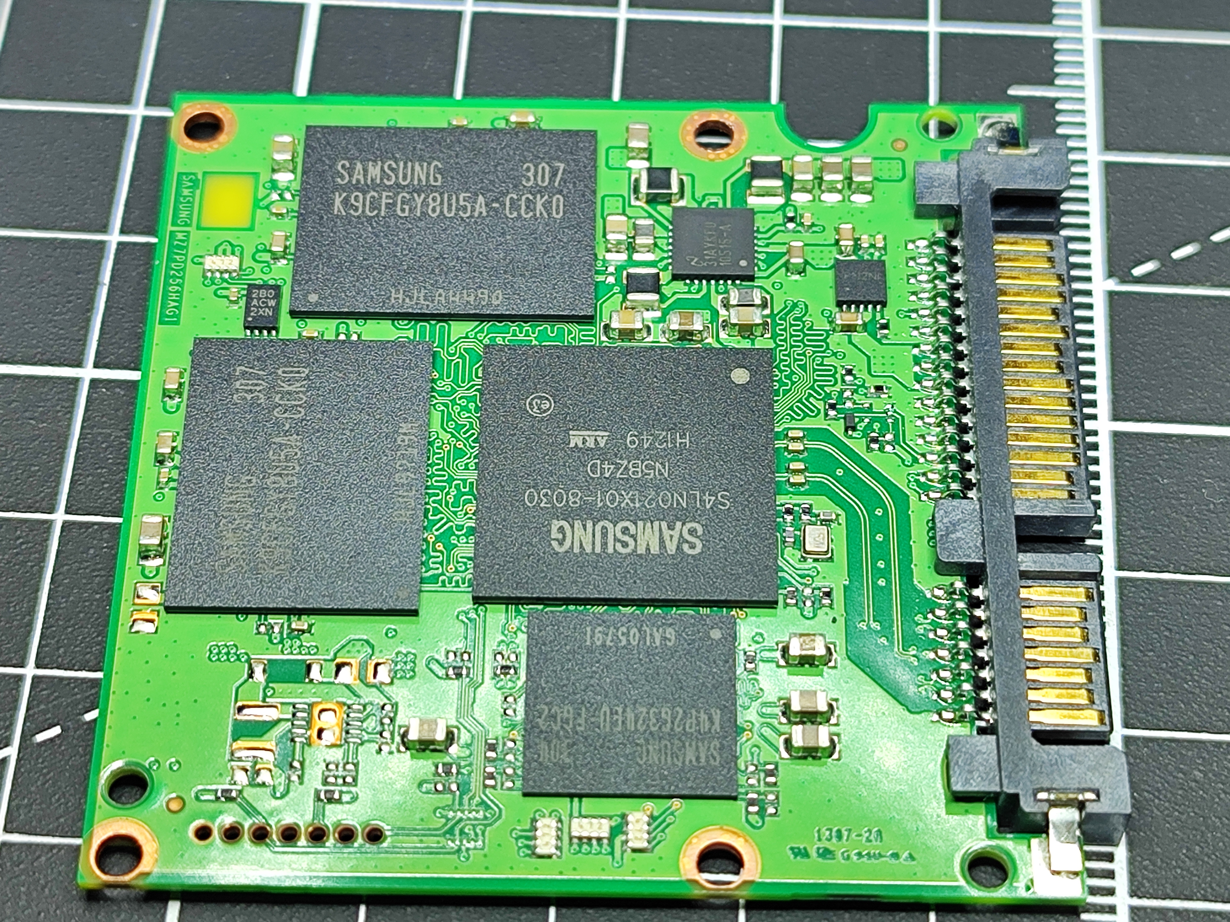

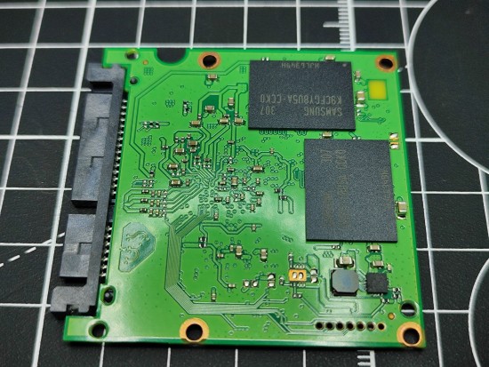

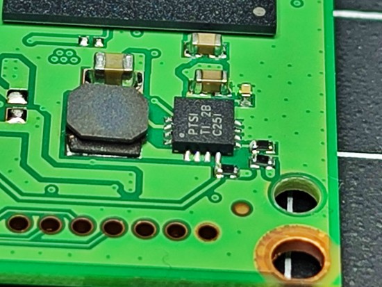

Hi all

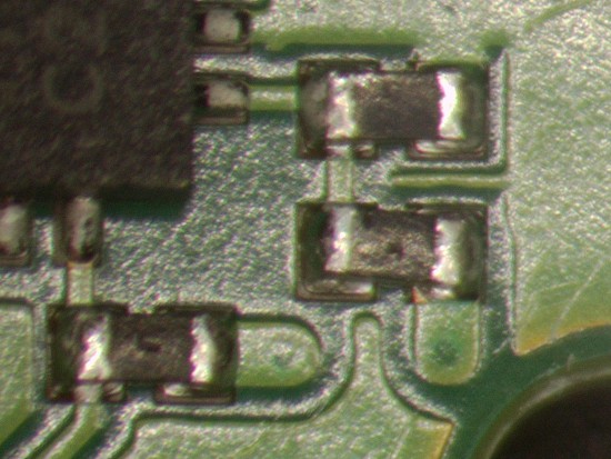

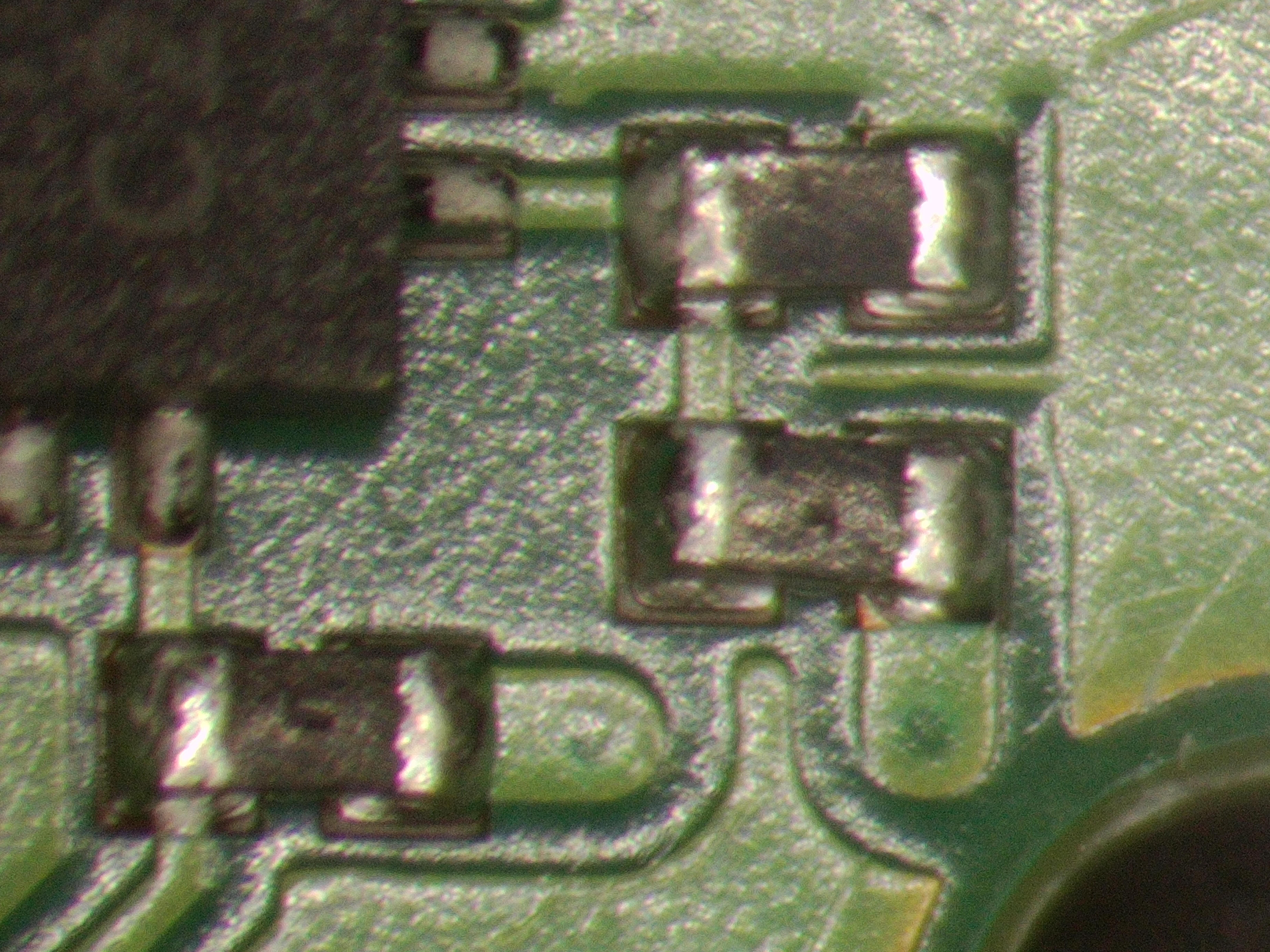

i have a problem with my Samsung 840 EVO 120 GB MZ-7TD120. The drive is not detected by Windows. In BIOS i see this drive but only 1 Gigabyte capacity. I did a basic inspection of the electronics.
and I saw it
Is it possible that this is my problem?

A low capacity like that would indicate a communication issue with the nand or firmware problems.
Check the resistance to ground of the pmic outputs and then check the voltage at the inductors, they don't look to be in the best state but I'd be surprised if they're causing an issue.

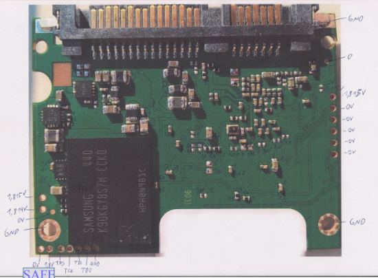

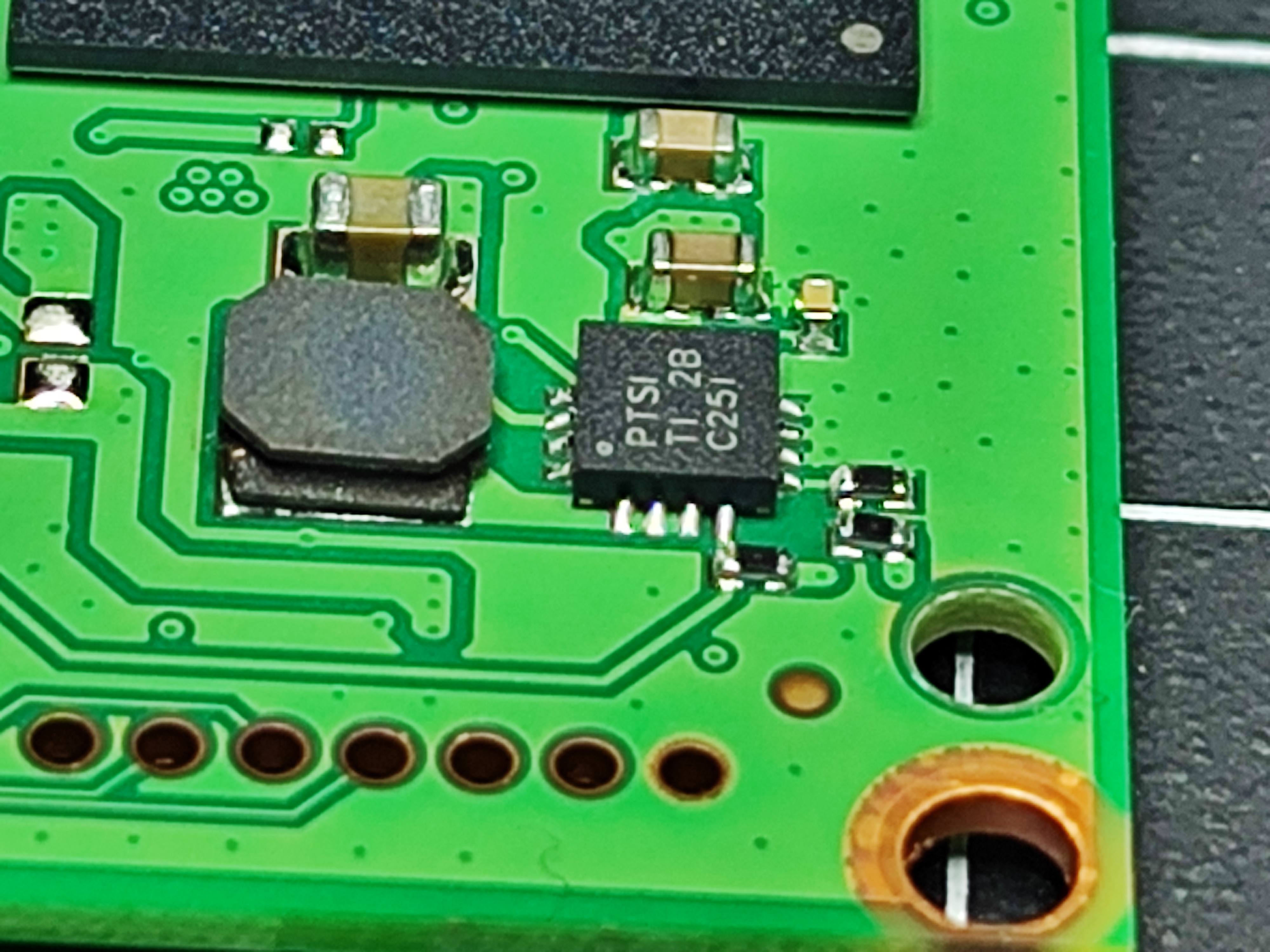

ok what about 7 THT hole on this PCB ?
Is it possible that it's JTAG?
can u help me find pinout ?
on this forum im found
http://www2.futureware.at/~philipp/ssd/ ... Manual.pdf
niestety link prowadzący do pinout nie zyje

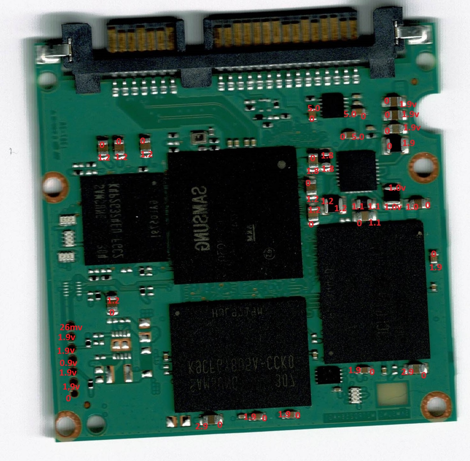

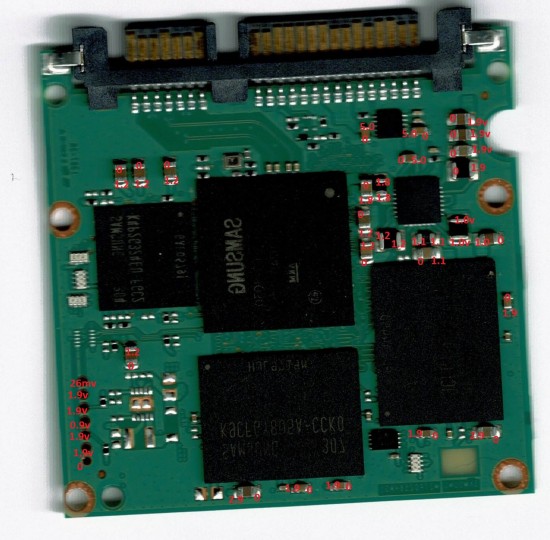

I took measurements, it looks like this
during measurements, they all tend to zero

Posts: 1317
The voltages appear to be ok which would confirm a firmware/nand issue. I can't help with the jtag I'm afraid, this one could be hooked up to pc3000 to recover the data if that's what you need.

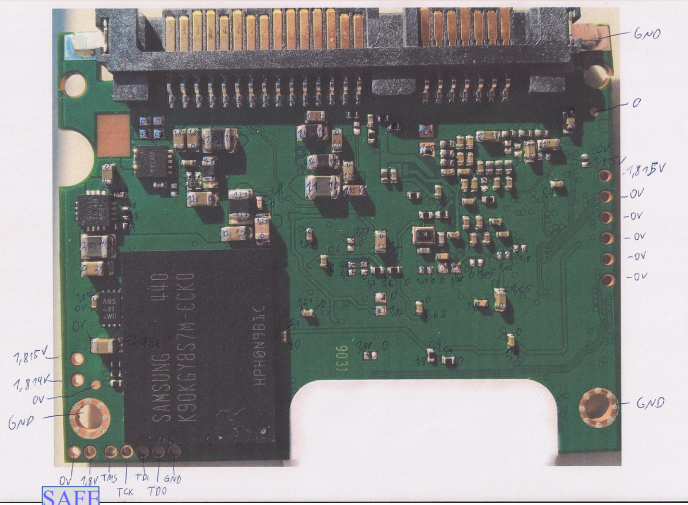

ok im recive my altera USB
now im doing measurments on passible JTAG pins
can enyoune help me find jtag pinout ?
it is passible is the same as this ? (from https://www2.futureware.at/~philipp/ssd ... Manual.pdf)
 Post subject: Re: Samsung 840 EVO 120 GB
PostPosted: October 27th, 2023, 2:23
Posts: 205
Location: Vienna, Austria
Samsung has reused the same pinout on several different models over time. It looks very much like being the same, yes, so I think you can try it.
