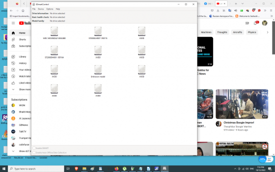

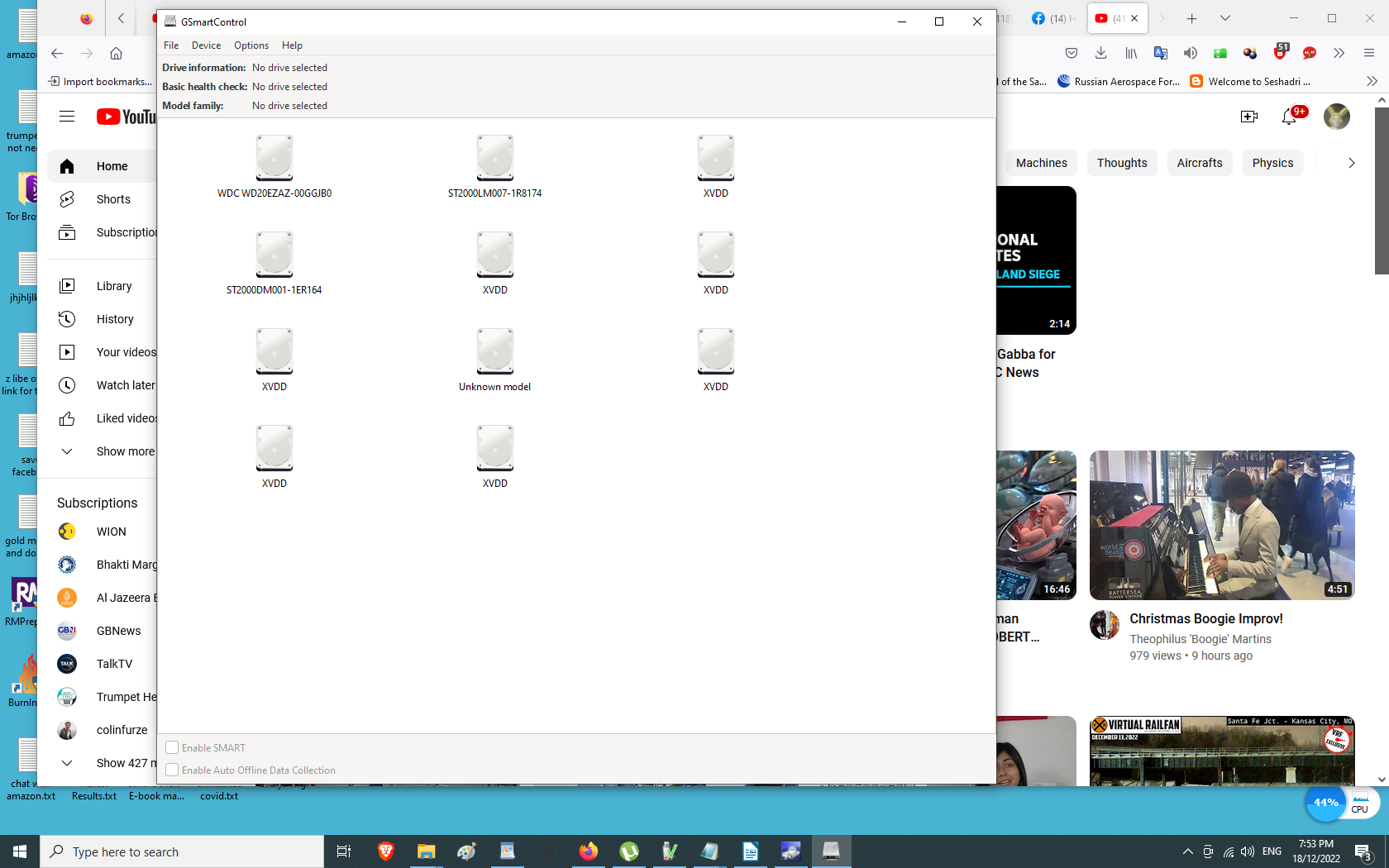

I couldn't see the drive with crystaldisk so I got gsmartcontrol and tried it.
It seems to see a lot of drives. Up to pd3 are my drives: C,D,E and F.
Then it goes to pd9 but all are unmounted except pd6 which is the SSD, labelled drive G: by windows.
It is labelled by gsmart as 'unknown model' and all the others are labelled 'XVDD'
Smart unsupported on G: and all those XVDD's

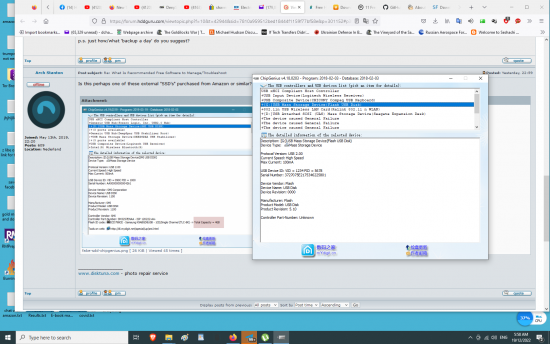

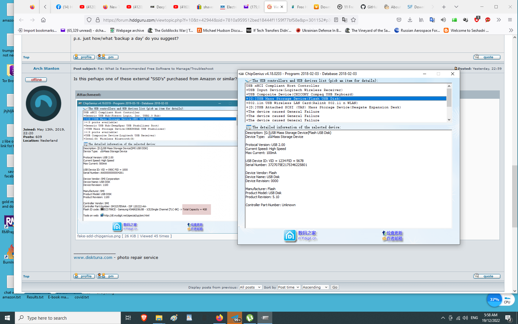

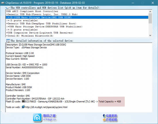

Is this perhaps one of these external "SSD's" purchased from Amazon or similar? If so then it does not support SMART because it is in fact a USB flash drive. Try ChipGenius instead.

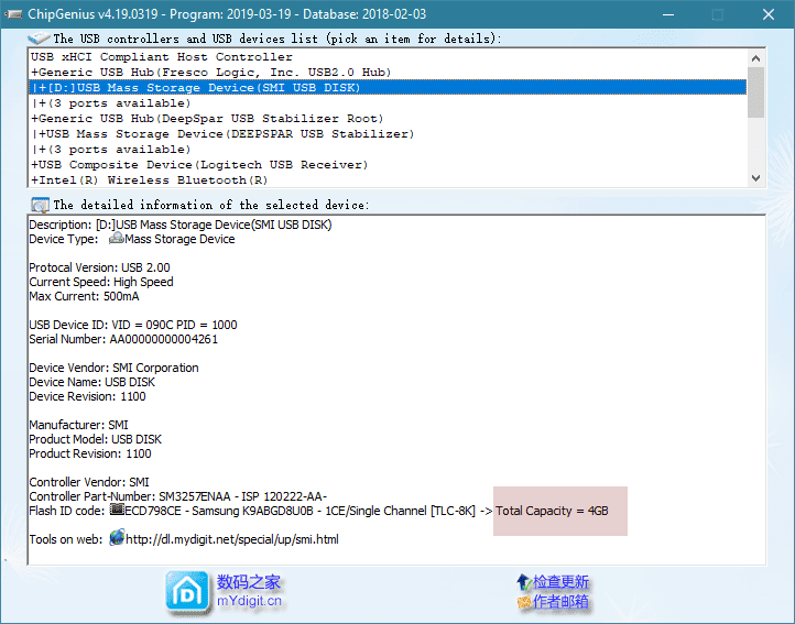

Yep. It is a USB flash of undetermined size.
I'm still looking for software to find out more/do more...
 Post subject: Re: What Is Recommended Free Software to Manage/Troubleshoot
PostPosted: December 18th, 2022, 15:51
Posts: 17333
Silicon Motion SM3257 USB flash controller:
https://www.datasheet-pdf.info/attach/1/4640908223.pdf
