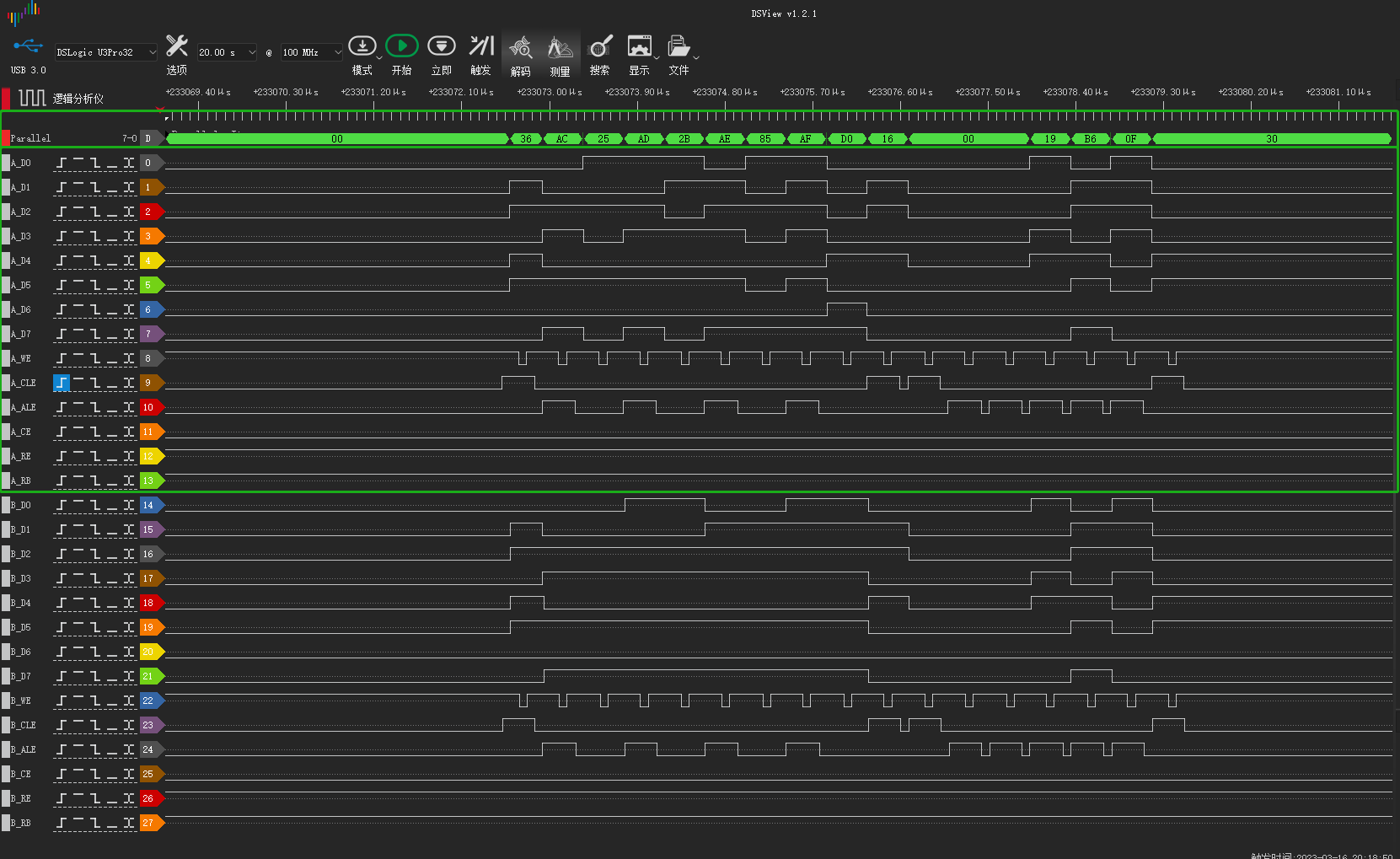

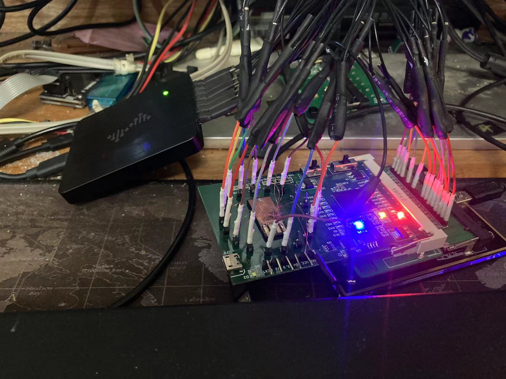

 Post subject: Re: UFD Pinout
PostPosted: March 20th, 2023, 21:46
Joined: July 8th, 2019, 12:27
Posts: 162
Location: 中国大陆浙江省湖州市
The development of the Monolith UFD Pinout solution is progressing smoothly. It is expected that it will be released to end users in half a year. :wink:
http://flash-matrix.com/
