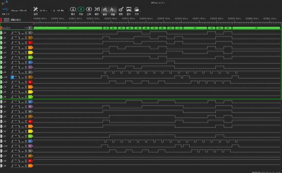

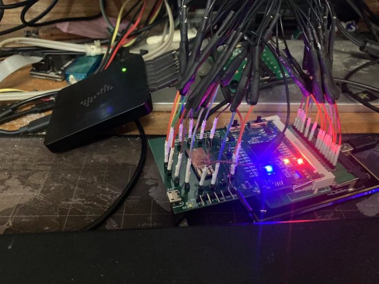

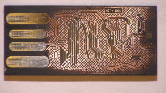

 Post subject: UFD Pinout
PostPosted: March 10th, 2023, 11:24
Joined: July 9th, 2022, 6:50
Posts: 6
Location: Belgium
I'm trying to recover the contains of a defect UFD.
I can't find the correct pinout.
Here is a picture after coating has been removed.
WIN_20230310_11_16_26_Pro.jpg [ 621.17 KiB | Viewed 5742 times ]
Someone ever processed this kind of flash drive?
MIke
 Post subject: Re: UFD Pinout
PostPosted: March 10th, 2023, 14:13
Posts: 4816
isn't it in Arvika's db?
 Post subject: Re: UFD Pinout
PostPosted: March 11th, 2023, 5:17
Joined: July 9th, 2022, 6:50
Posts: 6
Location: Belgium
Yes it is. Pinout 179 but the site says they don't share pinout and sending them the flash drive is not an option.
Mike
 Post subject: Re: UFD Pinout
PostPosted: March 11th, 2023, 6:41
Posts: 355
One option is to buy a logical analyzer. If you create waves i can help decoding them and prepare the pinout. Other option is to give the UFD back to client and send to someone who has the pinout or can discover it.
I don't think that there's anyone who shares/ sells pinouts except me :mrgreen: Sadly i don't have this one.
odzyskiwanie danych
 Post subject: Re: UFD Pinout
PostPosted: March 11th, 2023, 9:30
Joined: July 9th, 2022, 6:50
Posts: 6
Location: Belgium
melvin wrote:
One option is to buy a logical analyzer. If you create waves i can help decoding them and prepare the pinout. Other option is to give the UFD back to client and send to someone who has the pinout or can discover it.
I don't think that there's anyone who shares/ sells pinouts except me :mrgreen: Sadly i don't have this one.
We have a logical analyzer.
We were planning to use the autodetect feature of PC3000 to try and find the pinout but any help would be appreciated.
Have a nice day
Mike
 Post subject: Re: UFD Pinout
PostPosted: March 11th, 2023, 16:36
Posts: 355
Don't experiment on clients device. I doubt that autodetect will help you. If it works at all.
Solder all unique pins, create waveform and analyze or send it. Or, best option, get the same device for pinout discovery.
odzyskiwanie danych
 Post subject: Re: UFD Pinout
PostPosted: March 11th, 2023, 16:37
Posts: 922
It is not exactly v179, but yes, very similar. Now pinout is the simplest part of flash recovery. As you can see at UFD v179 description, there is high probablility that flash use FC1178/FC1179 controller which is very complicated to recover. Next challenge will be problem with correct reading, bad bits, cut pages, assembler, and rebuilding file system. Here you can find some sample of solution: http://flash-extractor.com/library/FC/F ... 98_b3__1x1 Last time I have 1800 bad bits to cut from FC case...
PS. I share more than 500 solutions models for FE for free already, VNR resources created by me - ECC and XOR is share for free (~50% of all avaiable), read retry algorithms implemented at FE, monolith database is for free to help everyone (for example not waste time on LDPC cases since we not find solution). I can't share everything for free, I need pay taxes and sometimes I must eat ;)
 Post subject: Re: UFD Pinout
PostPosted: March 15th, 2023, 15:40
Joined: March 30th, 2016, 15:52
Posts: 27
Location: Washington, USA
arvika wrote:
I need pay taxes and sometimes I must eat ;)
Arvika only needs a 'nibble'
....sorry, had to jump on that nerdy joke chance
 Post subject: Re: UFD Pinout
PostPosted: March 20th, 2023, 21:46
Joined: July 8th, 2019, 12:27
Posts: 162
Location: 中国大陆浙江省湖州市
The development of the Monolith UFD Pinout solution is progressing smoothly. It is expected that it will be released to end users in half a year. :wink:
2.png [ 49.09 KiB | Viewed 5105 times ]
1.jpg [ 239.57 KiB | Viewed 5105 times ]
http://flash-matrix.com/
Users browsing this forum: No registered users and 131 guests
