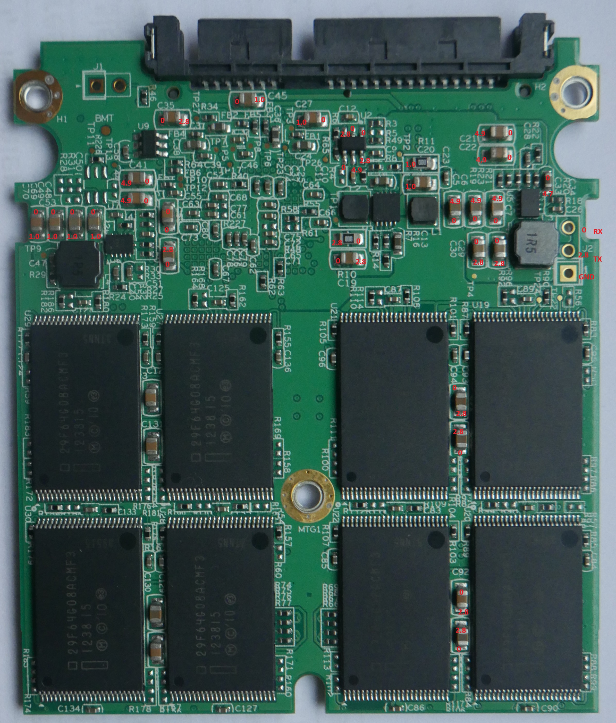

i have a ADATA S510 120 GB
Windows and Linux systems do not detect this disk, nor the BIOS
I made preliminary measurements, they are as follows
Can i try comunicate with this SSD via serial (3.3v) ? for example, putty program ?
what will be the correct bitrate 11520 ?
I want to recover my data

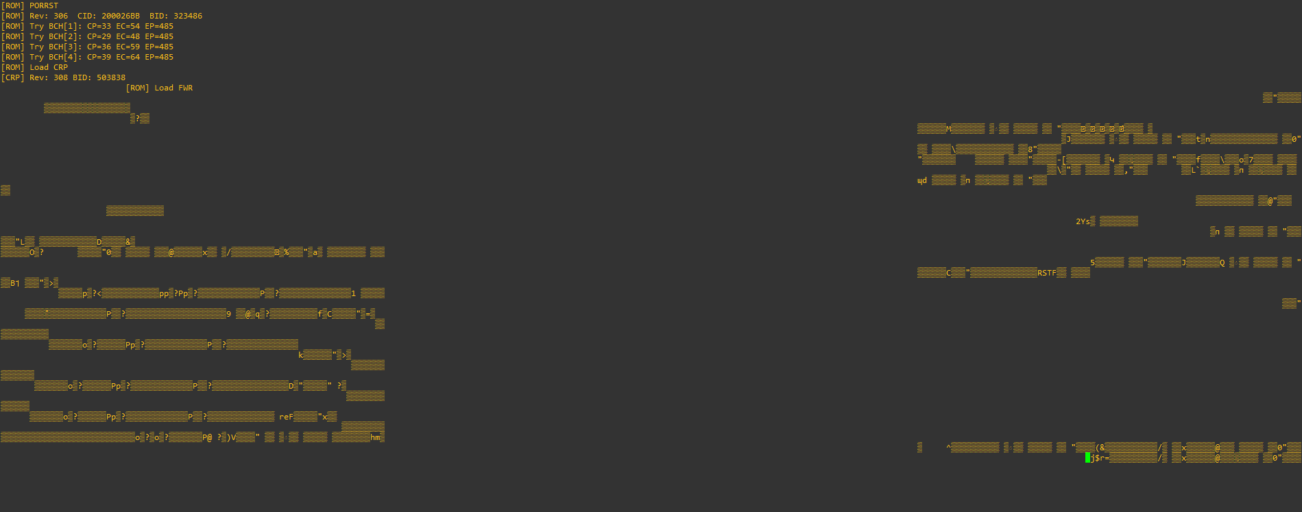

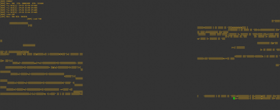

on USB-UART FTDI FT232RL Waveshare 6170 and 5v
putty 11520
i see this
wrong voltage or bitrate ?

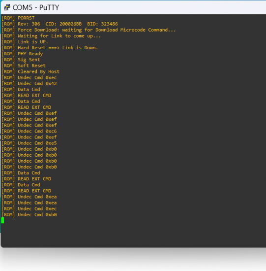

ok so im read more about this
I learned on this forum that Sandforce SF-2281 is hard to read data
now i think is my output form pytty is normal
can i comunicate with this SSD via putty ? for diagnosis?
what about the to THT hole on top left ? can i change dsik running method?
what about decryption keys in case of firmware updates?

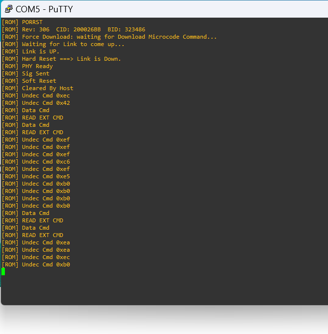

ok, I shorted the two THT hole on top of PCB
can i diagnose this SSD in this state ?
