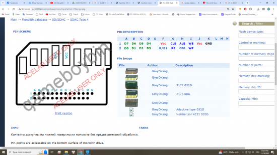

 Post subject: Sandisk 32gb 48mb/s Can somebody share the Pinout
PostPosted: November 19th, 2023, 21:50
Posts: 261
Location: Vietnam
Hi everyone

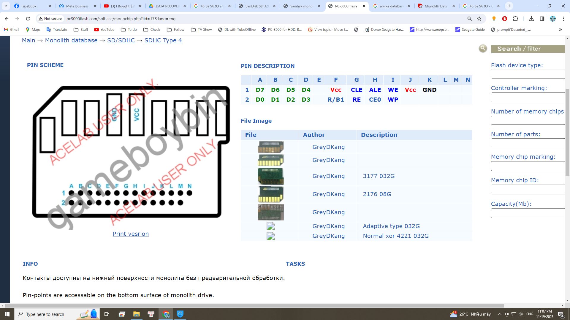

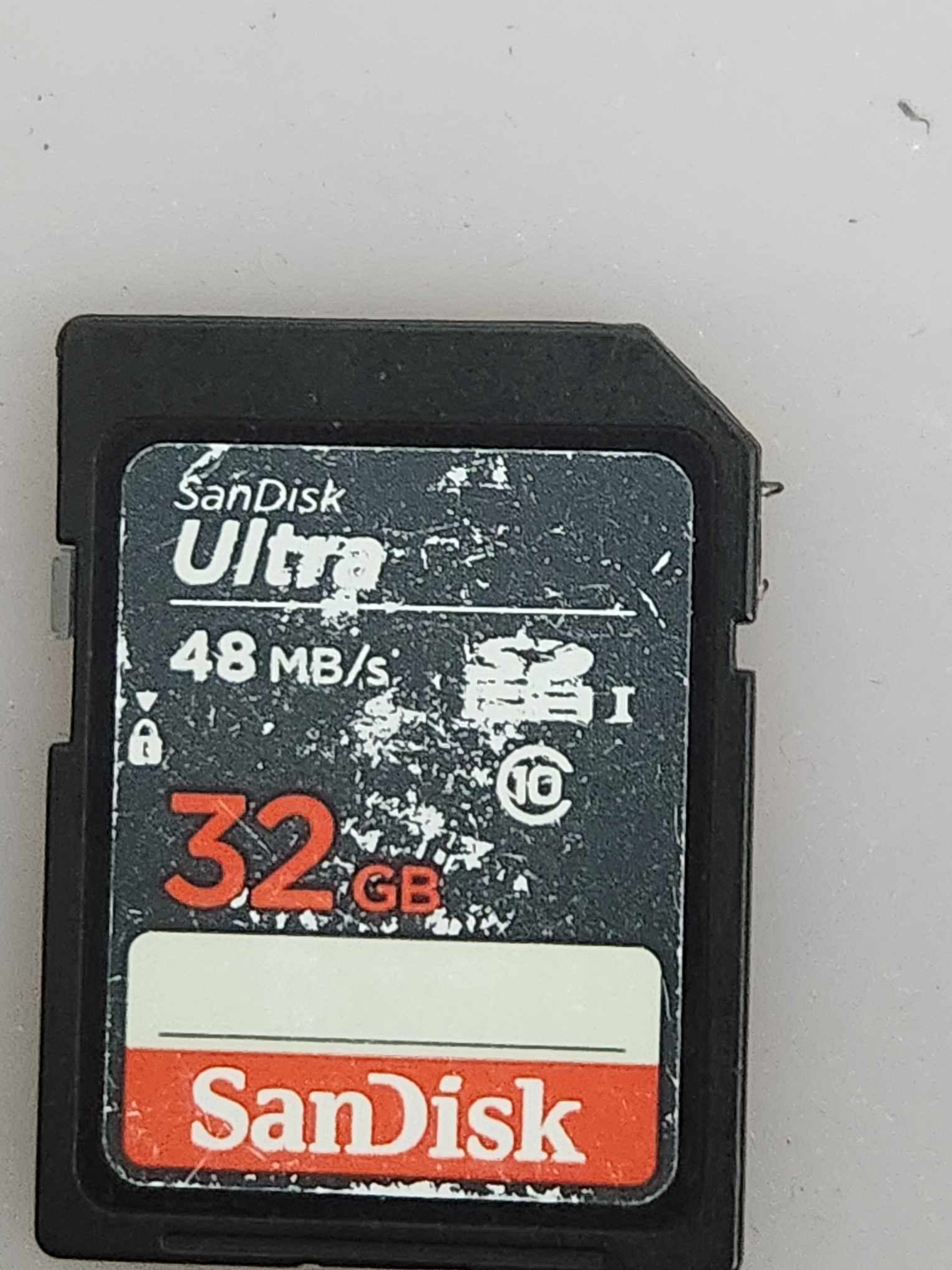

So i am having this Sandisk 32gb 48mb/s SD card
I used Type 4 Pinout from Acelabs Solbase
Got the card to ID but i think it did not id correctly
It ID: 45 3e 96 93 (64gb)
Which is a 64gb SD
Can anyone check if i got the correct pinout???
Or can someone provide a pinout for me
Many Thanks!!!

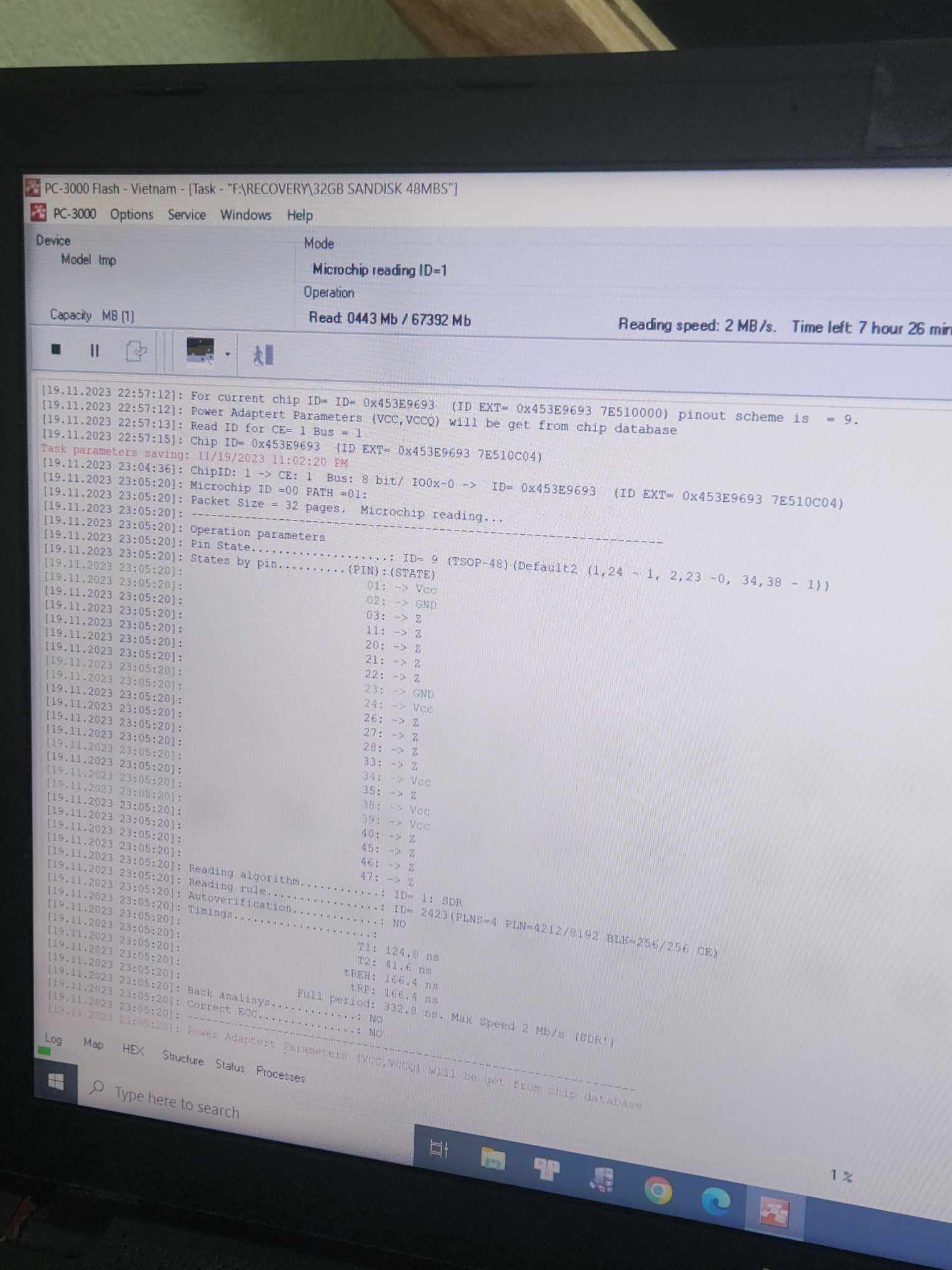

Here is the ID of PC3000 Flash
File comment: ID
 Post subject: Re: Sandisk 32gb 48mb/s Can somebody share the Pinout
PostPosted: November 20th, 2023, 8:18
Joined: February 18th, 2020, 9:35
Posts: 77
Location: Ukraina
Start direct reading mode and see what is in the second half of the dump.

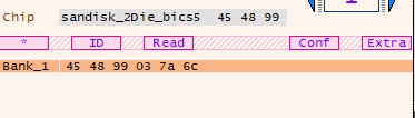

PostPosted: November 20th, 2023, 10:37
Joined: July 8th, 2019, 12:27
Posts: 162
Location: 中国大陆浙江省湖州市
Do not doubt, the pinout and chip configuration are entirely accurate. Genuine SanDisk USB drives and SD cards may also undergo production methods that reduce capacity, just like refurbished products, although this is rare.
The chip is labeled as 128GB, but the actual capacity is 256GB
