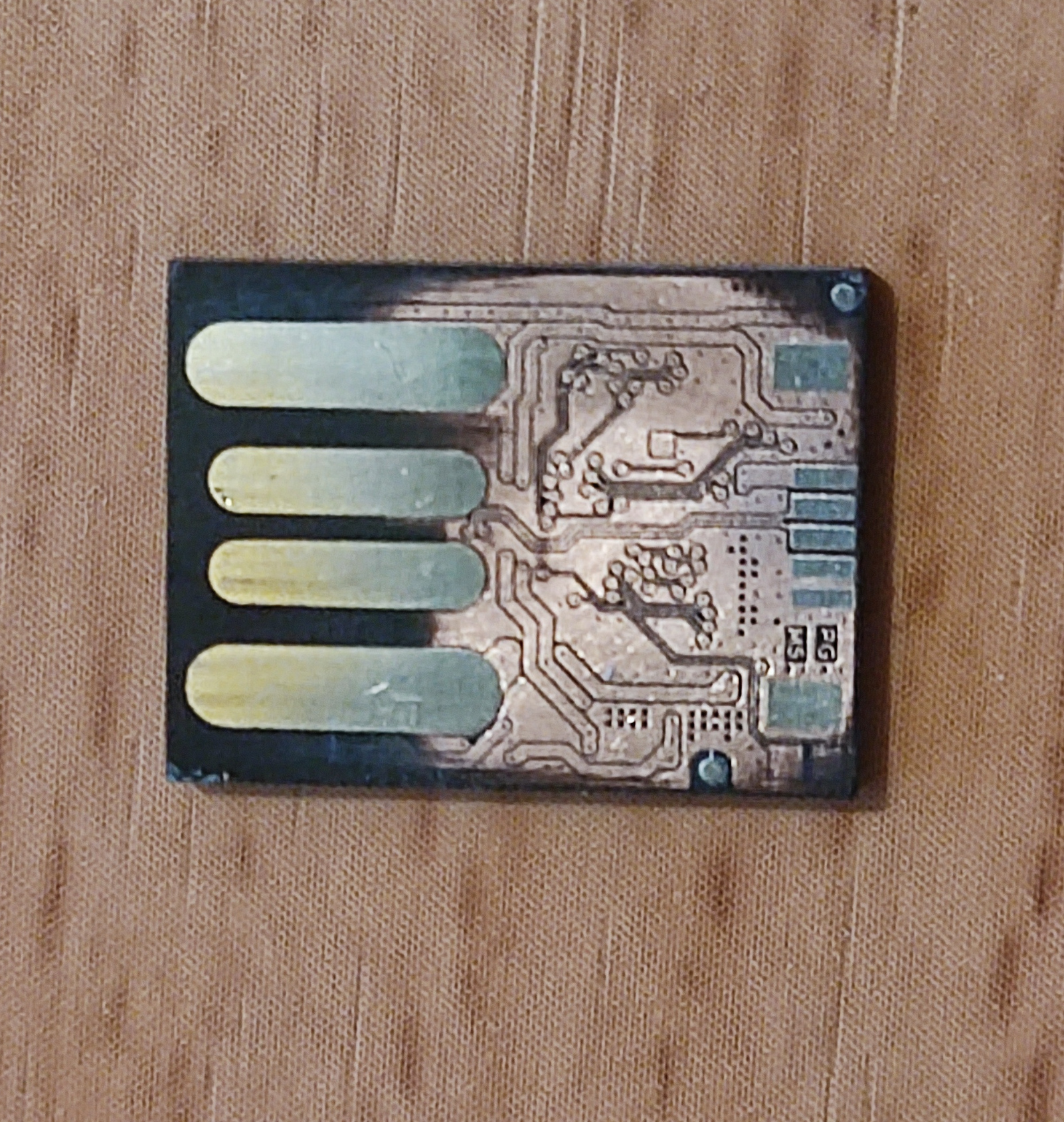

Hello
Does anyone have the pinout for this flash monolith?

The most similar one I could find: http://www.greydcode.com/monolith.html#monolit_ufd # 73
It has the same "PG" "MS" codes on it, and the routing style is the same.

But it's not USB-A pinout

Yeah, not sure it's the same...

It is completly different monoliths.
