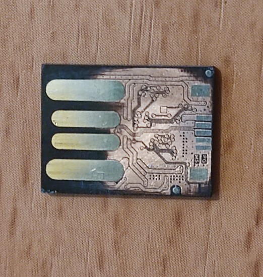

 Post subject: Monolith Pinout
PostPosted: November 12th, 2023, 16:25
Joined: July 12th, 2010, 4:38
Posts: 1455
Hello
Does anyone have the pinout for this flash monolith?
IMG_20231109_221946.jpg [ 1.22 MiB | Viewed 6492 times ]
ACELab partner
 Post subject: Re: Monolith Pinout
PostPosted: November 13th, 2023, 11:32
Posts: 205
Location: Vienna, Austria
The most similar one I could find: http://www.greydcode.com/monolith.html#monolit_ufd # 73
It has the same "PG" "MS" codes on it, and the routing style is the same.
 Post subject: Re: Monolith Pinout
PostPosted: November 13th, 2023, 11:37
Posts: 205
Location: Vienna, Austria
But it's not USB-A pinout
 Post subject: Re: Monolith Pinout
PostPosted: November 14th, 2023, 3:59
Joined: July 12th, 2010, 4:38
Posts: 1455
Yeah, not sure it's the same...
Thanks Sourcerer!
ACELab partner
 Post subject: Re: Monolith Pinout
PostPosted: November 14th, 2023, 5:36
Posts: 922
It is completly different monoliths.
Users browsing this forum: No registered users and 123 guests
