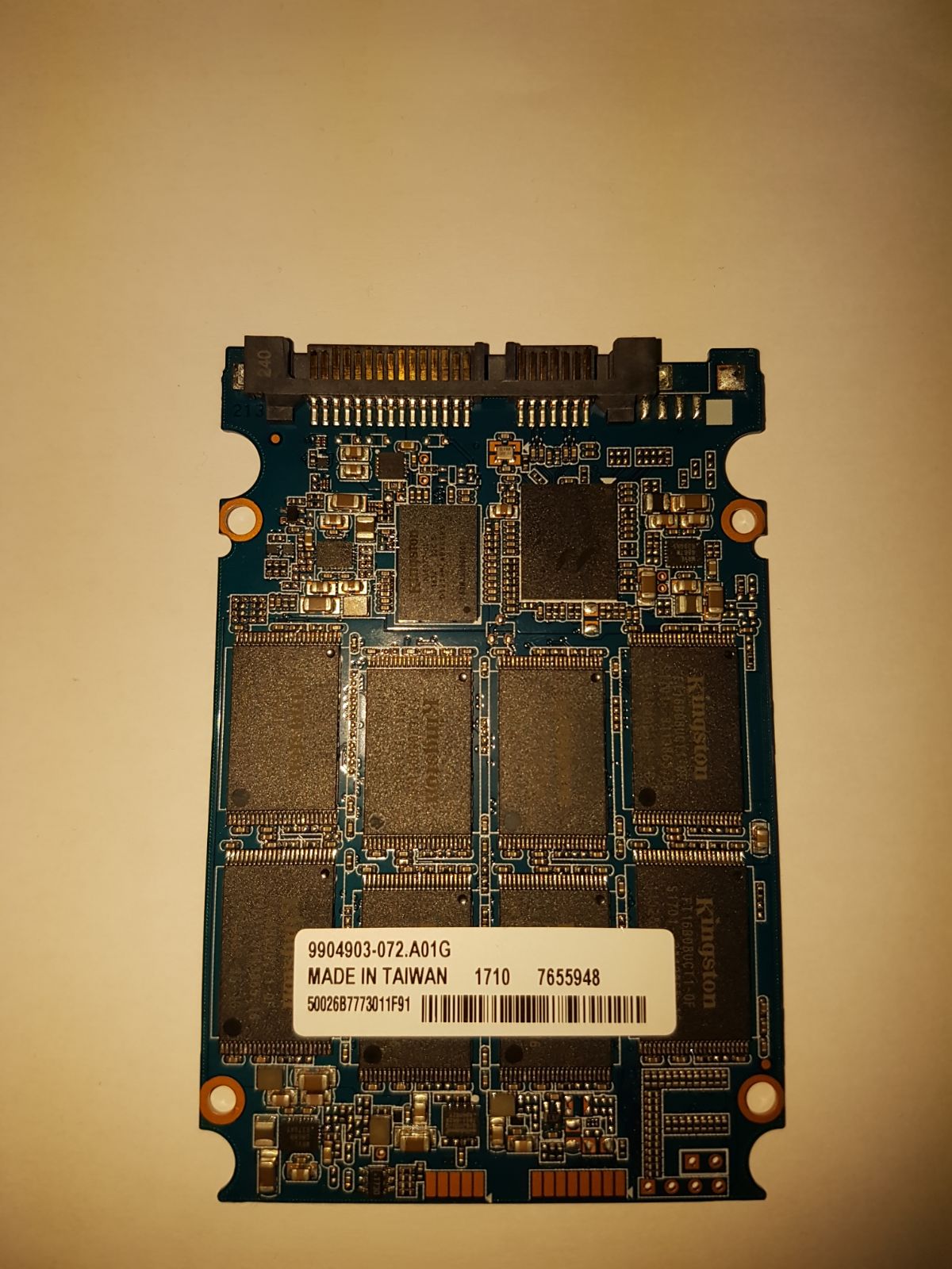

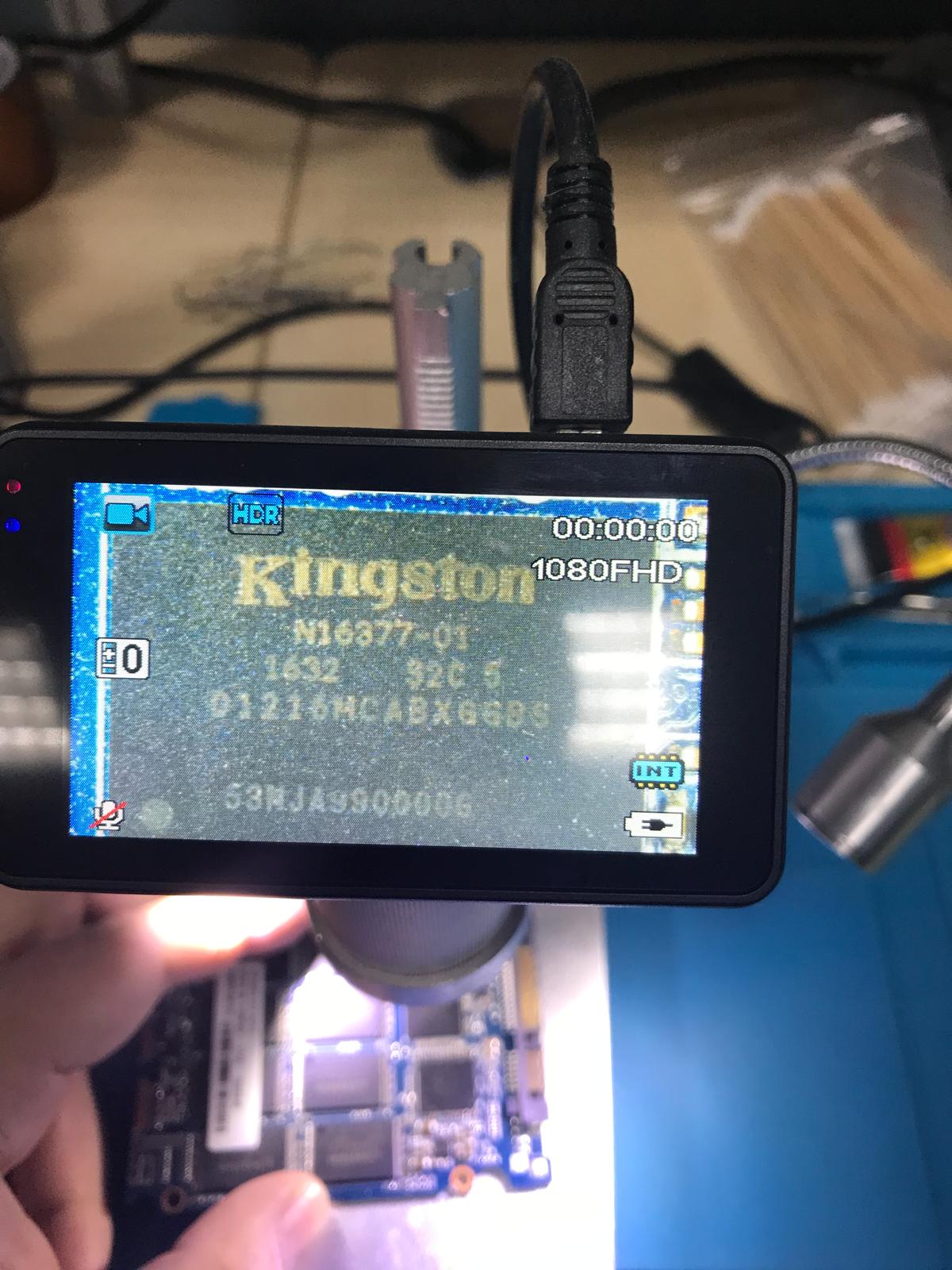

Really is crazy, tru any but can resolved.
some experience with this?

Kingston SSD's are rubbish. out of around 120 I've had at least 5 that have died while installing OS.
You don't say much but I'm guessing you want DR. The Marvell controller hasn't got much support for Chip-off at least. What's the issue with drive? What have you tried? does it power up?
you might want to upload pic of other side as well.

Problem:
- No acces to data
- No run

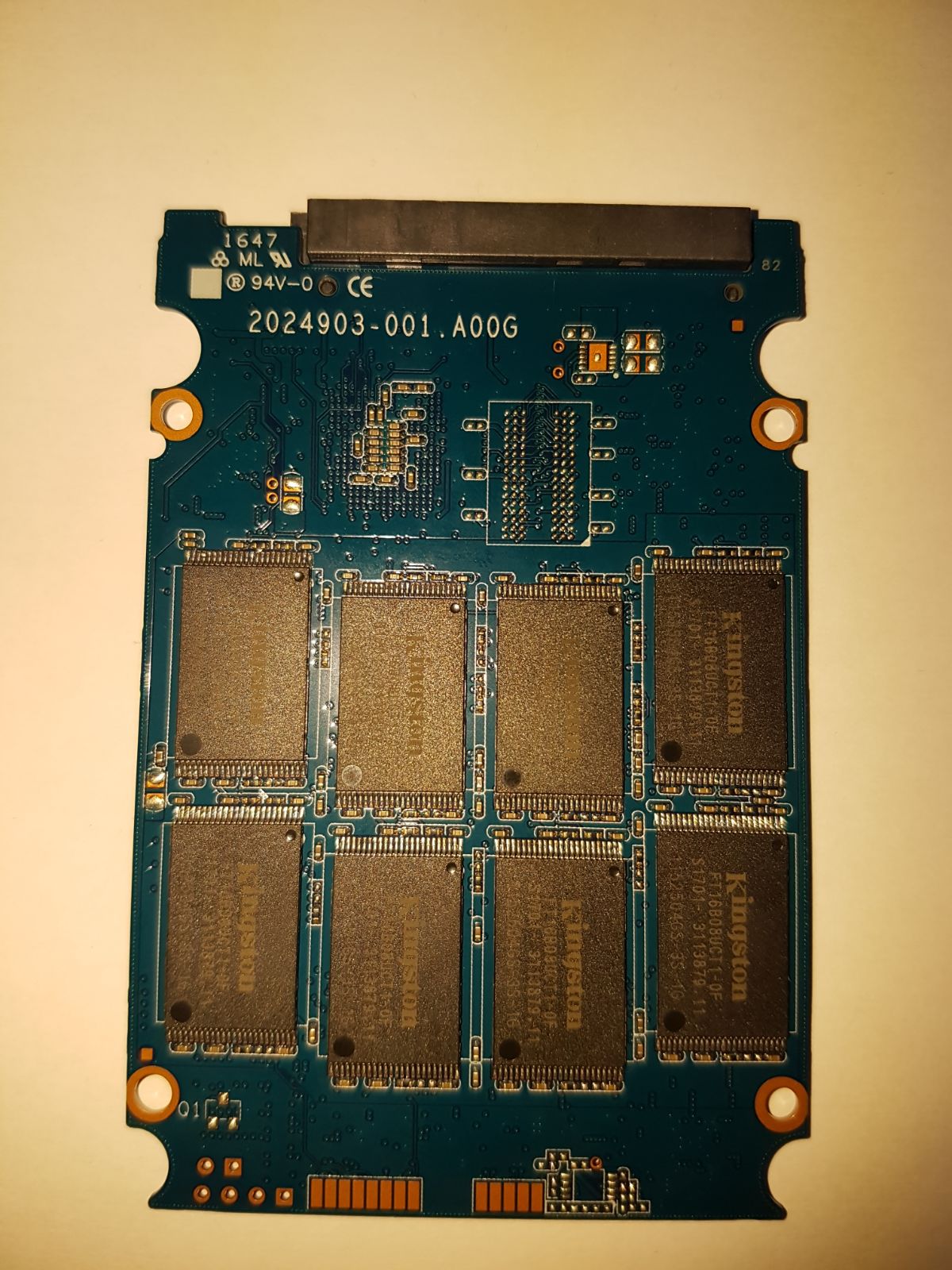

Another Pic:

I would have tried to help with test points, but the OP's photos were unusable.
(Why do people think that the markings on chips are unimportant? What information can one discern from a black rectangle?)

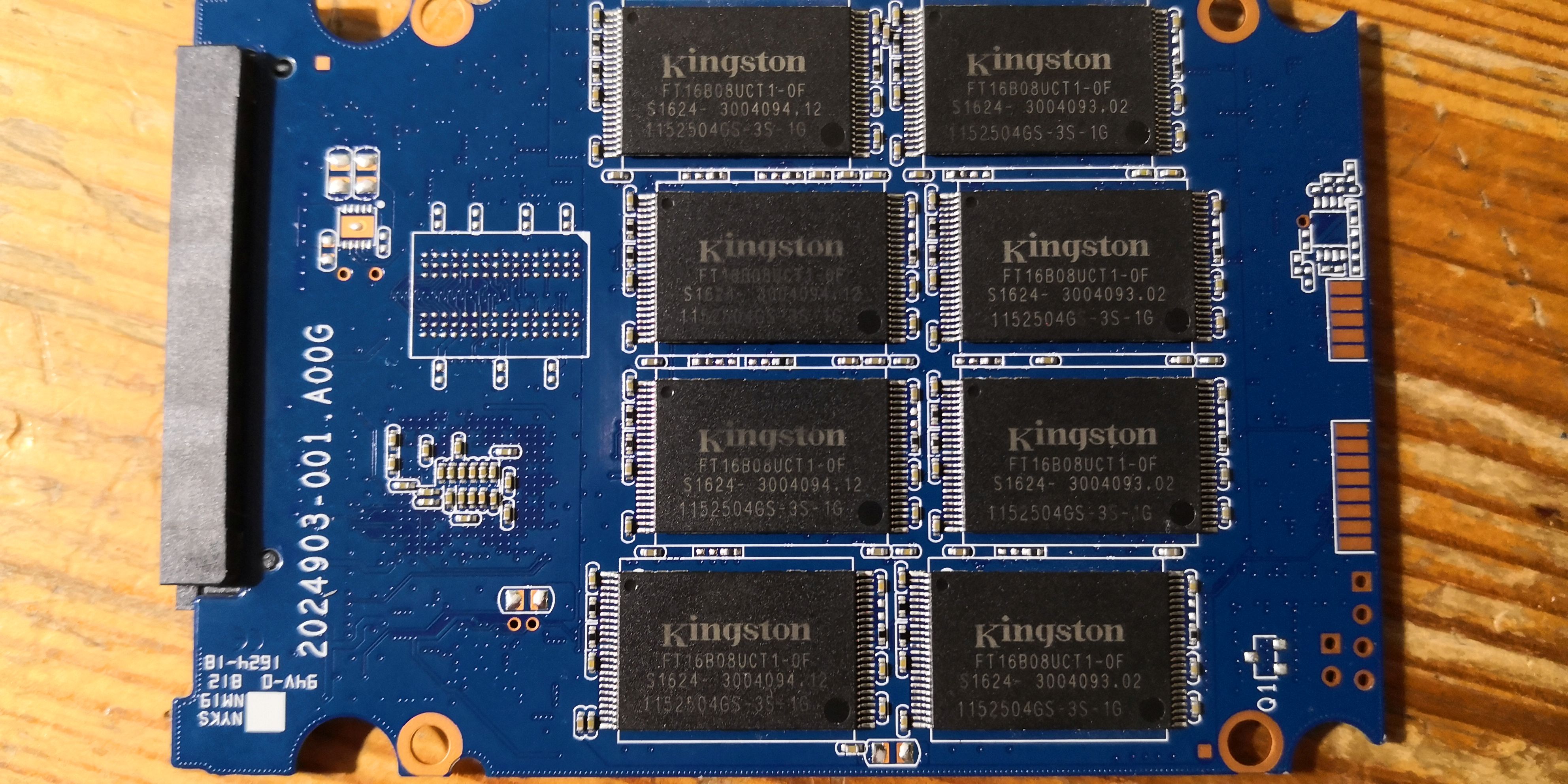

PostPosted: December 19th, 2023, 17:19
Posts: 331

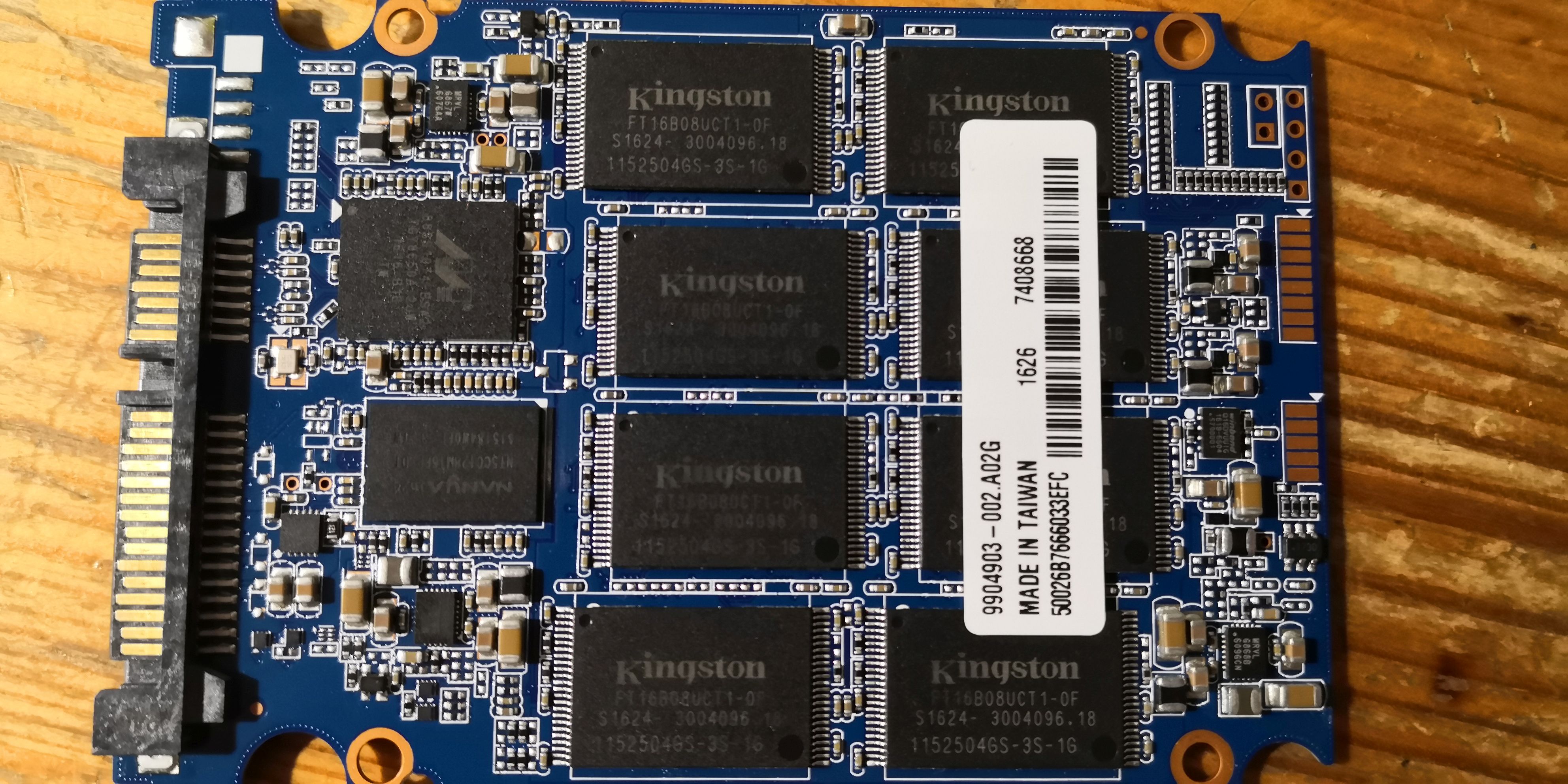

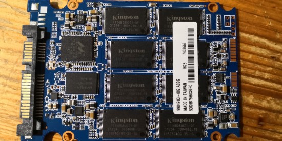

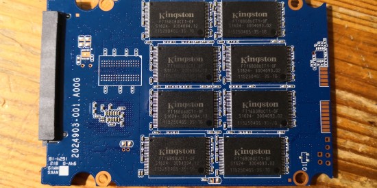

Hello!
Could someone help to find safe mode and terminal contacts for this kind of board?
Thank you!

 Post subject: Re: Kingston SUV400S37/240G UV400
PostPosted: December 19th, 2023, 18:01
Posts: 17256
Try shorting the NAND Ready/Busy* pin to ground. It works for some SanDisk SSDs ...
PostPosted: December 20th, 2023, 7:53
Posts: 331
Thank you Frank, BUT...because the controller chip is Marvel 88SS1074, it has TWO shorting pont for safe mode.
For recovery also i need terminal soldering points.
For reference:
https://blog.acelab.eu.com/pc-3000-ssd-sandisk-ultra-ii-and-wd-blue-marvell-cpu.html
