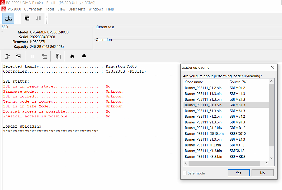

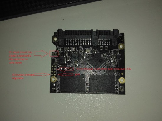

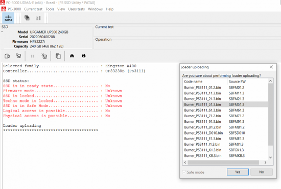

Hello to every one !!!!!

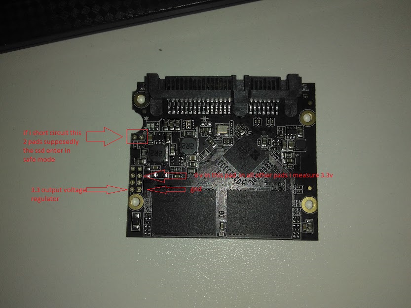

In my job, We are receiving all months chinese ssd based in the controller ys9082hp, until I know this controller is based in the ps3111, and I am trying all loaders from the pc3k without success, and for more than I put the drive in safe mode the pc3k in the log tells me is not, I clarify that I think it is in safe mode because the id that the ssd gives me is completely different from when it does not have the short circuit. One thing who call my attention is the model of the controller show me in safe mode is different from the package, in safe mode in model appears ys9086bb-1 and in the package appears ys9082hp.
Anyone has some experience with this model, for moments I doubt if the drive is really in safe mode I try all sort of combinations to short circuit between the pads and only one give me a different id.
I forgot all voltages are good
I am very grateful to anyone who read my post and even more if comments
thanks very much and my best regards

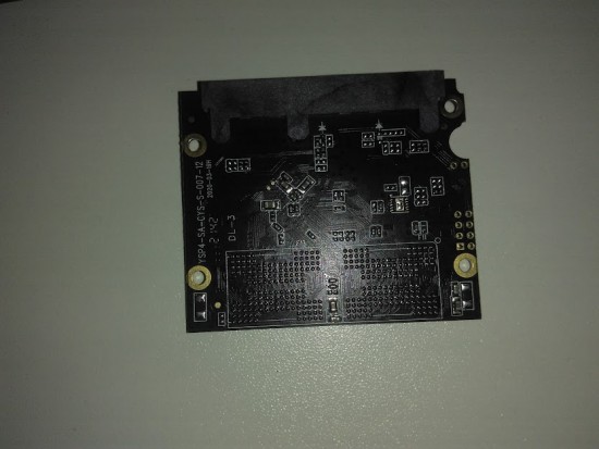

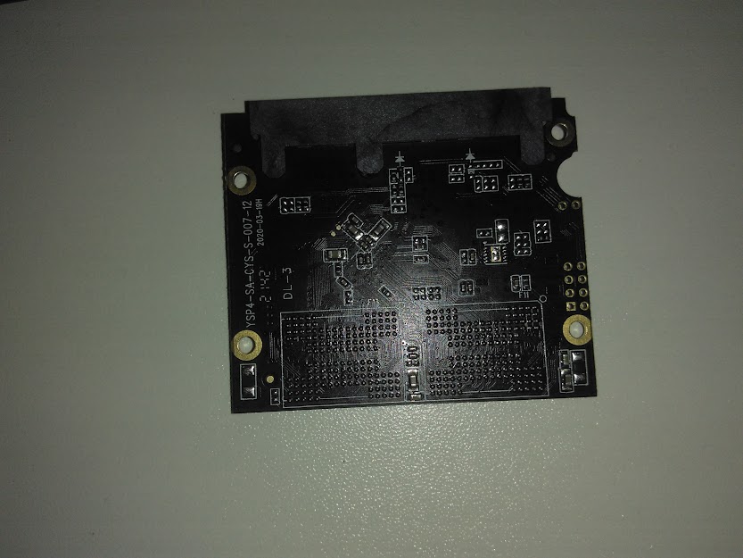

 Post subject: Re: ys9082hp (ps3111) i cant load any loaders
PostPosted: February 10th, 2023, 13:01
Posts: 17256
I can't help you, but I notice that the PCB is a reference design, "YSP4-SA-CYS-S-007-12". This same PCB is used for both the YS9082HP and YS9082HC controllers.
PostPosted: February 11th, 2023, 3:34
Posts: 922
Design of PCB more likely is similar to SSD based on SM22xx families than PS3111.
PostPosted: February 11th, 2023, 14:33
Posts: 17256
In ROM mode this controller identifies as a SiliconGo SG9081CC. Yeestor was the result of a merger between Auspitek and SiliconGo.
I notice that SiliconGo has an SG9081 and SG9081XT:
https://web.archive.org/web/20180211154502/silicongo.com/en/products.php%3Fproid=1
... and "Silicon Go" and "Silicon Motion" seem somehow related, at least semantically ...
This thread points to some reasources:
https://www.usbdev.ru/f/index.php?topic=10146.0
https://disk.yandex.ru/d/Yqjf-qUb1IHKXA
https://cloud.mail.ru/public/Wsa2/akoW1dbNB
PostPosted: February 12th, 2023, 8:01
Joined: July 8th, 2019, 12:27
Posts: 162
Location: 中国大陆浙江省湖州市
ys9082 is a brand new SSD controller with a new independent design, not a renamed version of PS3111, 2258xt, 2259xt or other controllers.

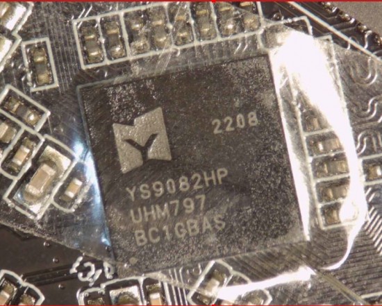

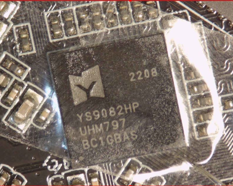

i have a similar case with this ssd , ys9082hp, i can't read it yet
